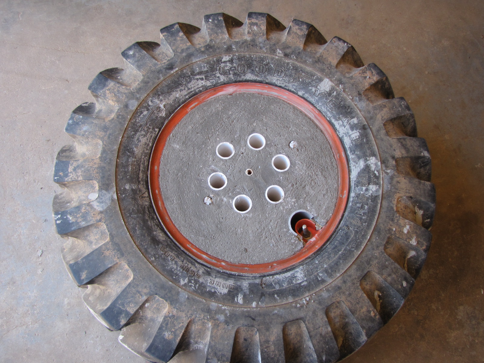

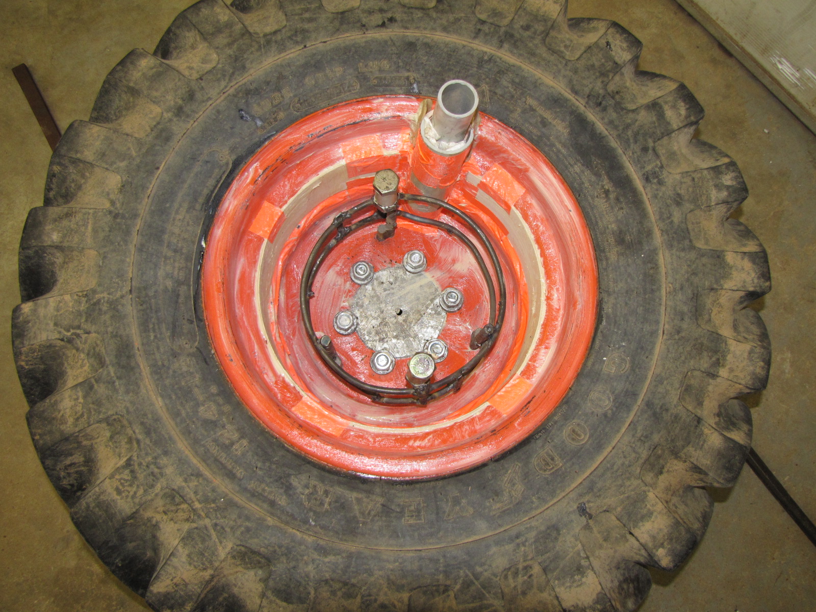

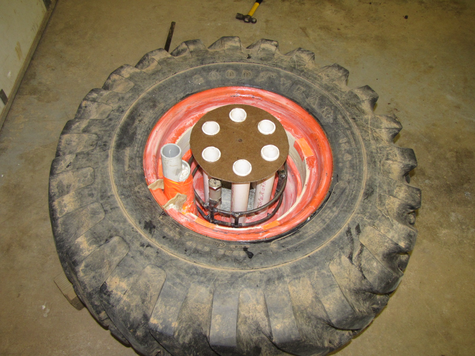

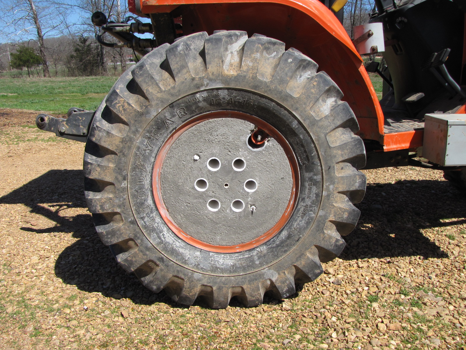

A while back a guy was trying to put some he made into his wheels, never did find out if he got them in. After seeing that post I though I would give it a shot. Here are some pictures and tomorrow night I well have some pictures of how I did it.

Looks great, how much weight have you added?
/ Cement Wheel Weights

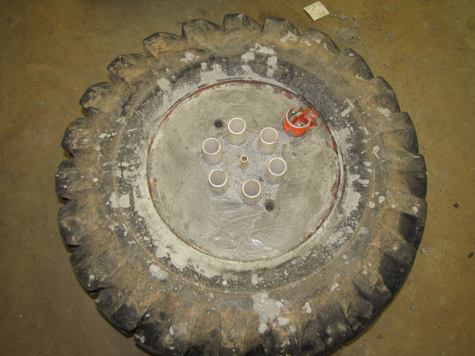

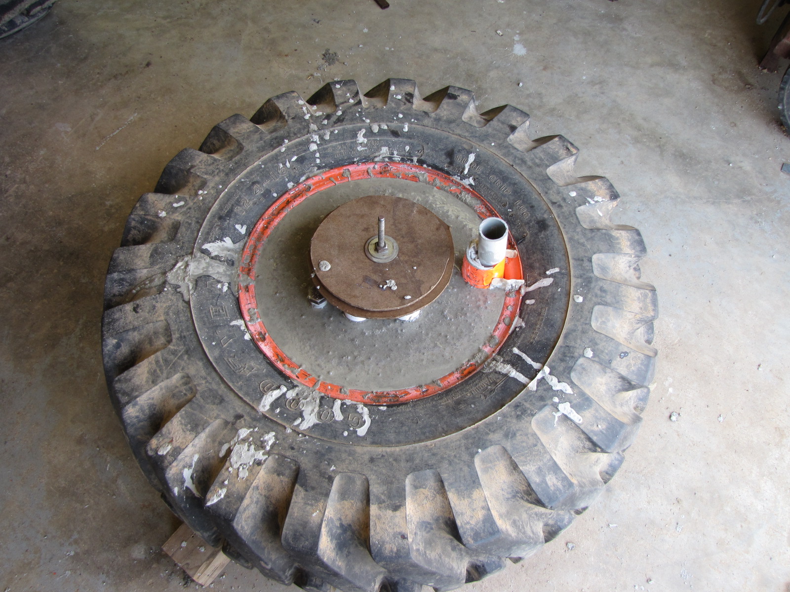

Each wheel is right at 80lbs, had to take a little back out of a 80 lb mix. I have rebar in them and that is why I said right at. This is my B7800.
I got it made so it should come out if ever need to. The tire can be changed without taking it out, in most cases. The 2 holes with the paper in them are for lifting rings. I well paint them after the cement gets all set up. People say cement shrinks up after it's all set up, I guess I well find out.

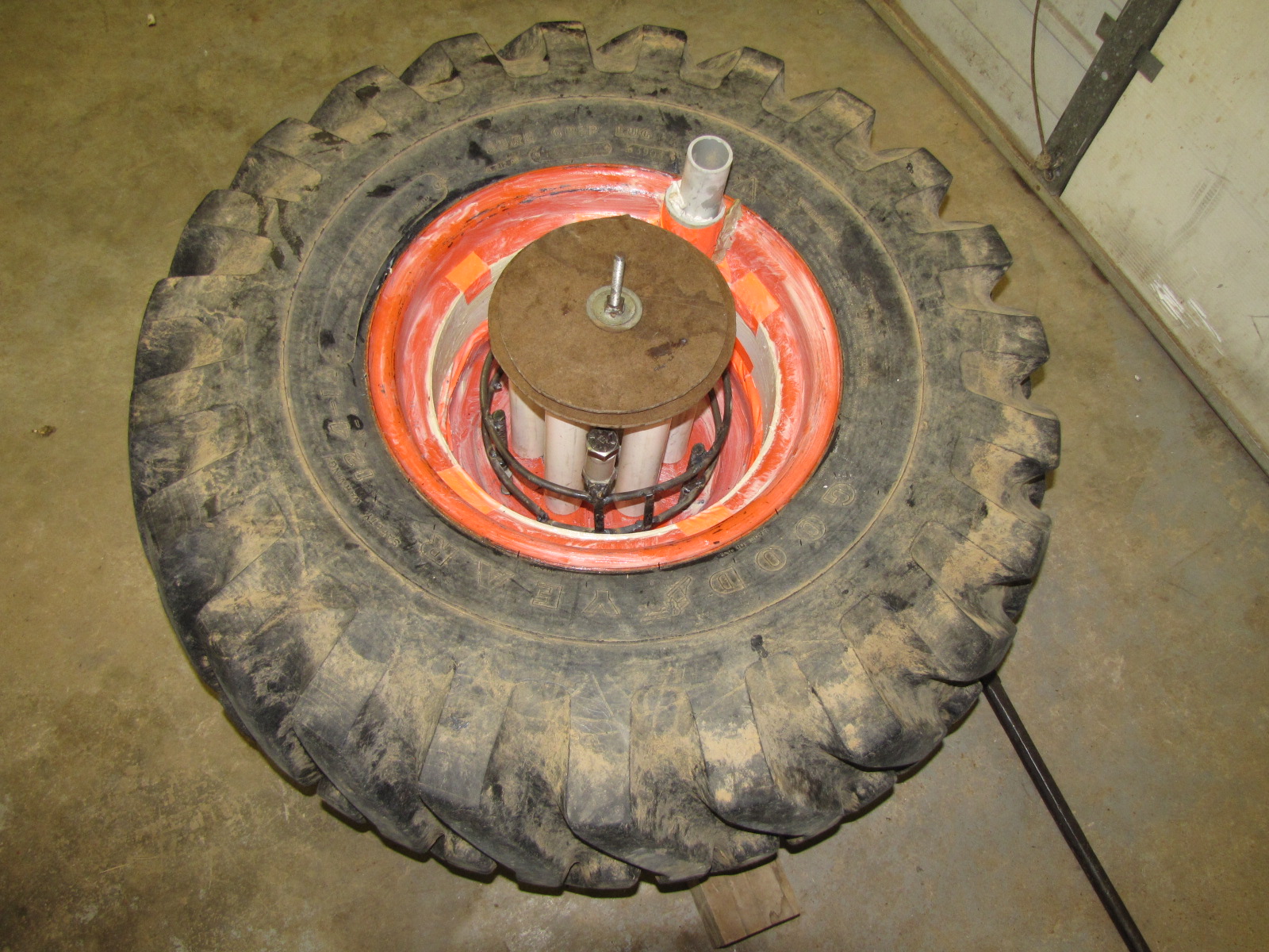

OP, are your tires filled or is the cement the only ballast? Do you have anything securing the cement to the wheel? I would think after a little bit that the cement would work loose and banging around inside the wheel a bit???
RedNeckRacin My tires are loaded as you can see by the new pictures how I hold them in. Don't know if they well work loose yet only time well tell.

Yep, cement, or conc., will shrink, and I am curious how you will keep them attached to the wheels?
/ Cement Wheel Weights #10
I think there is a piece of threaded rod going through the three holes and welded to the rebar. Still a lot of work for about 80 lbs.

Yes I welded some 1/2" bolts to the rebar and just 1st one was alot of work, second one was easy. Have you priced wheel weights? The price is unreal and maybe would of not got 80# in each wheel.
I tried it out today and with a full bucket of very wet sand and gravel the rear had a good amount of weight on them. I was able to fill the bucket and move around good without tire spin. Done it all in 2 wheel drive.

Yes my tires are loaded. I have some good size hills and it's almost a must to have loaded tires or wheel weights. I have around $20.00 to $25.00 in them. BTY Thanks

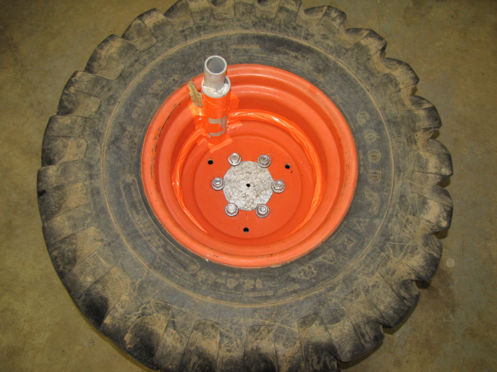

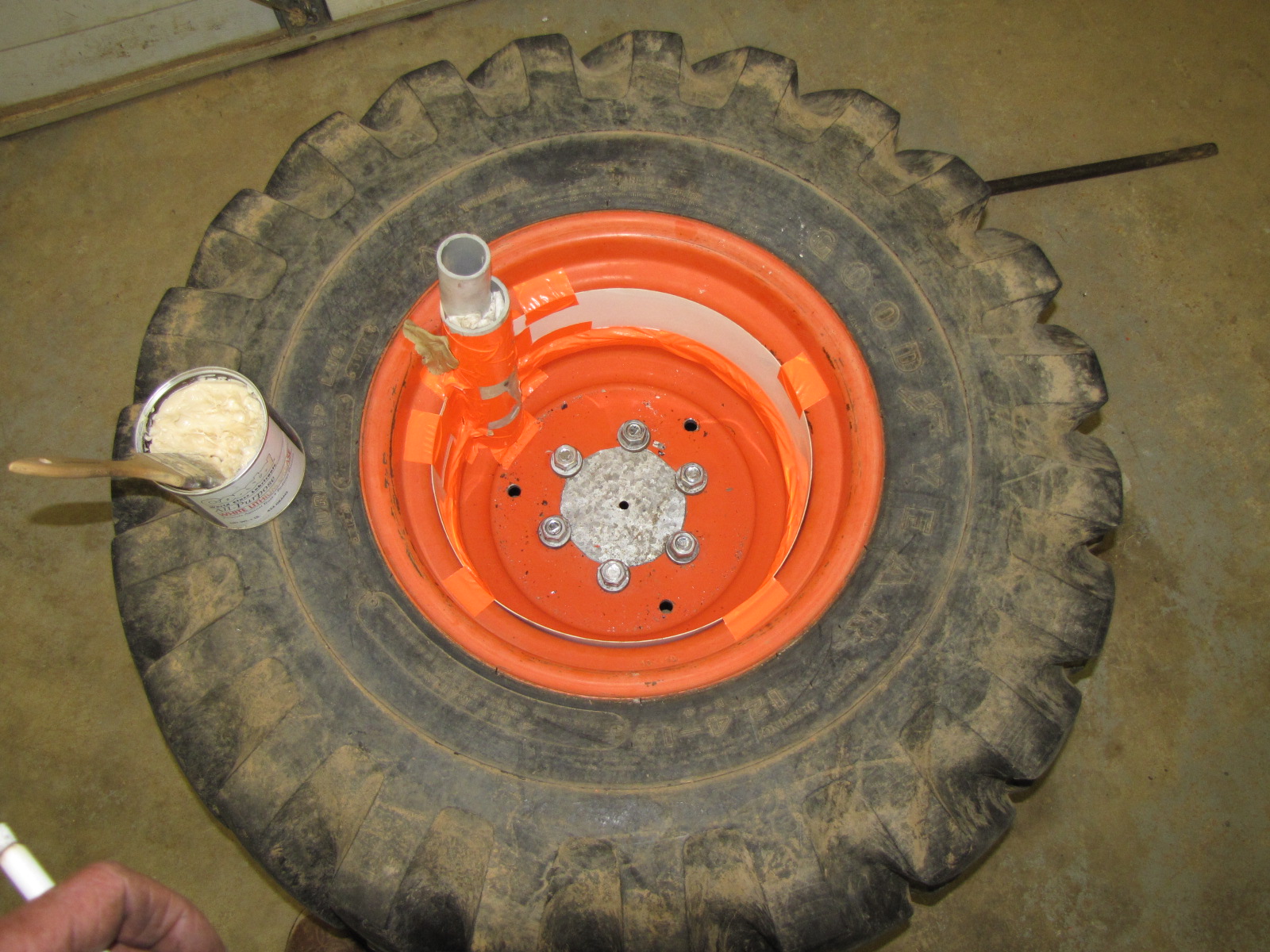

I seen your other thread about this too. I also see that you put something on your rims before you put the cement in. What it like a lubricant that won't let the rim seal to the rim? ?
#19
Yes I did on the 7800 I used a old shower enclosure on the stright part and on the 4240 I used a real thin foam rubber that was used for packing. The foam rubber worked better and that gave me about 1/8" between the wheel and cement. On the 7800 I didn't tape the top edge of the liner and that might of be a mistake. I then greased it down good and then added the tubes and rebar.
