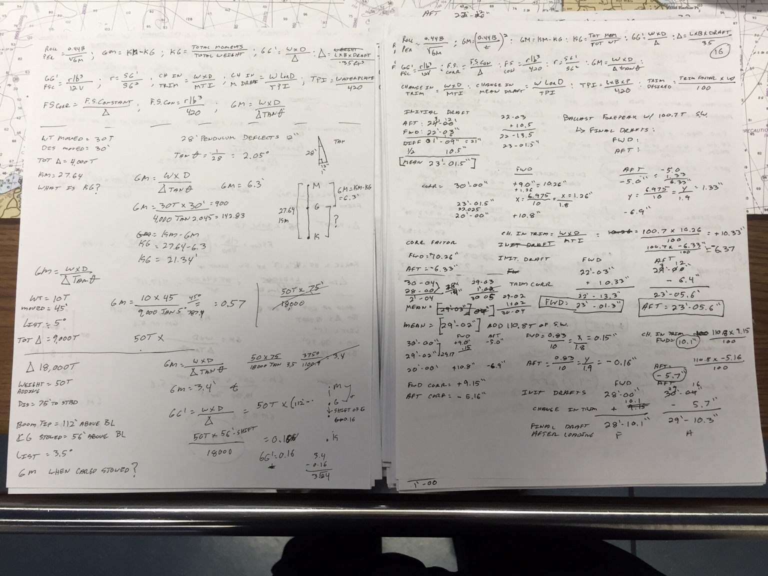

PS... And Piston with that attachment of yours. You are just showing off! Ow you've made my head hurt...

Those are all stability calculations/formulas. They are related to ships in water but I'm sure the theory is similar, instead of buoyancy counteracting the tipping motion, it would be the hard ground under the tractor.
It's pretty difficult to come up with hard and fast calculations because there are so many variables. The biggest being the width of the tractor and incline of the hill, but then there are other factors to consider such as how hard or soft is the ground, are the wheels turned hard over or straight ahead, is the tractor perfectly perpendicular to the I'll or at an angle, and of course any weight will change the calculation, such as a 3 point hitch implement raised or off the ground (or none at all), is there anything in the bucket and what height etc.
It's way past my intelligence level to come up with an answer, but the theory can be interesting.
And yes, it makes my head hurt as well!
   / Center of Gravity Information Interesting Read.More Math stuff #5
Piston,
If those are the type of calcs you are into - any discussion on that level zipped so fast over my head, I didn't even notice it. :eek: :confused2:
