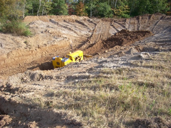

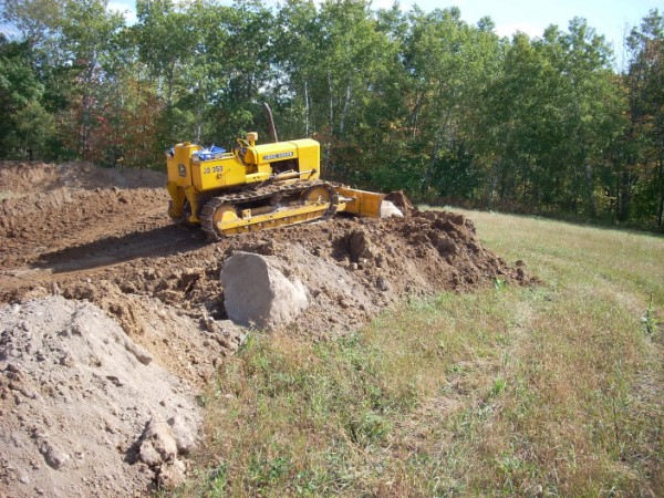

I took my pond deeper this Fall. Couple of pix attached.
What are you going to do with the spoil? The hole could easily net 200-500 cubic yards...
An equipment discussion is kind of moot as your budget and labor availability is limited. One project or the other maybe.
Smaller eq. is going to leave you weather dependent as one good rain is going to stop your pond. A dozer simultaneously with a bh or excavator ripping spoil loose increases productivity - my blade is a 1 yard but if pushing loose spoil I can get dirt hood high 2-3x per push.
My field cleanup I used a combination of eq. bushhog what I could chainsaw on the big stuff, bh on rootballs or the dozer if on a sidehill. An ag plow worked good for leftover smaller roots but my tractor is 10K lbs MFWD. I used a woodchipper for anything not firewood. Took way more than a week and $2K :D:D
