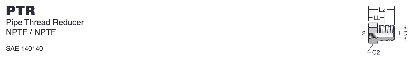

I have a Top N Tilt kit with 3/8 Ag style quick couplers, my tractor has 1/2" Ag style quick couplers (fyi the hose is 3/8"). Will something like a Parker PTR fitting 1/2 x 3/8 do the trick?
   / Chaging Quick Couplers #2
If you are looking for an NPT reducer then yes it should work
