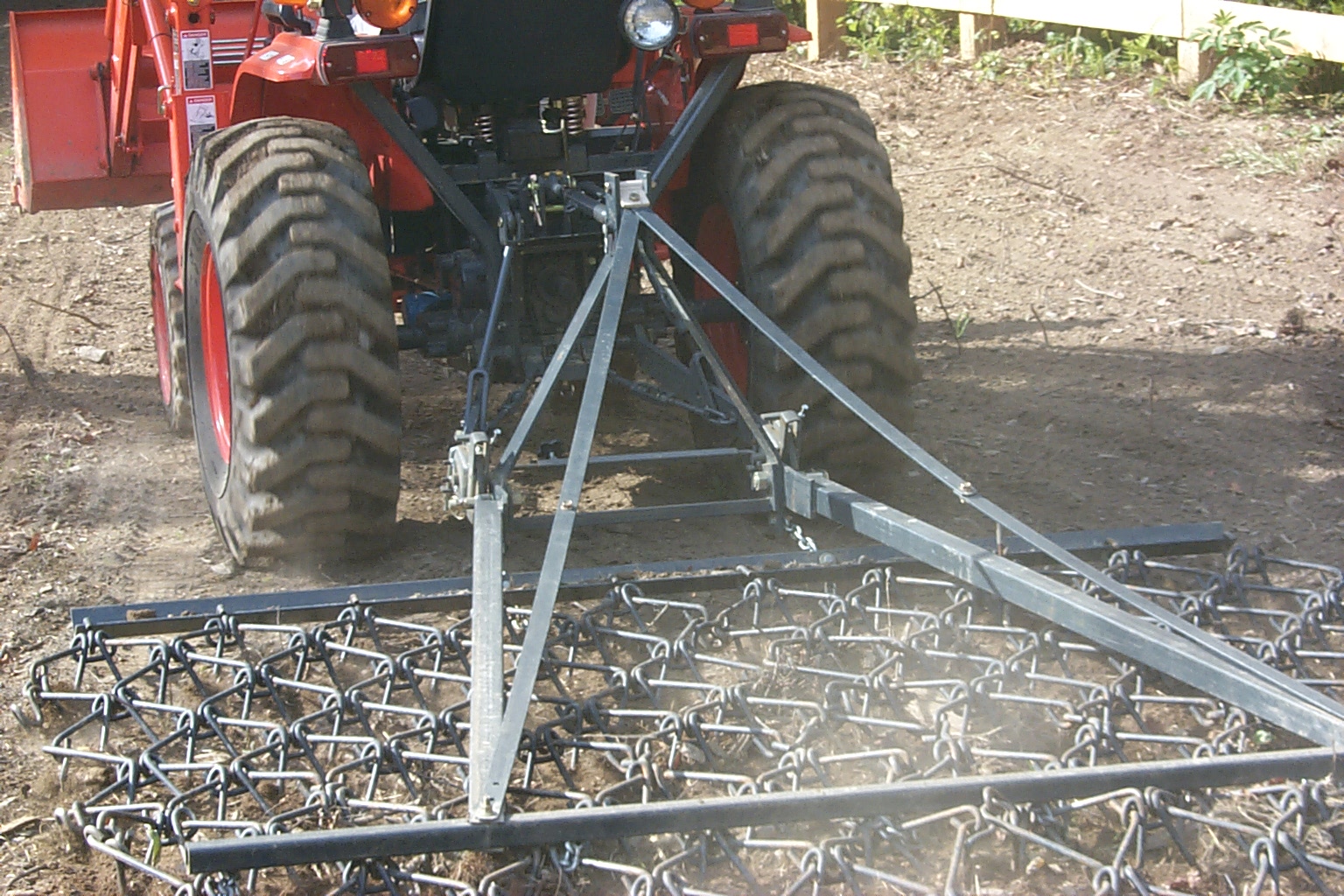

I'm interested in chain drag harrow 6-7' wide by 8-10' long with support frame carried by 3-pt hitch. Any thoughts on how big a chain harrow you could carry with NH TC40 hitch.
   / CHAIN DRAG HARROW #2
you could probalby do an 8' wide one
The ones around here are sold by section, a section being 4' x 4' of 5/8" steel. To make your harrow wider/longer, you simply connect sections. Unless you have access to other types, that means you're looking at widths and lengths in 4 foot increments. I put together four sections in to make an 8' x 8' harrow, then framed it with steel pipe. I lift/transport it with an extended boom pole. Even though we're only talking 500# or so, lifting by boom pole shifts the center of gravity farther back. That could be an issue to tractors with light front ends.
There are ready made units with their own three point connections welded to what ordinarily is the tow bar. But since they cost as much or more as the chain sections myself, I made my own lift. So the answer to your question depends upon how many sections you hook together, and how far behind the tractor they get lifted.

I'll need some sort of system to transport from field to field and need to cross a road and several short jeep trails. Since I don't weld, I'll probably have to buy commercially available carrier frame for 3-pt.

I just bought the 3-pt carrier attachment. It seemed ridiculously expensive at the time, but I really couldn't figure out how to do it myself so I bit the bullet.

This one is 8 x 8 feet and ran about 700 clams. I use it for a variety of things, arena groom, dethatcher, manure buster, seed bed prep in pastures, leveling... very handy device.
