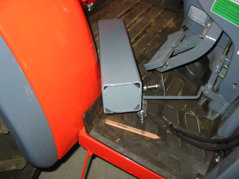

Here is a set of chain holders I made for my tractor. Started with 4x4 square tubing 16 inches long. Capped the bottom (water can drain through). Welded them to my loader brackets. Thanks to all for the ideas...hopefully this will help someone else.
Dan

Water can drain...

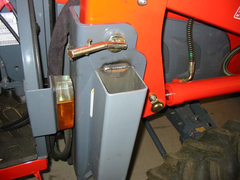

One weld on top and bottom.

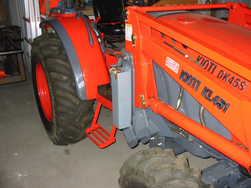

A little Kioti grey paint and it is ready for the chain!

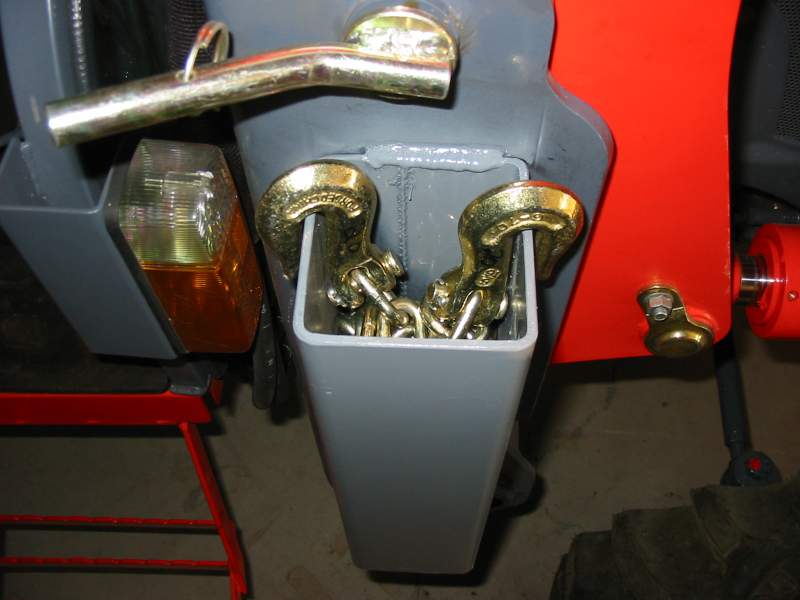

Not to bad a match for paint. It is a little lighter but looks ok. I did the exact same thing on the other side of the tractor.
Cheers!
Dan

What is the 'light' arrangement shown in this pic?
</font><font color="blueclass=small">( "One weld on top and bottom." )</font>

They are the turn signals. /forums/images/graemlins/shocked.gif The loader frame had them covered up already. The tractor is off road only. I think I may still move the signals in front of the chain holders when I have more time.

When you make the boxes consider making several. I put on three. This photos is from an earlier popst of mine. I carry three chains.
Chains get stuck in a deep box. Consider using a wind box section that is shallow.
