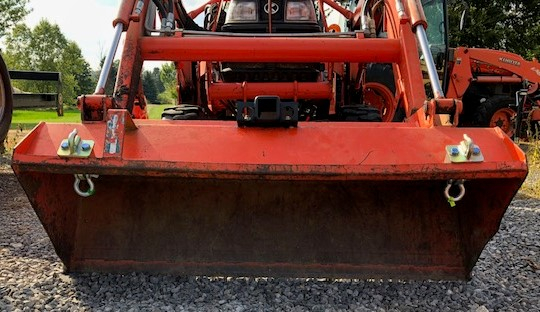

I just bought hooks from Bolt on Hooks a couple months ago and you can specify backing plates with them. The backing plate is the same footprint as the hook and plenty heavy. Just mount two near the loader-arm points or add another in the middle and you're set. Not worth agonizing about . . . you'll be glad you did it.
   / Chain hooks and tooth bar for RK37 bucket? #10
As you can see, I use this bucket for work. Chose to add the backplates with clevis eyes so I could hang shackles on them. Both the hooks and the shackles are VERY useful and much safer than trying to hang chain hooks on the lips of the bucket.
