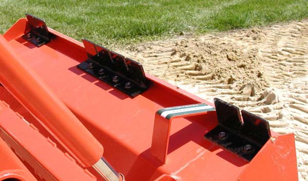

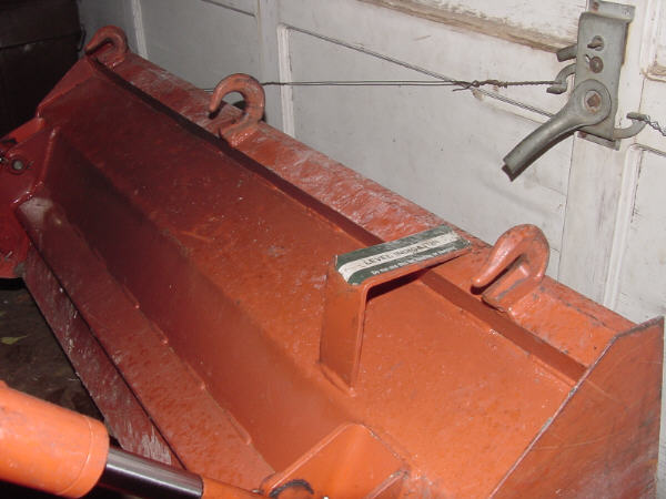

I have a B7800 with loader and box blade. I am interested in having chain hooks welded on the bucket for dragging logs etc. I would appreciate some members posting pictures of theirs to see how they are welded on etc. I don't know whether to use non slip chain hooks and not sure how many and how to mount. Any replies appreciated.

Stole this idea from another poster. Chains are dropped in the slots, and can go either way (bi-chainual?) around the bucket. Had a need to keep the chain almost against the ground last Winter when doing a rescue of #3 Son's Z28. The chain was wrapped under the bucket so it wrapped around the back to hook it on the top. Unused slots are handy for keeping excess chain out of the way......................chim

Another great idea! Thanks for the help!

My dealer did this for me on my B7500. I really like having the 2 different size hooks.
