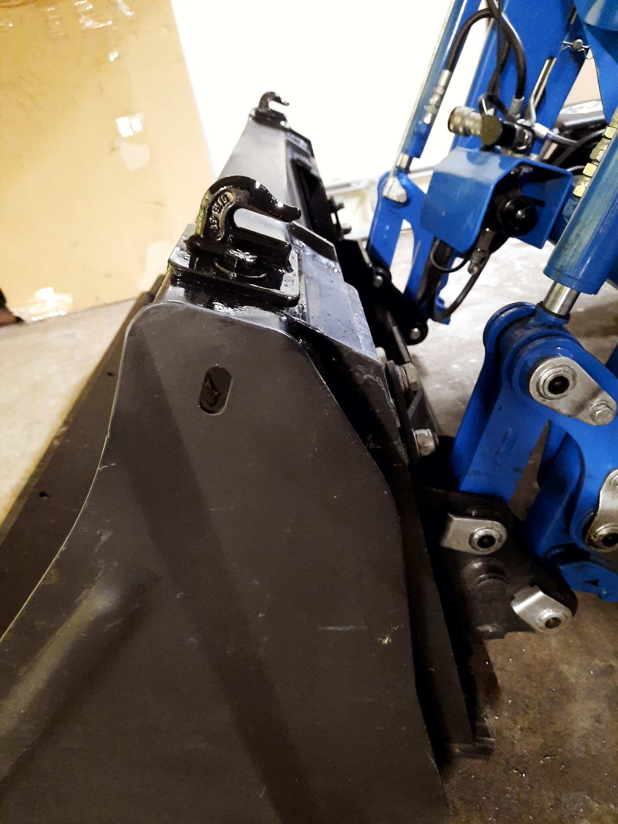

Its more often my bucket is attached, so I was thinking of adding some bolt on or weld on hooks for using China.
However, I also have pallet forks- and I guess I could also just wrap chains on those….
eh… any pros/cons I’m not considering?
(Mahindra 1640 if that matters for the feedback)

I have one hook centered on the back of the top lip,, and use it frequently.
If you use the pallet forks 1) you have to get them out and attach; 2) you'll use more chain to wrap the forks, than you would to have the hook grab the chain. Not important ? You'll be amazed at how frequently you're at the end of the chain to just manage to get it into that hook; 3) if you use pallet forks, the weight of whatever you're hoisting will be further from the pins than if you use the hook; 4) you won't bang your head on the hook - not so with the forks. They'll get you sometime.
If you use the hook, be sure to get one large enough to accept the thickness of chain you'll be using (I use 1/4"), AT THE WELD POINT. If you fail to do that, when you slip the link into the hook, if you slip the weld in first, you'll have to hammer it out.

I had hooks welded on my bucket in-line with the SSQA attachment point for strength.
I use the hooks quite often.
I do wish I went with bolt on instead weld on.

I welded the hooks to a piece of angle iron as long as the bucket lip. Then I bolts the angle iron to the bucket lip. I worked great and strengthens the bucket lip.

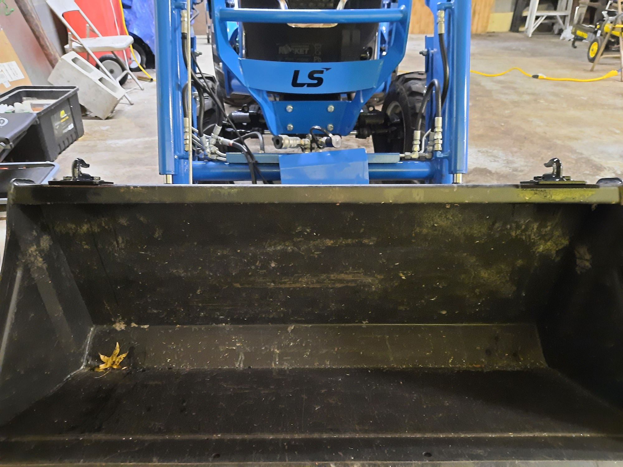

I went with bolt on hooks and that works great for me.
