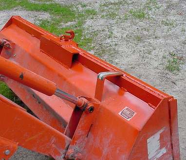

   / Chain hooks on bucket #5
Here is the first of two pictures of the hook I installed on my bucket.
Gordon
   / Chain hooks on bucket #6
Here is the second picture of the hook from a rear angle. You can see from this angle that I added a piece of angle iron aross the entire length of the bucket for added strength. As well as the smaller pieces of angle that actually hold the hook.
Gordon

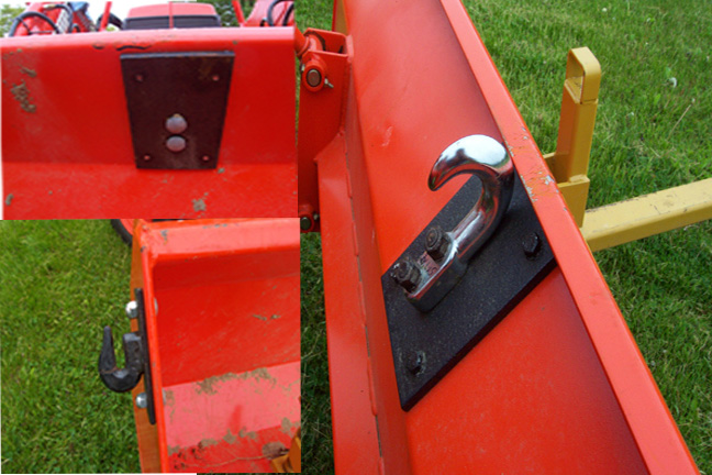

   / Chain hooks on bucket #7
Here's some pictures of what my Father did because he didn't want to fry his new bucket. To keep the inside of the bucket cleaner, he drilled and tapped the backing plate inside the bucket for the four bolts holding the two center plates together (they show up as four orange dots on the upper left picture).
The center hook itself, and the two side hook plates, are bolted through the bucket with square shouldered carriage bolts. He filed the holes square after drilling to catch the shoulders. There are nylock nuts on the bolts.
Pictures are a little distorted due to ham-fisted sizing.
   / Chain hooks on bucket #8
Mark, my congratulations to you Dad! Great idea for the hooks on the side of the bucket. Where did he get them?

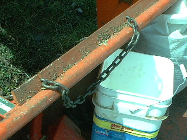

   / Chain hooks on bucket #9
Boomerang, since you have a 16LA loader, I'll submit my photo of my bucket hooks which require no welding. You can put a set like this together with parts you buy at Tractor Supply or many other places (even Ace Hardware). It will cost you more than buying/welding on hooks, but you can add different types of hooks and lengths of chain to be flexible to almost any job. I've used mine a lot and they work really well for me./w3tcompact/icons/smile.gif
<A target="_blank" HREF=http://www.tractorbynet.com/forumfiles/13-46255-BucketHooks.jpg>My Bucket Hooks</A>

Mike - Dad got them at a dealer in NH; they are weld on grab hooks, and he welded them onto a piece of bar stock. I think any dealer has them.
