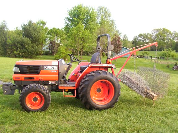

Hey all,
In another thread someone asked me to post my set up for dragging my pastures and gravel driveway. Here is my setup:
1. Boom Pole
2. 50’ of chain link fence folded over on itself.
3. Light chain to hold it together.
4. A piece of 6x6 for weight
I only use the 6x6 for dragging the pastures. When I am doing the gravel driveway, I remove the 6x6. I have set it up with a quick connect/disconnect system that lets me add or remove the 6x6 in about a minute.
The set-up has worked great. It breaks up the horse droppings but doesn’t overly damage the grass in the pastures. This is important in my case because I have 4 horses on 4 acres and they are not kind to the grass. I had considered a pull tine harrow, but this has worked for me for about ¼ of the price.
When I smooth my driveway, it only takes two or three passes to completely remove the washboards effect and the driveway looks new when its finished (about 10 minutes of seat time).

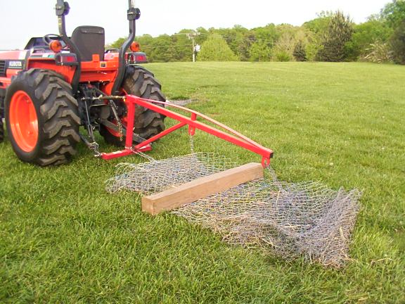

Here is a picture from the rear with the boom pole lowered (ready for dragging).

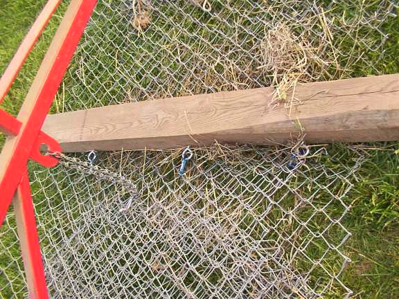

Here is the quick link. There are three on the 6x6.

Ed,
I was using pieces of rope to hold the 6x6 on. However, the wood just kept sliping off (no fun when it's covered with manure). So I set up the quick links and they hold the 6x6 in place very well. Just took three eye bolts and carabeners. Total cost was less than $8 from TSC.
Mike
