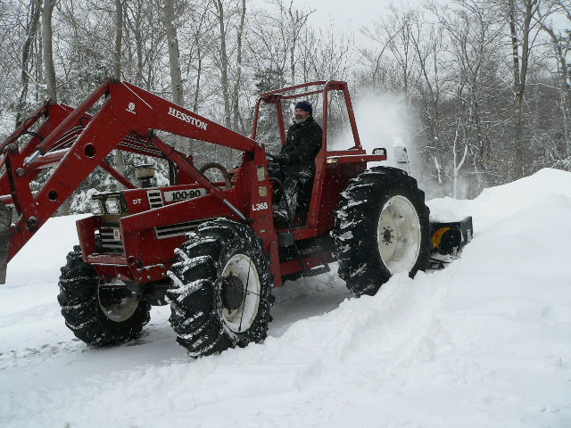

With all the tire chain threads, I noticed there are a lot of different types of chain patterns being spoken about.
That got me to thinking about the optimal match for various tires AND surfaces.
For snow removal, I am running R1's on pavement (for the most part) and wonder if I can improve performance with something other than tightly fitted, standard, "ladder" chains. I have some V bars that I could add to the set with a crimp tool. I am thinking to take these and make them "duo-grip" with the ladder chains already installed.
I plow (snow blow) a 1/2 mile long drive with a loop at the top and pad in front of the shop at the bottom. The road rises 300 feet from bottom to top.
Thoughts?

IMO, "tightly fitted" chains are not the answer. Snug, no tighteners and allowed to "walk" around and drop out of the lugs is best for chain traction.
And ladder chains have worked well on both R-1 and R-4 tires for me. For busting through deep snow in fields and/or brush in the woods, then some of the logging chains may be better. I expect most just need some assistance while plowing snow off drives and roads. So ladder chains (unless one is going for that massive, heavy chain look :) ).
