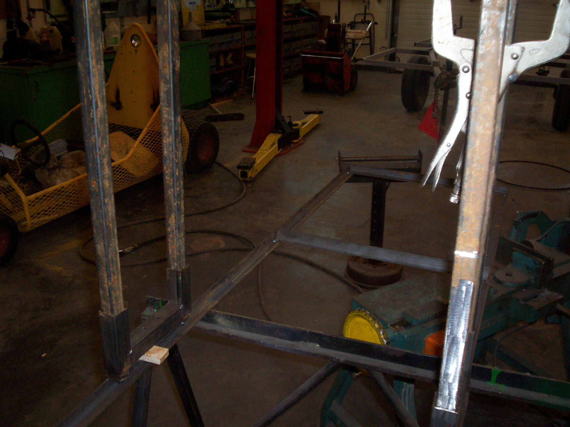

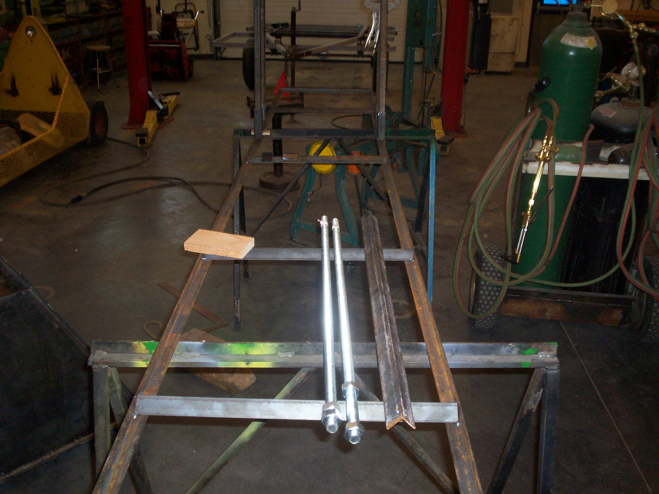

heres some picks of my chainsaw mill im building in grade 10 shop class
   / chain saw mill #3
Yes keep us posted. How big of a saw are you going to use? What ever saw you do use make sure the bar oiler is working good. They need the extra cooling and lubrication. A little more oil in the gas mixture helps sometimes as well on those long cuts.
Have fun.
   / chain saw mill
i will be runin a 90cc stihl saw with a about a 26" bar
   / chain saw mill #5
That should do a great job. Use a good ripping chain versus a normal cutting chain. You probably already knew that.
   / chain saw mill
i dont know much (16) but i plan on using ripping chain and with the small bar it should cut good
   / chain saw mill #7
Keep it up -- looks like you are making good progress. Make sure you keep detailed notes on how you built it so you can tell us old farts how it's done. :D
Seriously, though, if it isn't too complex, I'd be interested in seeing some plans or measurements or descriptions, etc.
   / chain saw mill
if it works i might patant it and sell the plans for $15 candaian or maybe just give them away i dont know yet. i drew the whole thing from scrath so i hope it works
