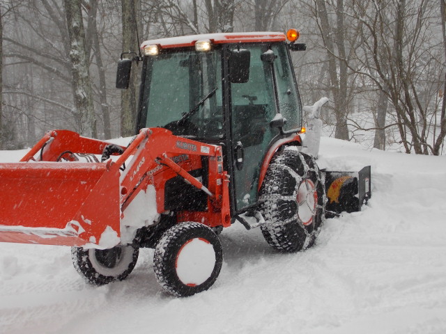

Your issue might be operator error. I wrestled today with the rear chains on my B3030. For me, there isn't a lot of clearance, so I trimmed the chains down to no excess links. I got to thinking and I believe that the chains might go on easier if the links that privet on the border links were lubed.
I still believe that in the land of snow and ice, the man with chains is King.
