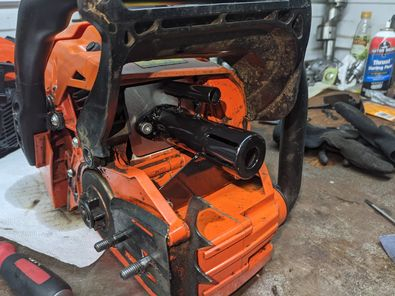

is it easy to replace the chain sprocket? how? and where is the best place to get the part(s)? thank you.

It's either super easy or pretty easy depending on if the clutch is inside or outside the chain. Most saws now are internal clutch but some are external.
Usually for internal clutch saws there is a spring "E" clip that holds the sprocket and clutch drum on the crankshaft. If it's an external clutch you have to have a way to stop the crank from moving so you can unscrew the clutch and remove the drum and sprocket.

the 591 is pretty easy (I think very easy) to replace the chain sprocket. any reputable saw shop should be able to order OR lots of interweb places have them as well.
1, remove clutch cover
2, blow out crap (shaving and oil) with compressed air
3, you will see a 7mm e-ring (snap ring). remove. this is most difficult portion if you not familiar with removing e-clips. if ordering a new drum/clutch (what many call star drive or chain sprocket) get a new one they are worth about $1. (#1 in pic below)
4, remove the washer that's between the e-clip and drum clutch. they are loose and come off easy. Order a new one as well. worth about $1. (#2 in pic below)
5, the drum clutch with minor wiggling will pull right off. new one worth about $50. (#3 in pic below)
6, under the drum next is a needle bearing cage. replace this as well worth about $10 (#4 in pic below)
7, next is the clutch assembly which if saw is running well and as you mentioned only want to replace the drum clutch a simple clean will suffice. Digging into the clutch assembly or replacing is a little more complicated. new one will set you back about $50 if you decide it needs replacing.

Clean out the inside of the clutch drum while its off. I put a tiny bit of grease on the clutch bearing when I reassemble.
The E clip has a sharp side and a rounded side. The sharp side goes on the outside.

Odd you mention a Shindawa. SIN just gave me a couple of old 488's that were rode hard and put away wet so I figure I'd see what I could do with them. I've used the rope method before to take off the clutch, this time I figure I'd try an impact. I did and it came right off. I had made a three pin tool to fit around the clutch fingers (you can buy them but I was cheap LOL).
For sure be sure to do that. Something I found on the Shindawa was a hole thru the center of the crank that went right to the bearing so you didn't have to diss-assemble it to grease the clutch which I thought was a great idea.

This one came in from a local. Those are a simple one to do. NO REASON to remove clutch on this one like that video showing above.
Take pics of disassembling if you never done it. Start with that e-clip.
Use high temp grease for your clutch drum bearing while in there.
