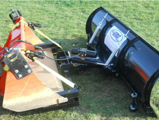

I am modifying a snowplow to fit on my loader bucket. I have seen bucket mountings held on with chains/binders and load ratchet straps. One or the other seem to work better?
Below are photos of what I am referring to.

Nylon stretches, so I'd go with chains and binders; but I think what you're trying to accomplish with a plow hanging off a bucket is going to be a huge disappointment in operation.
First you have a lot of weight cantilevered a long ways in front of your tractor.
Second is that loader frames really aren't designed for the kind of stress that setup is going to put on them.
Third, unless you put some serious ballast out the back end, your front axle is going to take a lot of strain, and with a light rear end, traction is not going to be optimal.

Short answer - the length of the lever.
More detailed answer - the added weight of the blade extended significantly further along the axis of the tractor's frame.
Think of a 3lb sledgehammer with a 16 inch handle extended outward with a straight arm.
Now, consider the 3lb sledgehammer with a 32 inch handle extended outward with a straight arm.
Which configuration will exert a greater strain on your extended arm?

Not to mention the lateral forces generated by an angled blade (not common in loader operation) compounded by the aforementioned length of the lever. And the weight removed from the rear axle as the additional weight is added waaay out in front of the FEL bucket edge which will decrease rear traction and add stress to the front axle drive components.

Chains, as others have indicated. No question on that one. Chains with ratchet binders to be specific.
