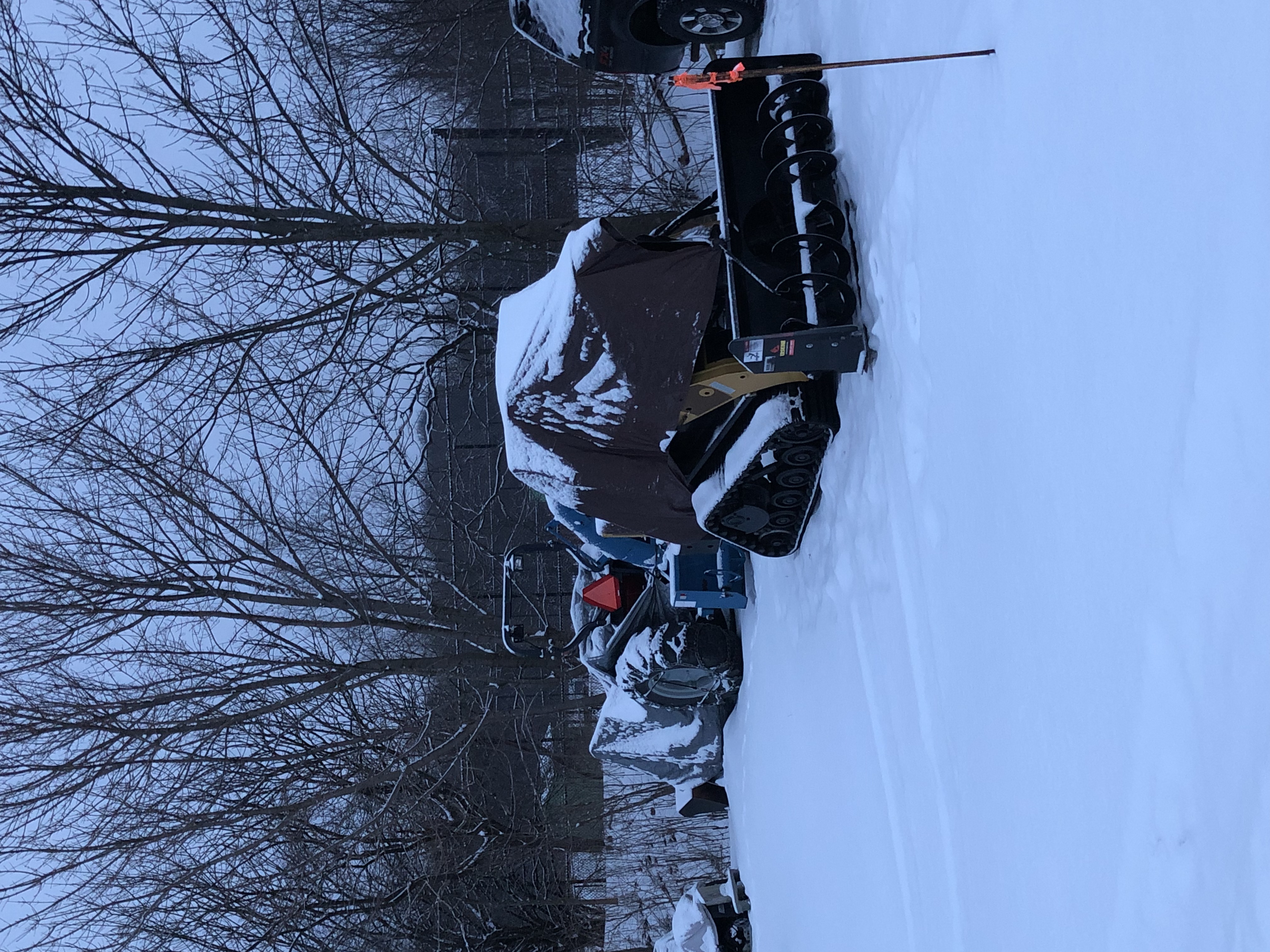

I致e got R4 tires. My chains overlap the lugs more than enough to not get buried in them. I don稚 have the V bar chains; just regular links

Picture I have on my phone of the chains on my R4 tires - tractor is behind the skidsteer, but you can zoom in on the tires and see the chains
