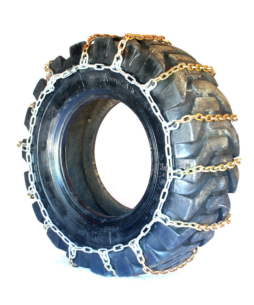

I have a 1000 foot long dirt driveway with a few slight grades which are enough to make the tractor slide in snow. Tractor is Kubota 2650 with front mount blower. Looking at a set of Titan round twist link chains for 12.4R16 tires. Need some advice. Only need them in Winter. Photo shows chains and type of tire I have.

They look good to me, bub will you have room between the chains and the fender. May need spacers for it to work. You may need a ballast box of some sort to help get through the inclines.

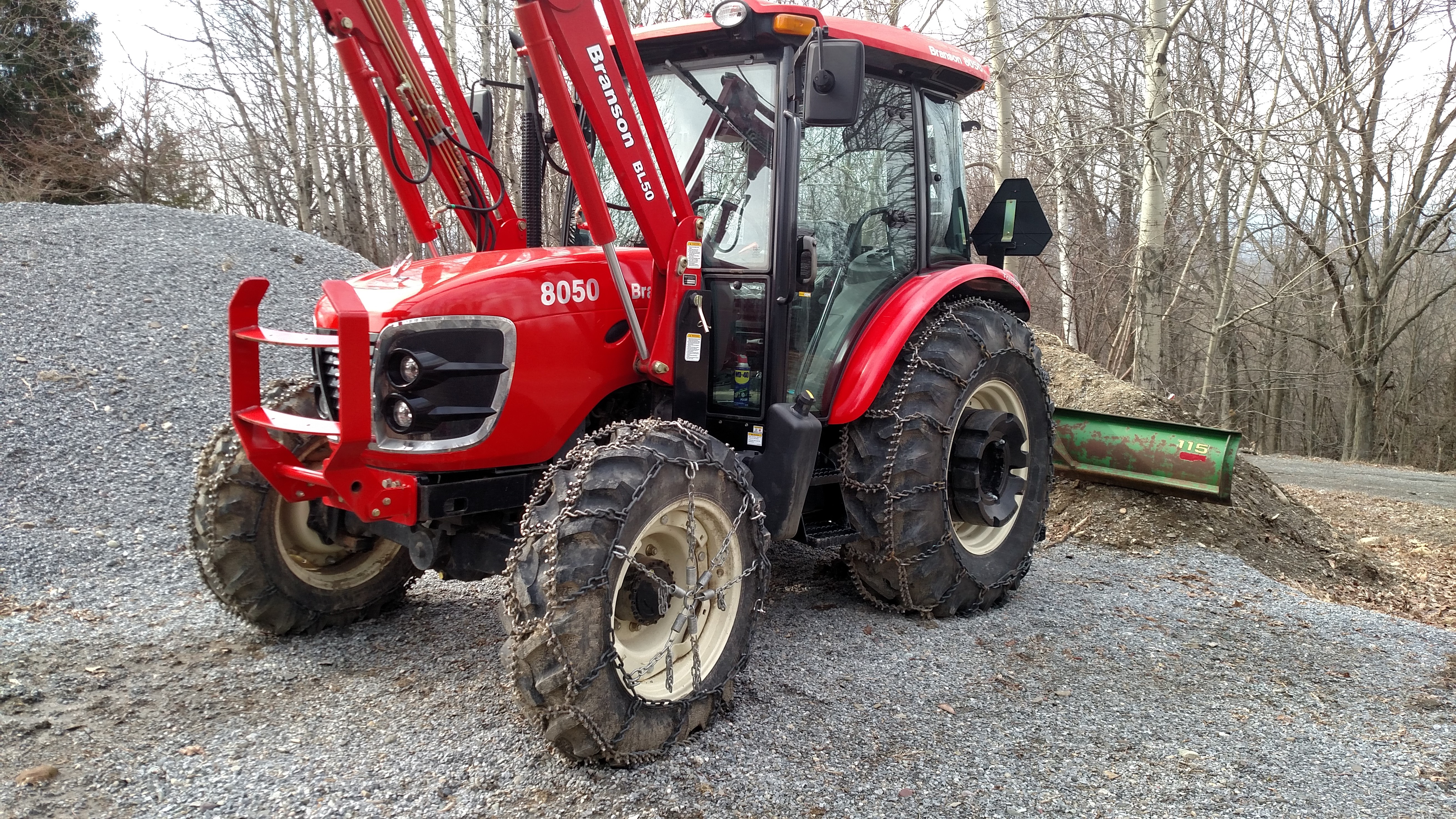

Even though they cost more I highly recommend the euro style chain, they will positively anchor you in place, the ride is much smoother.
The duo grip will give you a bump on every tie point. The street type will dropdown in between your lugs some even on your R4 tires.
I can run down the road at 15-18 mph if I need to with mine, smooth ride amazing traction, no side slip and they don't tear up or mark up the paved road much.
The rear ones seem the best overall, the fronts are a bit too aggressive.

1000’ Road with a little grade on a dirt drive? Skip all the fancy stuff and get some chains online for the fronts only. They should run under $200. I’ve had zero sliding on my tractor with front chains. I use a plow, box and bucket. I blower is far easier to control with the low speeds.

My Kioti DK35's tires are close to yours. If you are planning on ladder type as shown in your photo I recommend 2-link ladders rather than 4-link. I originally tried 4-link ladders on my R3 tires. They were smaller gage old truck chains and got lost in the treads. Larger chains would not get lost as badly but patterns such as DUO, H-pattern and the Euro-styles louNY do a better job of keeping the chain out of the tread.
RNeumann's suggestion for front only may work. Some suggest running front-only can harm the front end but I don't think that is the case as long as you don't operate aggressively and spin the tires a lot.
As LouNY states about DUO's; they can be very rough. I was not happy with mine and converted them to the H-Pattern as shown in this link:
http://www.tractorbynet.com/forums/...ed-modifications-post3150916.html#post3150916
It made a huge difference.
I got H-pattern chains for the front and am very pleased with them. They are a lighter gage than the rears. Here is a link showing my front H-pattern chains:
http://www.tractorbynet.com/forums/...hains-dk35se-cab-post4071972.html#post4071972
I had 2-link ladders on the front before that and they worked well as shown here:
http://www.tractorbynet.com/forums/...cknow-snowblower-post4063330.html#post4063330
but they were worn out and interfered with the front components. So I added front spacers and light H-pattern chains. The space for my rear chains is also very tight and I may add rear spacers next year so I don't have to be so fussy about installing the chains. (I won't do it until then because the chains are on now and I don't want to mess with them again until spring).
If you go with front-only chains the smaller gage H-pattern may be a good choice. They are lighter and easy to install. If you found they were not enough you could always add rear chains later.
One thing...chains make a huge difference in snow.
