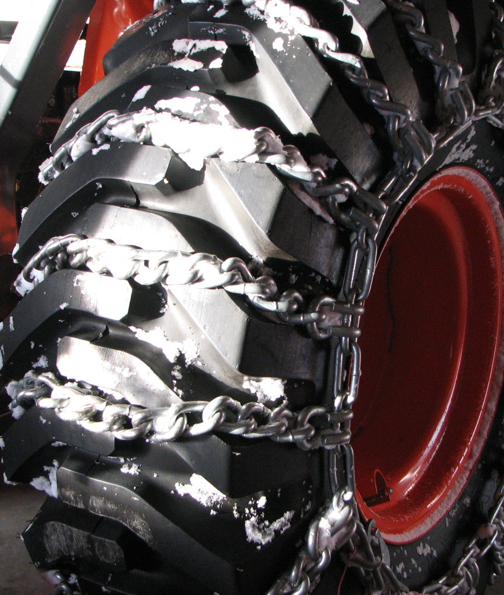

I've been using these 2 link ladder chains on a B7800 with R4s (12.4 - 16) for the past few years with no clearance issues, and they don't chew up the cement floor in my garage either. I snowblow my 530 ft. gravel driveway and my neighbors 100 ft. gravel driveway
both have hills at the end where they meet the main road. The first year snowblowing I tried -without- chains and I always had traction problems at the hilly end of both driveways. With chains I have no problem.
Good Luck
