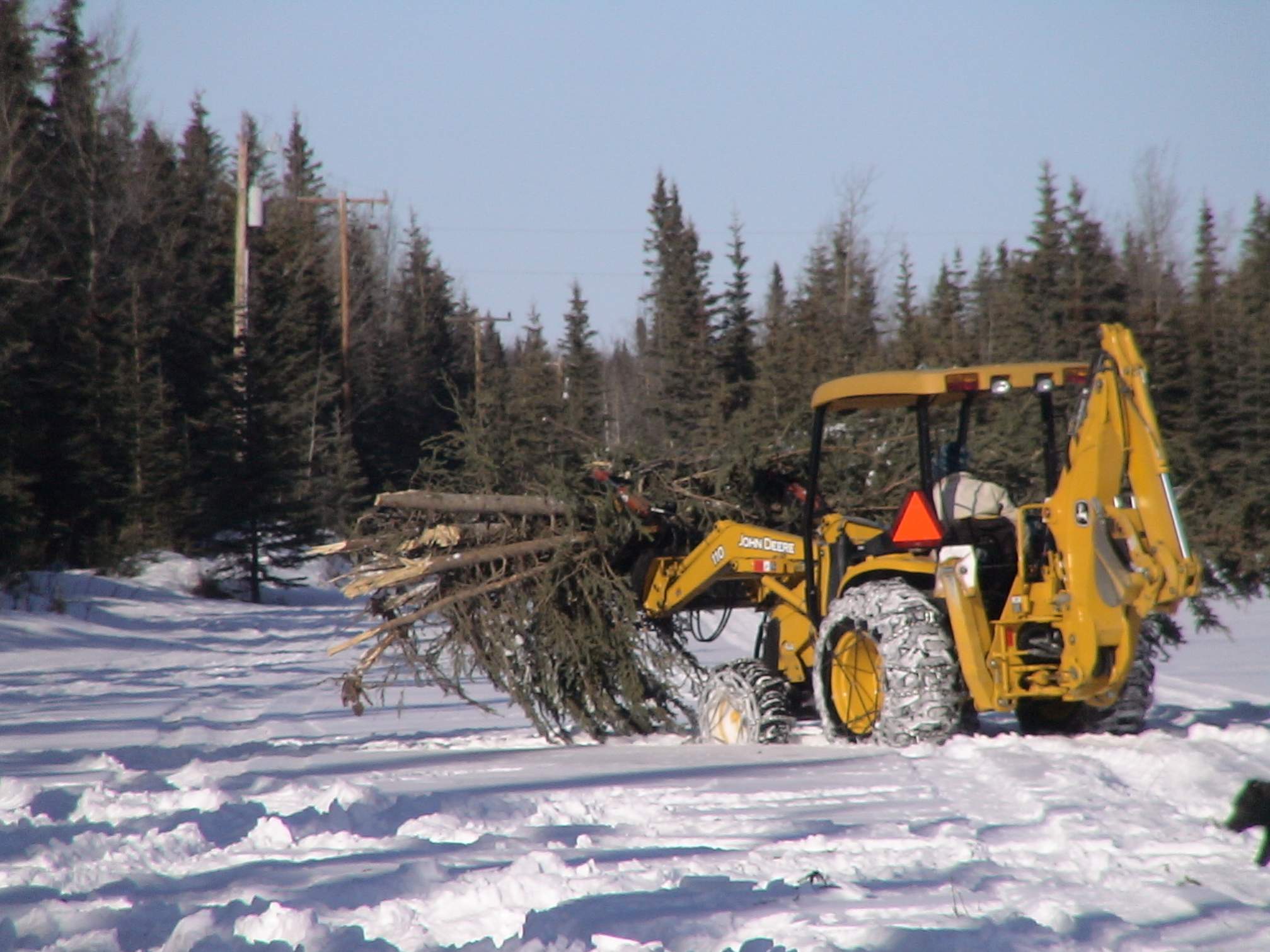

Anyone running chains on a R4 4x20 cab? If so what are they. I use a 7' Fisher on my loader and with light stuff like we had last big storm (24+"), no problem- but when it gets heavy, tractor will go sideways for sure.
   / Chains on R4 equipped 4x20 Cab #2
I've used chains for many years on my tractors. Including the 17.5x24 R4's (same as your 4720) rear wheels on my JD 110TLB.

Yup Steve. Sure did... I used wheel spacers for a 863 Bobcat. Local JD dealer sells both (Bobcat and JD) - they put me onto them. The biggest issue with chains on the 110 is the clearance between the tire and the inside face of the fender well. It's a PITA to attach the rubber tensioners (or installing/removing the chains) and if you're ever in mud at all - it balls up pretty tightly between the fender and the tire. Not a good thing...
That said, I used the chains for a year before I put the wheel spacers on. It works ok - but, as I mentioned - there is a better way!
Of course, the R4's are a 2-position rim and if they're mounted in the narrow configuration - switching them to the opposite side - increases your tire clearance; a bit.
AKfish
   / Chains on R4 equipped 4x20 Cab #5
The chains that I currently use have links that are configured like an "H" but with 2 cross-links between the vertical legs of the H. I've used a standard ladder-type link chain in the past; but, the links tend to fall into the gaps between the tire lugs and do not provide as good a grip.
The chain links are 3/8" diameter steel.
AKfish

Much better explanation.. Thanks. One added consideration; chains are very destructive of garage floors and driveways and sidewalks - when you forget exactly where the edge is... And they're a real PITA to take on and off. So, when you put 'em on - they tend to stay on until it's REALLY Spring!
But... they're definitely cheaper than wheel weights and even cheaper than beet juice - Rimgard. (Although, if I had an opportunity to have my tires filled with RimGard - I'd do it.)
Chains make sense if you live someplace that really has WINTER. Or hilly country and you're in the woods with mixed ice and snow.
My chains go on in mid-October and don't come off until the end of April.
Something else that I've noticed after using chains for a number of years - your tires will last longer. The chains take the brunt of slipping and gouging on hard, frozen surfaces - not your tires. After 1,200 hours on my 110, I'm fairly confident my tires will be Ok for another 1,200 hours.
AKfish
