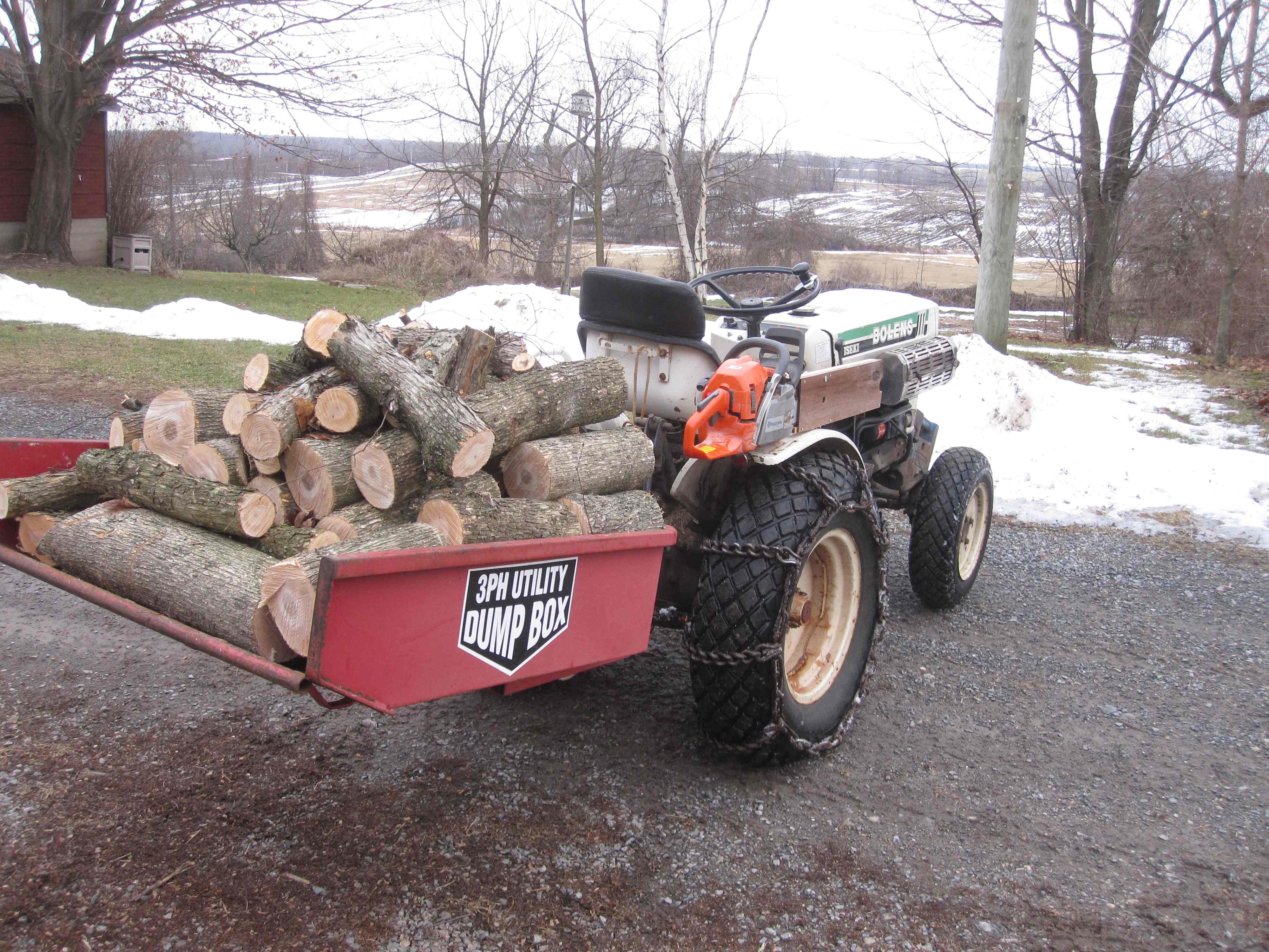

In the barn I found a pair of tire chains my dad had for his 1968 Kaiser Military Surplus Jeep. They looked about the right size, so I tried them over the turf tires on the back wheels of the Bolens G174. It took four of those 2 1/2" ID twist-on links and two additional links from an old horse tug I found in the barn to fit them properly. The result seems to have adequate clearance and provides a massive improvement in rear-wheel traction in deep snow. I can always steer with the brakes if the front wheels can't keep up.

Here's the Bolens G174 with a jeep's chains and a load of green ironwood. The chains greatly improved winter traction in return for a slightly rougher ride.

That looks great! How do you like the 3PH box that you have on the back? I had looked at those in the past, and I like them. I know that the same company makes a scoop, that acts like a loader bucket, but I am having a hard time finding one. I have the R1 ag tires on that give me pretty good traction, but I really should add some chains as well. Thanks for the photo, and info!
