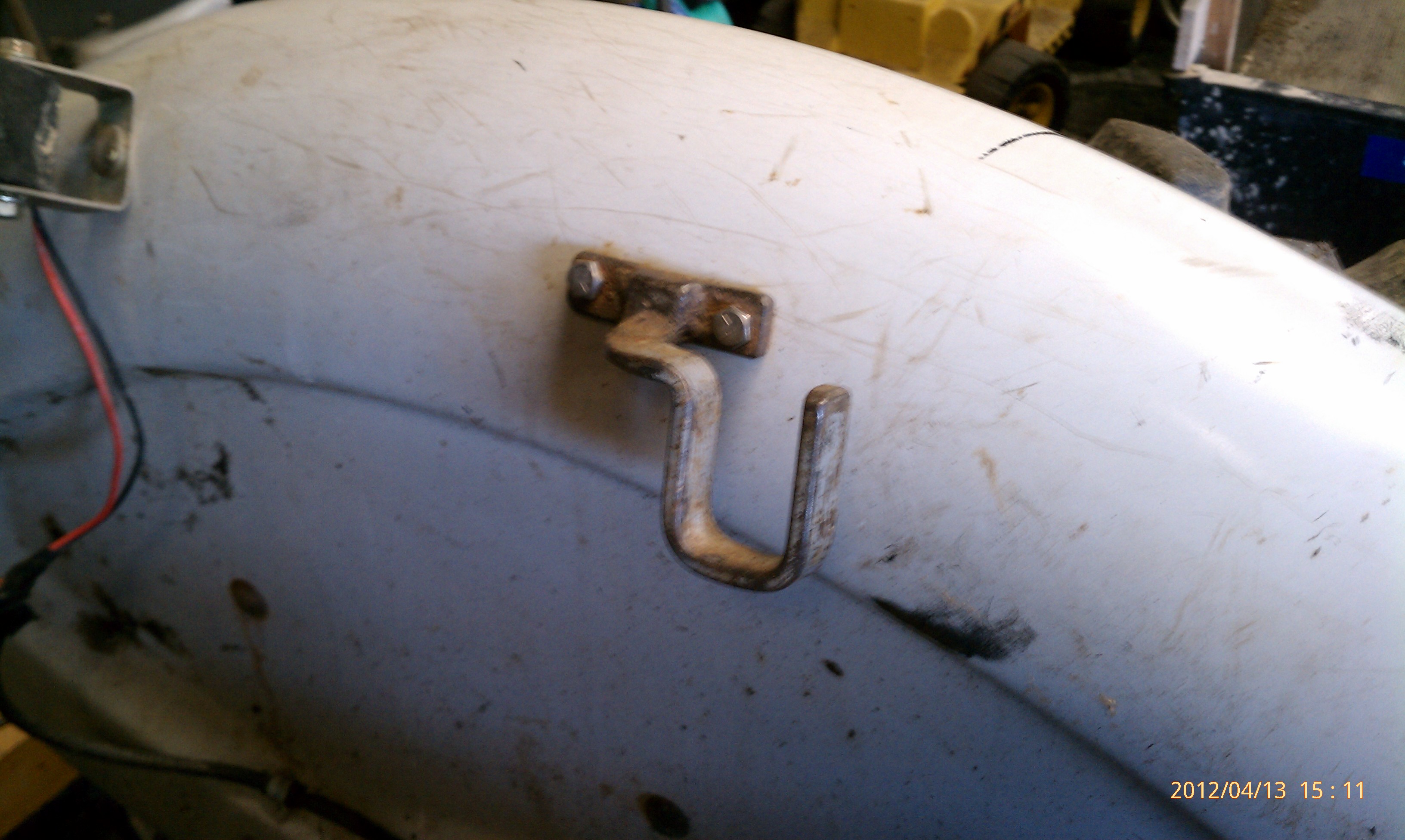

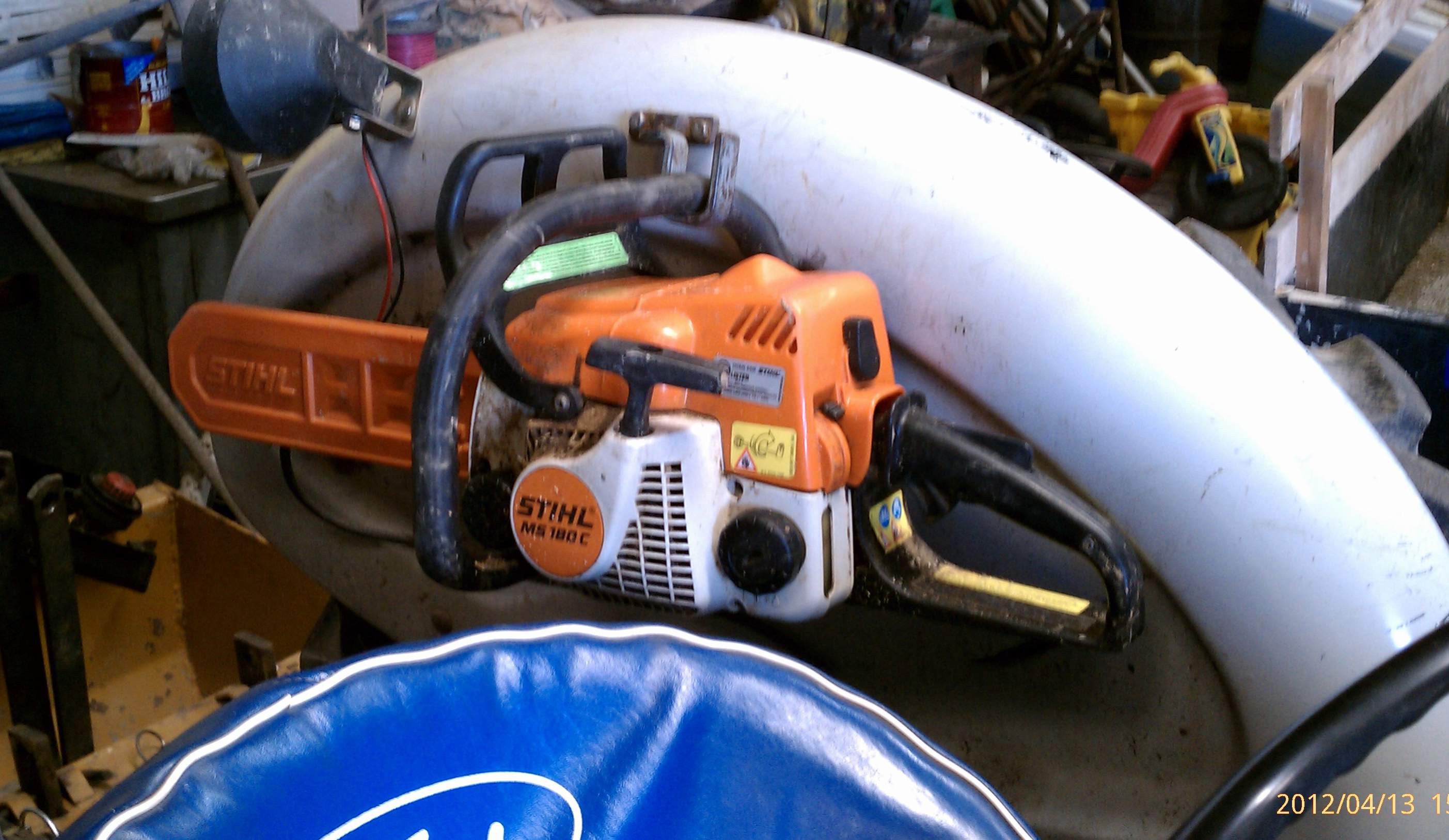

I made this a long time ago and thought someone out there might use the idea. It's pretty simple, just a piece of flat stock bent to shape and bolted to the fender. Tractor is a Ford 2000 prior.

Nicely done!
Looks like that space was meant to have a saw parked in there.
   / Chainsaw bracket #4
Great idea. I own exactly the same saw and I am always looking for a better way to carry it on the tractor. I have a little less clearance with my K L4310 between seat and fender, but I will bet I can find a way to use your idea.
