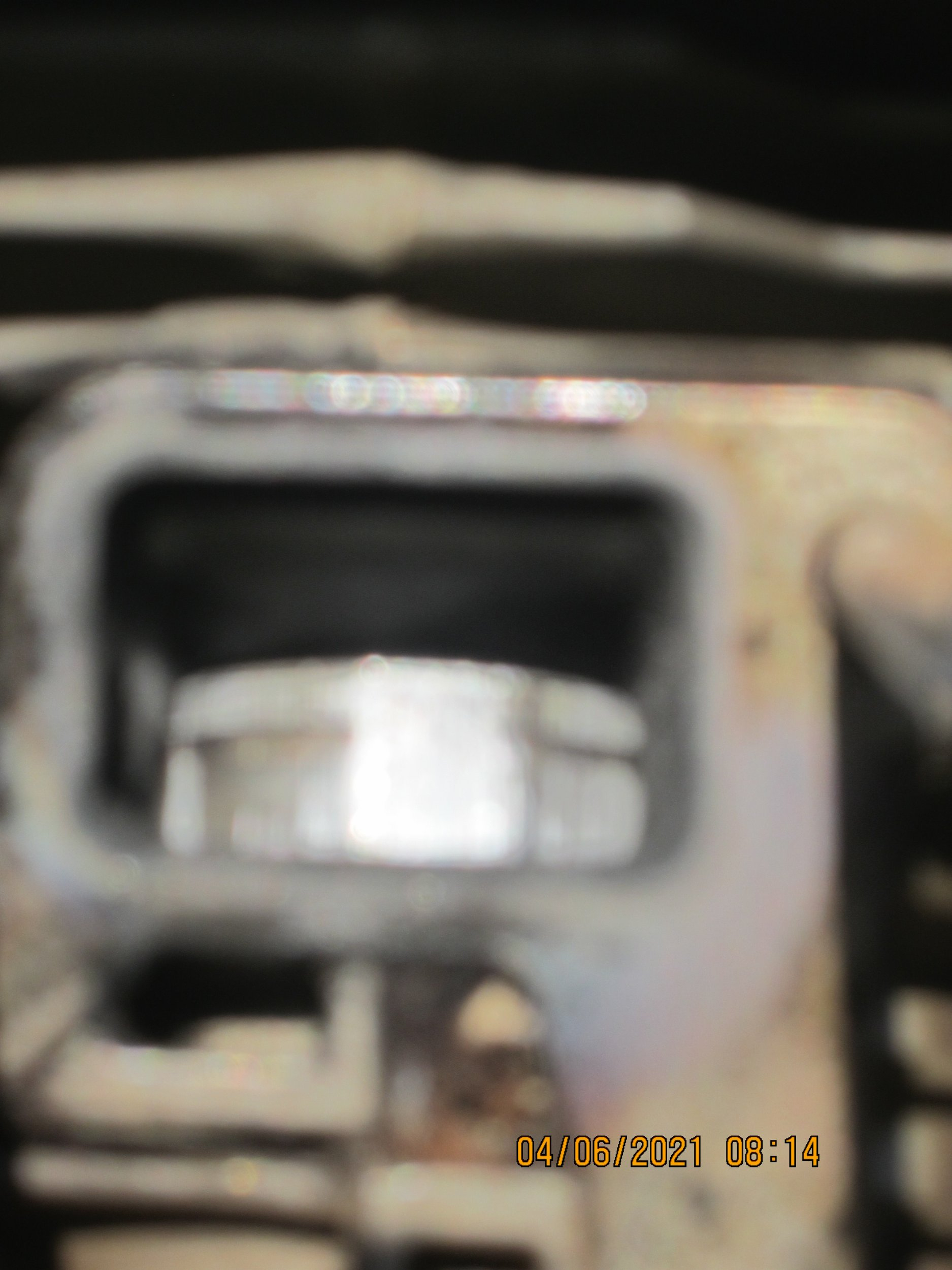

Turn the crank so the piston skirt is visible through the exhaust port with the top of the piston right at the top of the port, take a good picture and post it here so we can look at it. If it's seized it'll usually show damage on the exhaust side piston skirt. That's the hot side so it goes first.
Compression should be above 120 psi. With a small engine like this you need a compression tester that has a Schrader valve in the hose at the spark plug end. Some don't.

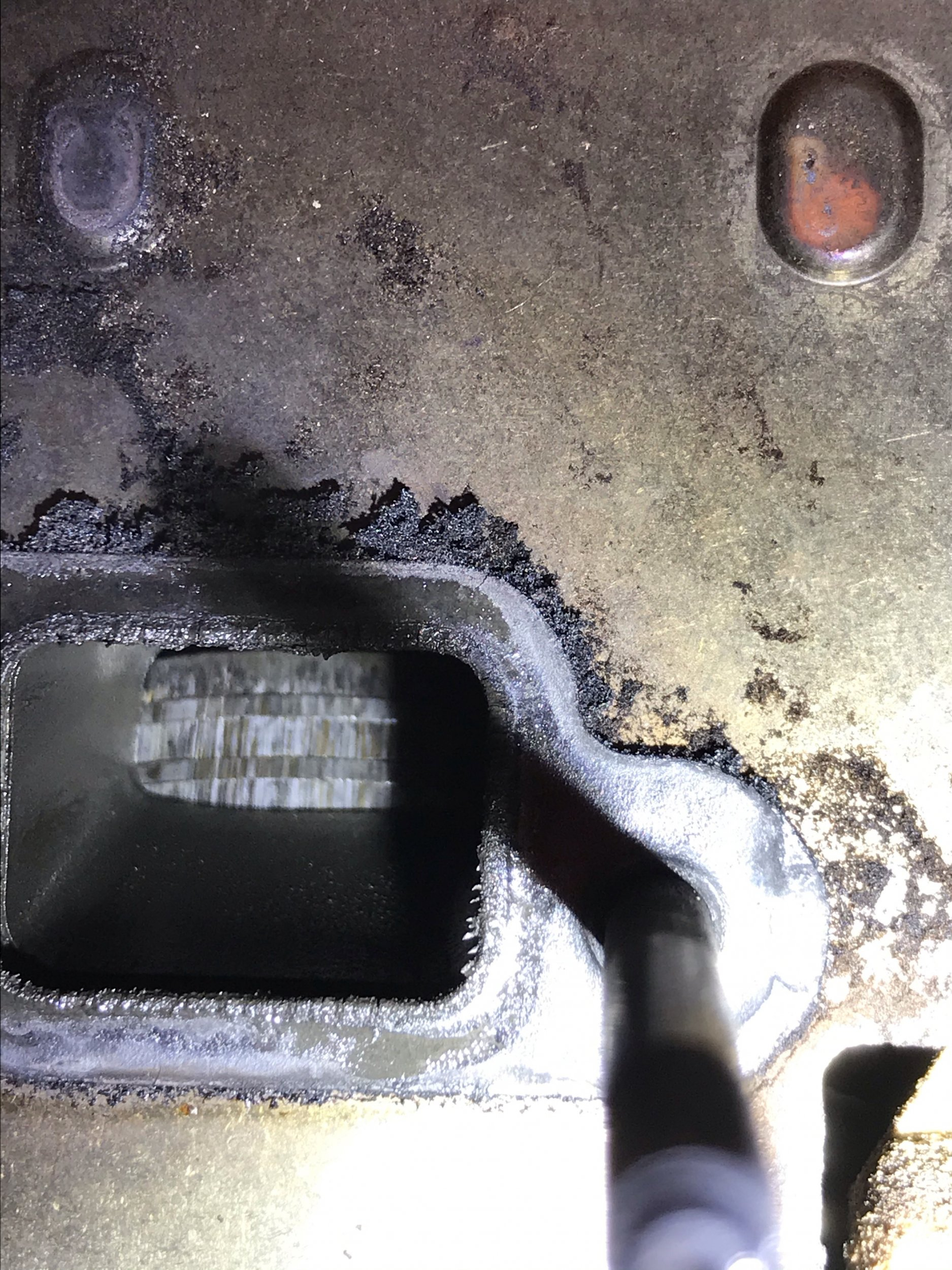

Check the spark plug first, make sure it hasn't started to come out. I’ve attached a pic of a MS250 that had piston damage. As bad as it was, it still had decent compression and ran but idled badly. This looking in the exhaust port.

Okay guys,....still waiting for the eye doctor office to return my call. You know how that goes
So I went outside to do the above cord test that "thclimer" posted. It took about 6 seconds for the weight of the saw (without the bar & chain) to drop to the ground....tested several times.
Then with the sunshine I got some pics....some not very focused. It may be better to buy a new saw that take this one to a repair shop....Geeze I would hate to do that.
My compression tester is just a rubber hand held device with no Schrader valve.
