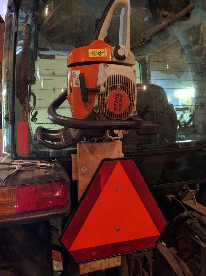

Thought people would like to see a chainsaw scabbard for the Grand L6060 cab. Made from spare plywood, about 18.5" long, 6" wide with 1" pieces on each side leaving a 4" channel for the blade. 2x4 to mount to existing bracket just above the washer fluid tank. For a large saw might want it lower or further out to allow roof clearance when removing but fits fine with a 16" bar on my smaller Stihl 260. Handy to have a saw along. Mounts with 1/4" x 4" bolts up top, slighlty larger and shorter down below (existing bracket was there for the safety triangle.

Very handy! And do I understand, correctly, that you didn't have to drill any new holes? If so, even better!
