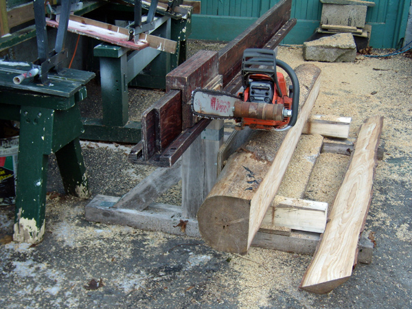

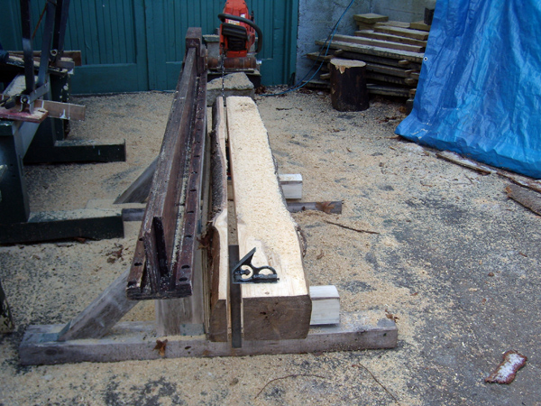

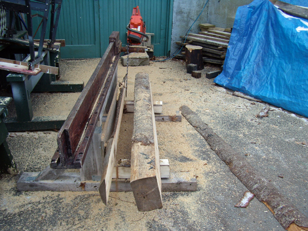

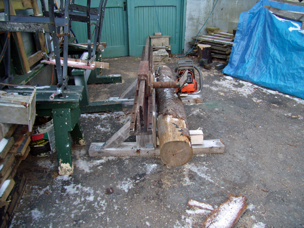

After the tractor hauls, loads/unloads the log I use this little mill to make dimensional lumber. The pictures should be self explanatory. The lumber will go to making a stand for the camper.
It's a husky 365 saw with 24 inch bar and rip chain.:D

That looks like a handy rig.
Is 8' or 10' your maximum cut with that setup and how long does it take to make one cut of that length?

Egon,
Good idea for a mill. Did you build it? I like the way the saw stay's vertical as it is intended rather than some mills that have the saw horizontal. Don't think it matters much but seems allot safer.
   / Chainsaw Mill #4
I don't remember you haveing that stand for the rail to mount to before. Is that new? or am I just noticing it for the first time? I like how it's designed to be perfectly straight while cutting. Even the wedge system to hold the log in place in brilliant!!!
Do you cut your logs green? or do you let them sit for awhile? Does it matter?
What chain do you use and is there a cut or angle to that works best?

The guide is eight feet long as that was the length of the plywood. The ends are arranged so that more length could be bolted on.
Takes maybe five minutes for one cut but a lot depends on the wood, the thickness and how sharp the chain is.
The stand is a few years old but I may not have posted pictures of it. It was made to handle smaller diameter logs.
The chain is Oregon and is filed straight across for ripping. There quite a few different types of ripping chain but my knowledge is quite limited on whats what in that department.
That was well seasoned pine you saw being cut.

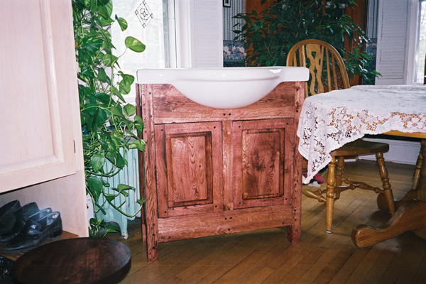

pic. of last thing I made. A bathroom vanity seen before installation. Made of Oak with Poplar back. No screws used in construction. Pegged mortice and tenon joints.

Nice looking mill and beautiful craftsmanship on the vanity. I've milled a bunch of oak with a Granberg CSM, its a lot of work, but very satisfying. Just to darn busy to make any projects with it.:(

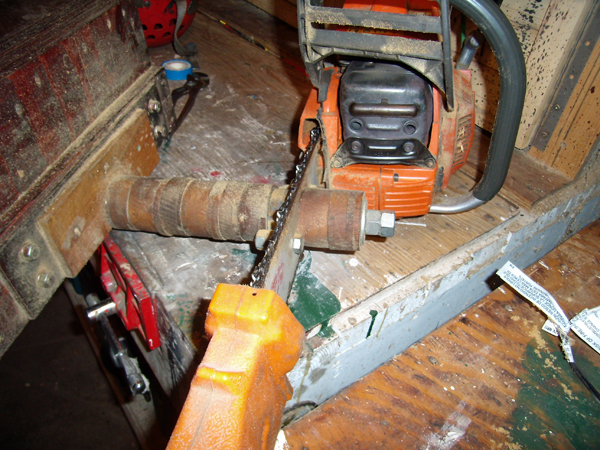

Anyway, I have a spare engine now and I was considering building a bandsaw mill, and running the saw head assembly over 2 inverted 3" angle irons
Your configuration looks far simpler using a chainsaw. Would you advise me on the saw bar holding fixture design?

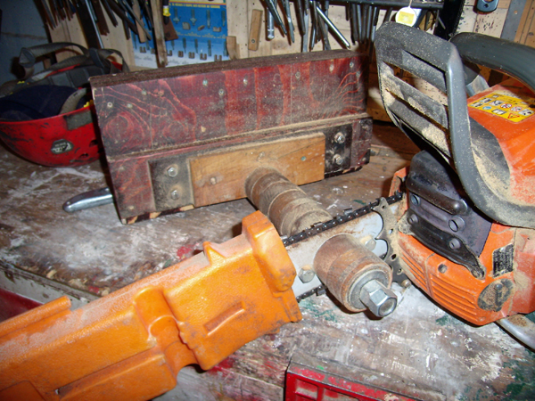

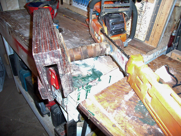

Some more pictures. There is a bearing bolted to the saw blade that the shaft goes thru. Moving the spacers allows for different width cuts.
Look up "Beam Machine" on Google as mine works on the same principle.
