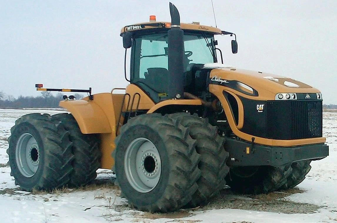

sorry I can't help but you made me laugh. :LOL:
When I hear Challenger tractor the first image that pops into my mind is... got me excited
then I google your model and found my first impression was WAY OUT there... Wish I could help
Caterpillar made ones are the only Challenger tractors I am familiar with. 😳

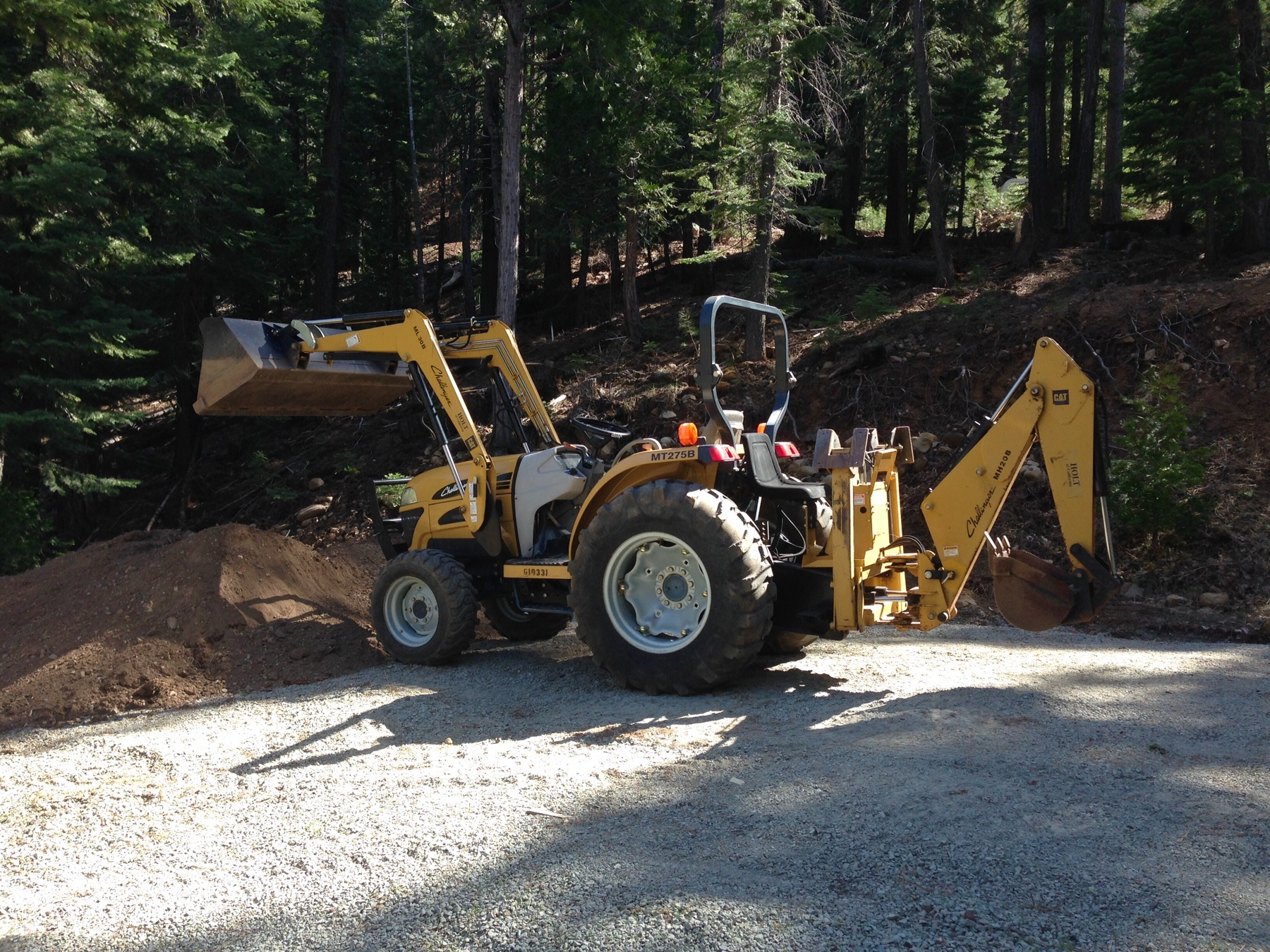

Sorry to disappoint, but might be a distant relative. Lol
   / Challenger MT275B Hydraulic oil air lock #10
that's a good looking 40hp tractor! I like the industrial lines and the duty look versus some of the swoops/plastic etc... used these days by some that seem fragile
