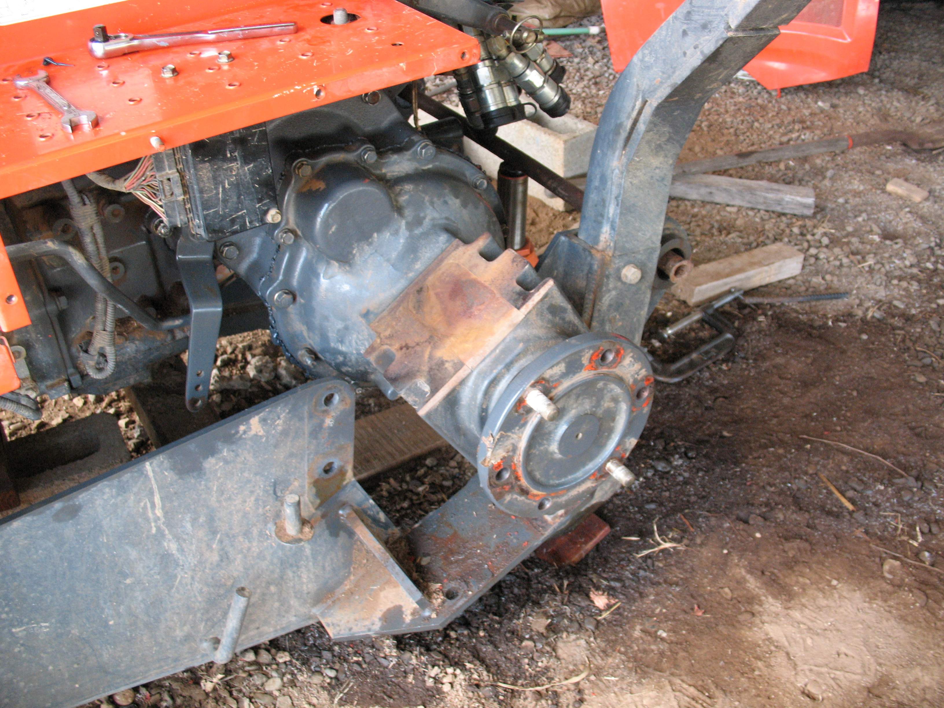

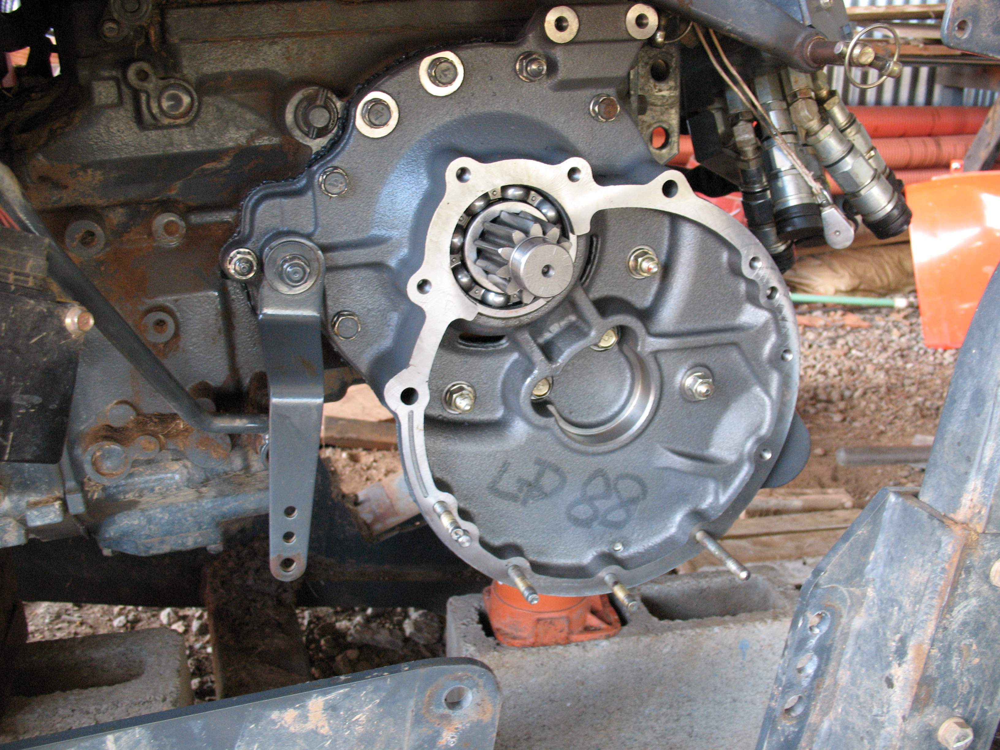

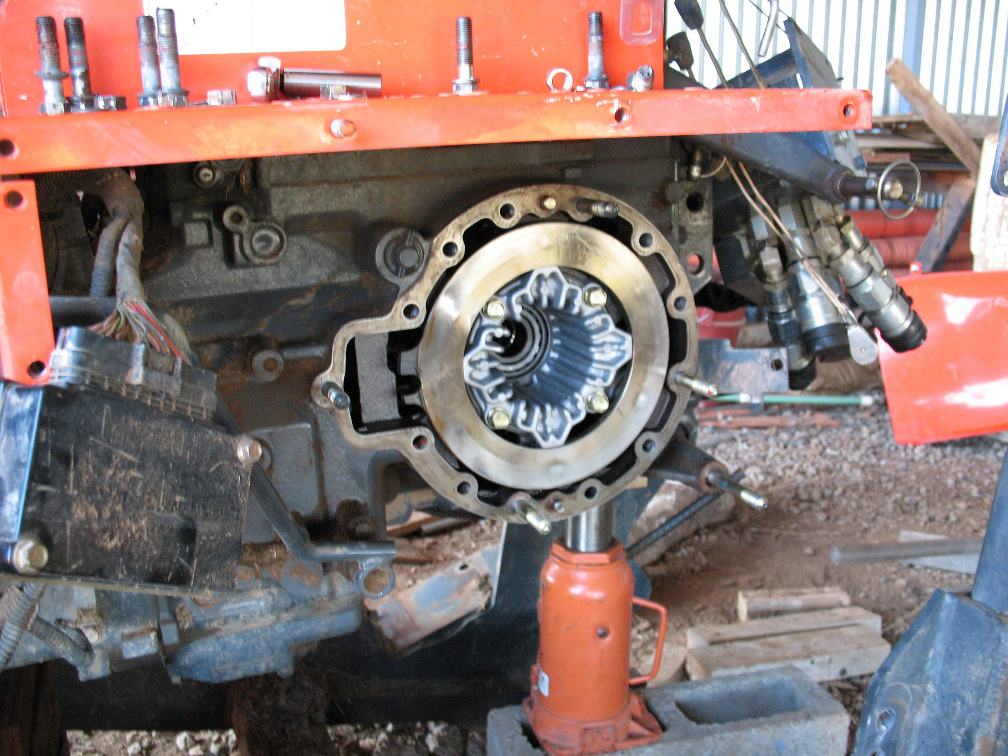

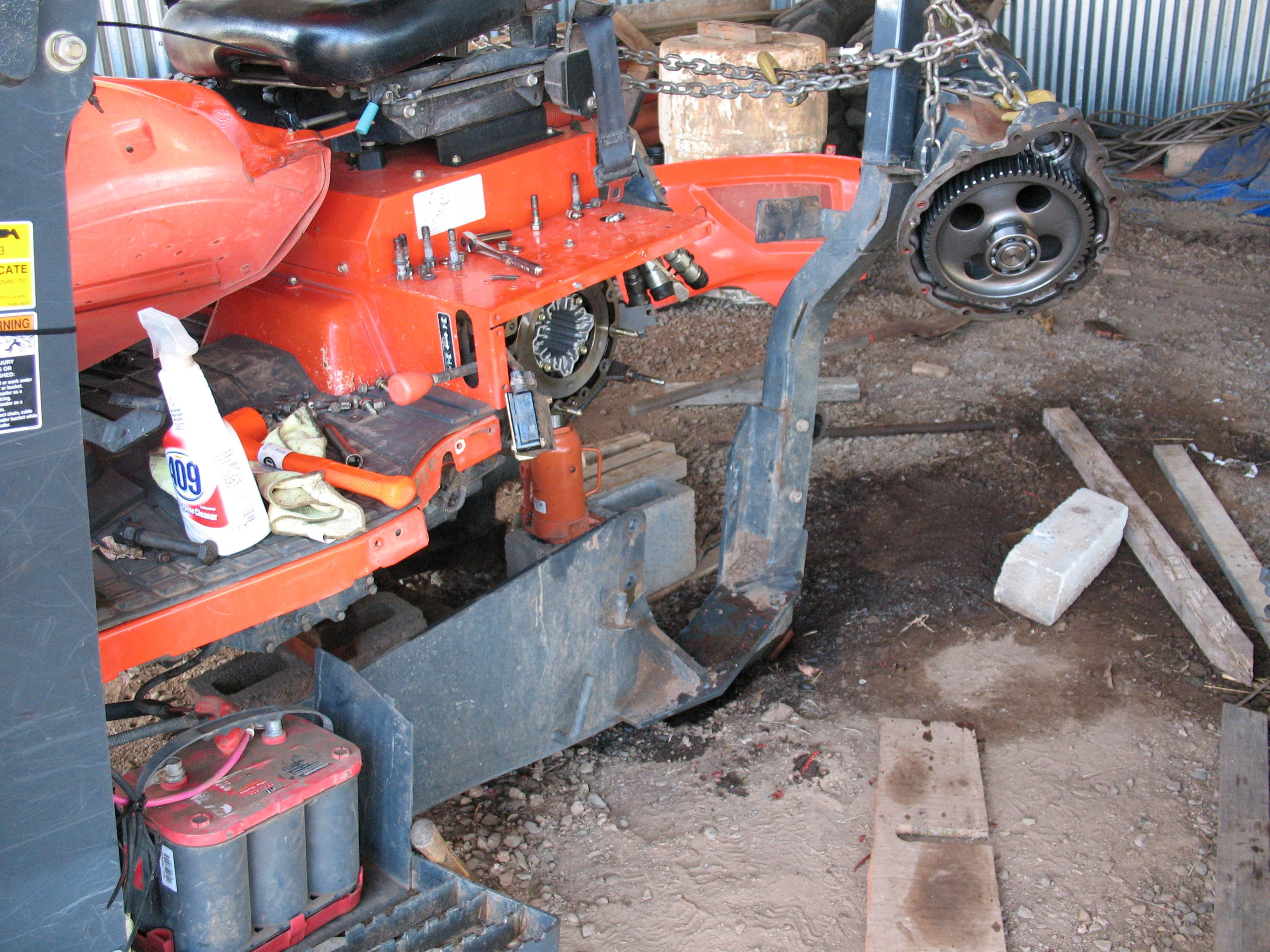

Had to replace Brake Case Housing for second time on my L-39 Kubota. While using boxblade I broke the pad eye on the housing where side link pins up. Being my second time it was a little easier this time. The L-39 has a heavy duty frame that must be unbolted and lowered down in order to first take axel housing off.Then you take brake housing off. What I did different this time was leave 1 bolt on the front side of the frame on each side and lowered frame down with a jack. Lucky my shed has a dirt and gravel floor because I had to dig down a little bit to get frame low enough. This made raising the frame easier going back up and lining up the mounting bolts.I will post pictures later
Here are the pictures of repair job.
