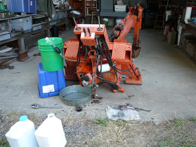

For the OP... 2ea 5gal buckets from Home Depot, 1 drill pump and some hose = fast and done.
(then use a small drip pan to get what the pump didn't)

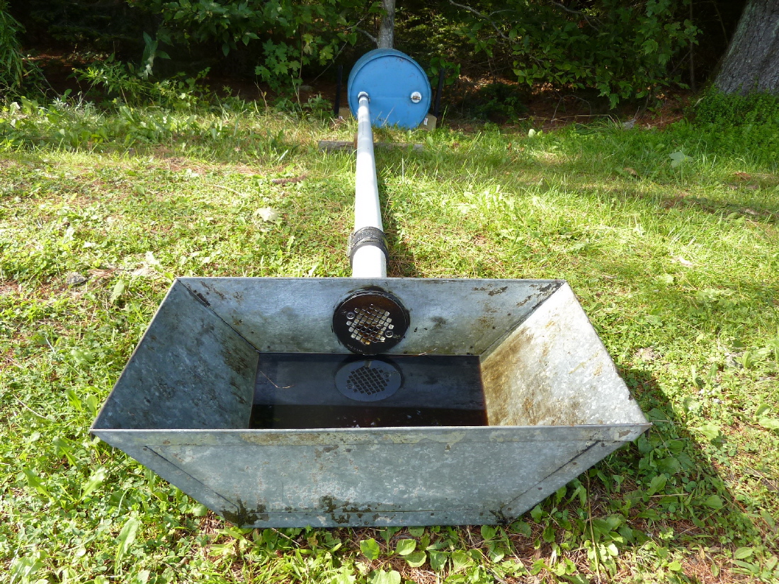

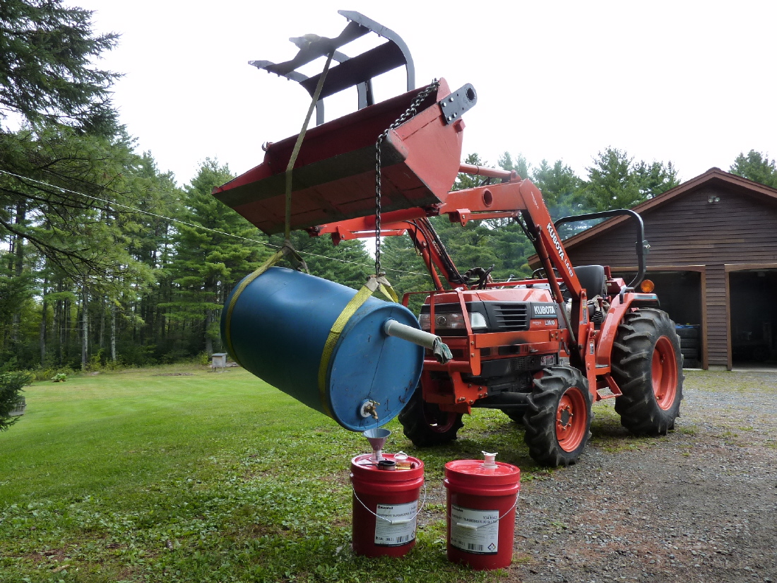

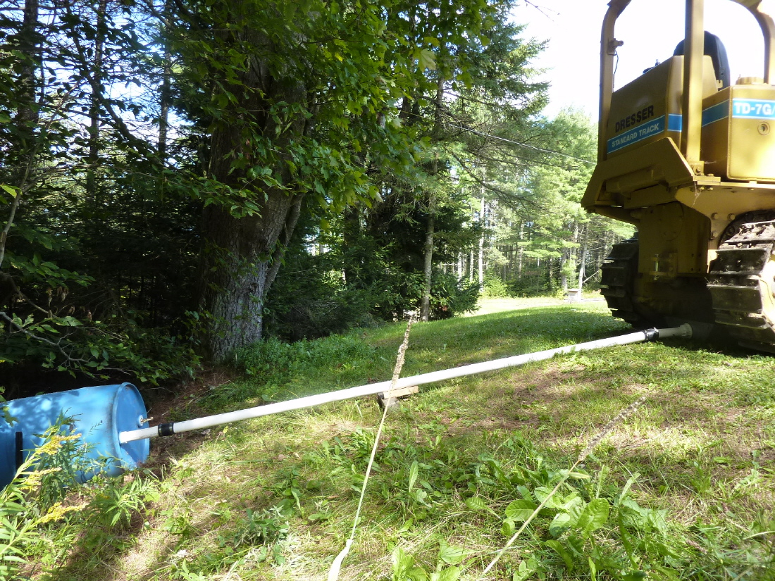

This is my method. Put a shower drain in a gavanized pan I had. 20 gal - no problem.

/ Changing hydraulic fluids - HUGE drain pans? #37
Nice setup!!
