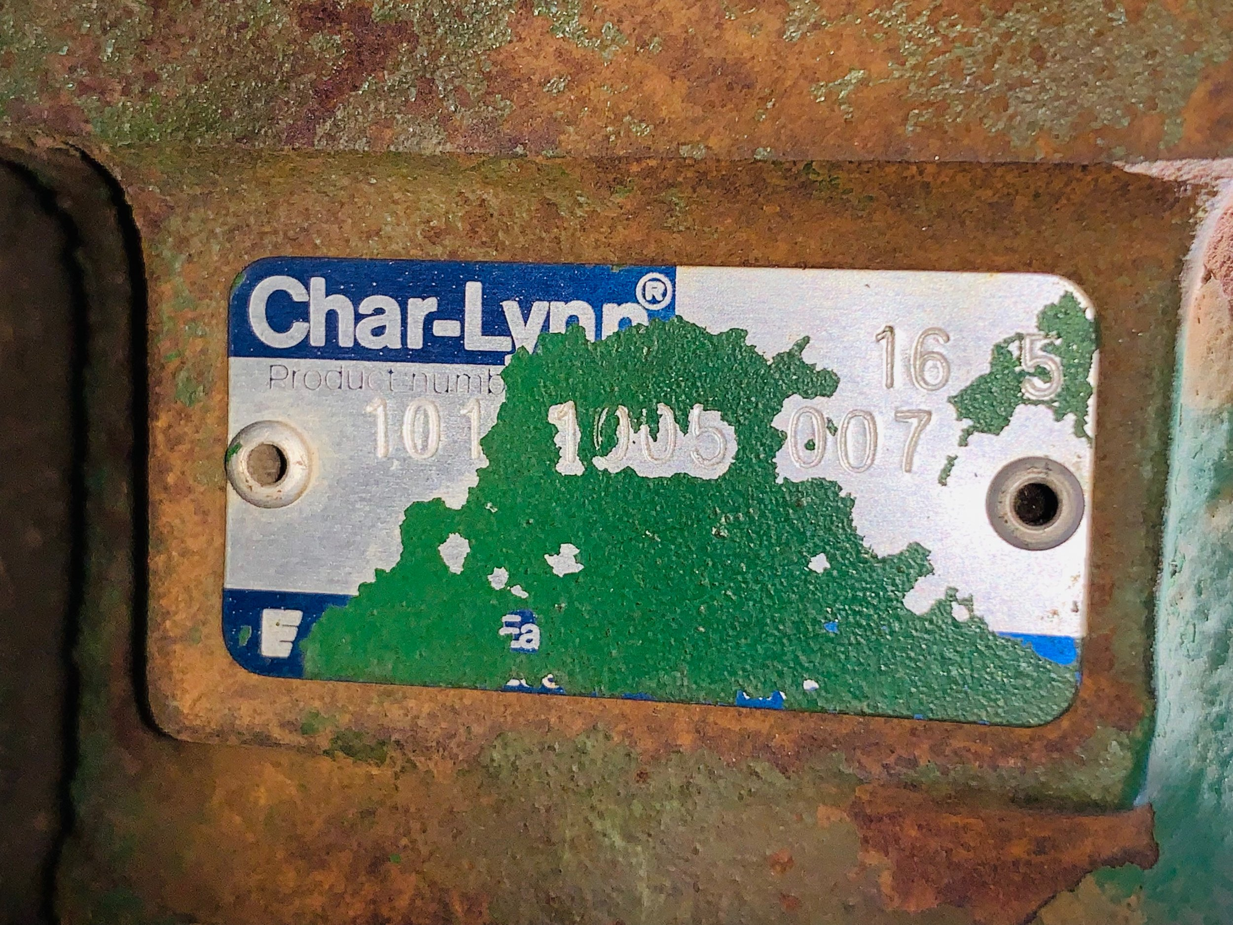

Searching the WWW, I have not come up with a definitive source for seal kits or motor replacement. I am guessing my terminology is off? One supplier states they are Buna seal kit's and others do not mention what the seal is made of. 30 years ago or so, I used to replace the seals in motors like these but that was a long time ago and the local supplier I was familiar with is out of business.
If you could refer me to a website where I can purchase seal kits and perhaps even the motors, that would be great.
What do the #'s on the motor mean? I am pretty certain that the "1005" is reflective of the gerotor size/width/thickness... But other than that, I am not able to find any information on the WWW where the #'s are explained. In addition to the Series #, in the upper right hand corner of the motor ID plate, there is "16 5." Again, I am guessing I am not searching the correct search terms/terminology.
Any direction or help you can provide is appreciated.
   / Char-Lynn H Series 101 1005 007 #2
Seal kit #60540-000
   / Char-Lynn H Series 101 1005 007 #3
Just look very close at the mounting flange, they seem to crack easily at the seal area
