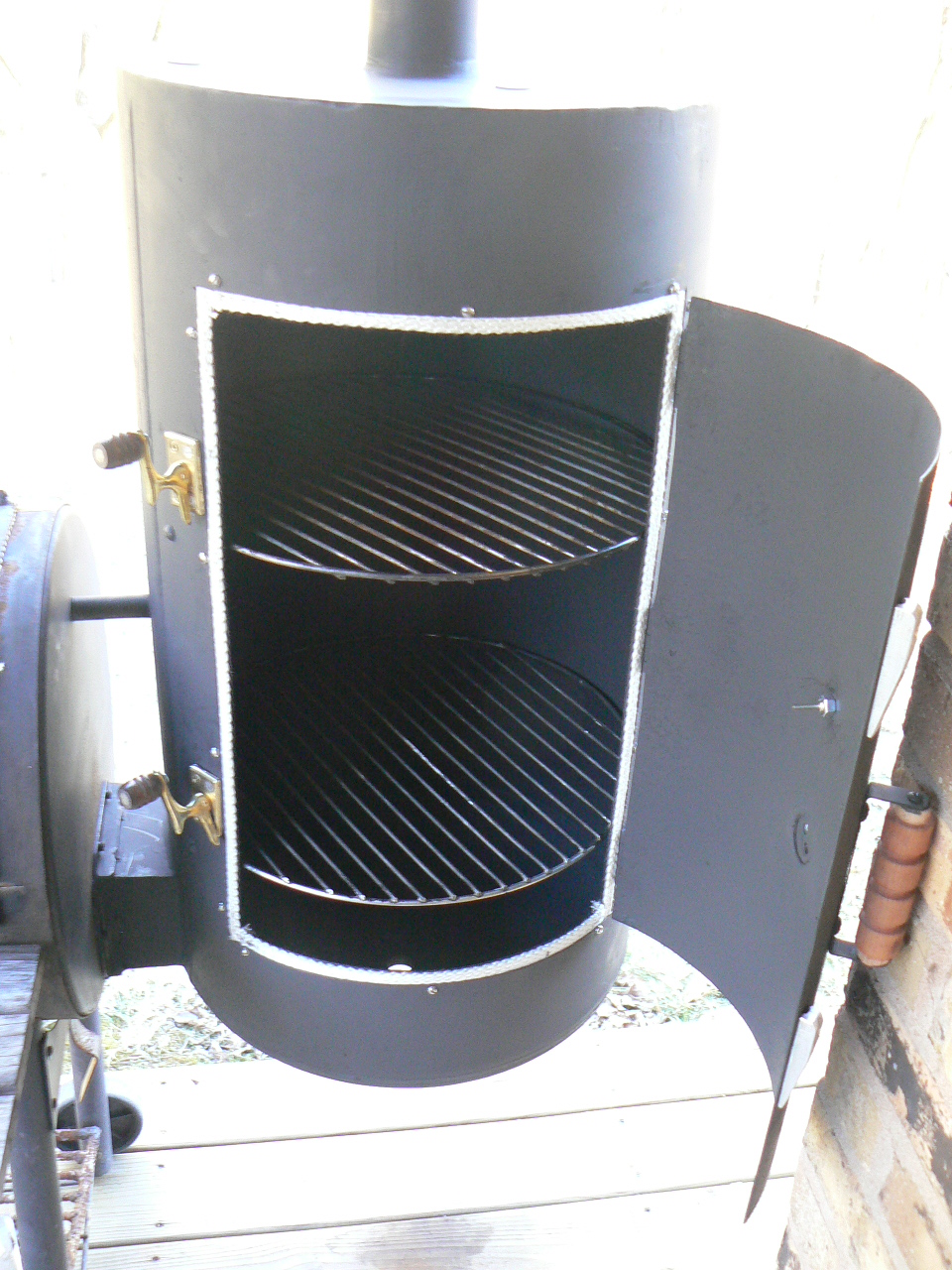

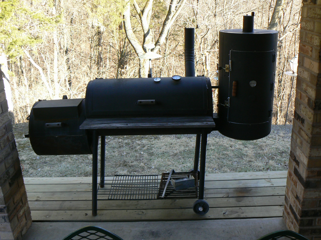

Like Cord said, it's ceramic and short of chipping it off there is no way to remove it from the tank. I used a portion of my old water heater add an addition to my smoker. You can weld to the tank as long as it's to the outside.
