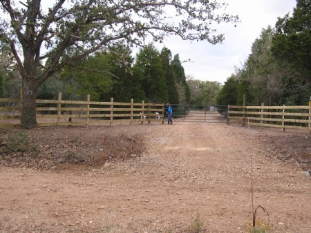

I used 4x6 's on this entry -- 4x4's I've used in the past twisted on me.... this has been up since Thanksgiving 05 .... no twist yet....plenty of shrinkage on the boards though... where I butted them up on the post there is a 1/2 inch gap on a couple of them now. I may have to reset the screws holding it on.

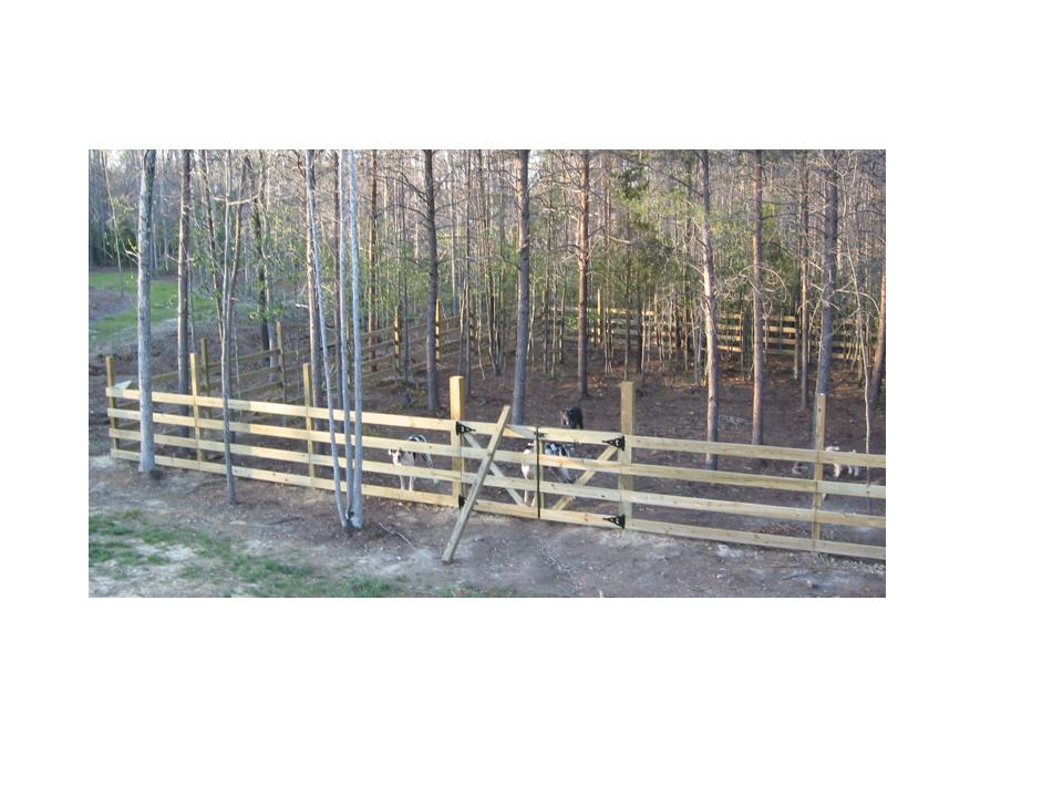

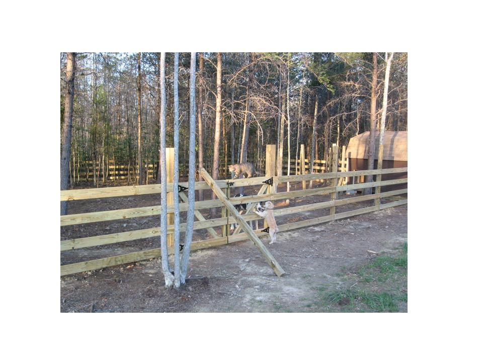

I used 4x4 for the post with a 1/2 bag of cement and 6x6 for the gate. The cross boards were 6 by 8 by 4/5. The costs were $4.50 per post, $4 per cross board so it was a little expensive but since it was beside the house I thought it should match the deck. I plan on doing a property board fence but I want to do this much cheaper as it will be out of sight. What have you all come up with for cheap posts?
