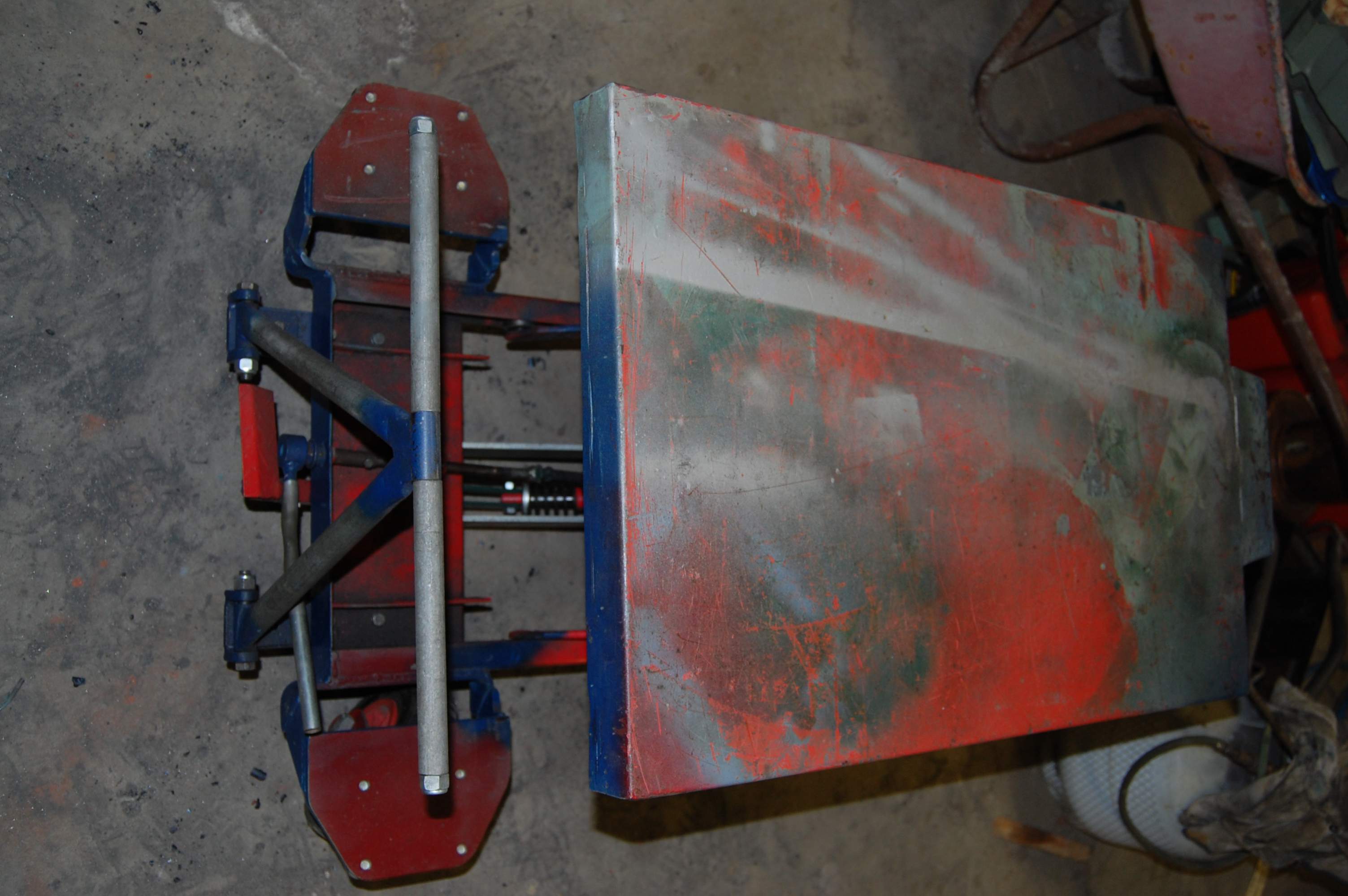

I have an Oriental hydraulic lift table, rated for around 400-pound lift. Recently, the thing refused to lift. It's one of those 'el cheapo' types. I have another, pretty much the same, and it's quite OK., and years older. So the idea is proven. The 400lb job is one of those integral hand pump/ram types, for which it seems to be impossible to source spare parts, at least not in Australia. I see long-stroke rams generally available, but no shorter types, which mine is.
I've replaced the balls in the ball valves, cleaned and bled the unit and replaced the fluid with fresh hydraulic oil.
You might say that the unit is cheap enough and why not simply buy another? Well, I've gone to considerable trouble to adapt the unit to travel over broken ground, towed behind a mower/tractor. I've replaced the original wheels with pneumatic wheels and casters of very good quality, so I'm keen to either fix the ram/pump or buy a new ram/pump. Replacing the whole shebang isn't an option.
On the bench, the ram will extend, but when set to work in the table, it won't start a lift at all. My thoughts include the ram seals, but there's no leakage onto the ram, other than a very thin oil film, which I'd expect. I can lift the table by hand, shut the bypass/control valve and the table will descend to about 2/3 of its full height and there it'll stay. I can sit on it, no problems and it'll stay up: overnight, if necessary. The fact that it'll stay up sort of rules out the rams seals, I think. There are no leaks from the pump or valves.
The ram is of a type often seen in trolley jacks, etc., but is quite a bit larger. Its operation is partly horizontal, changing to almost vertical as the table rises. To this end, the suction ball valve from the reservoir is spring-loaded, as might be expected.
Any thoughts from the membership?

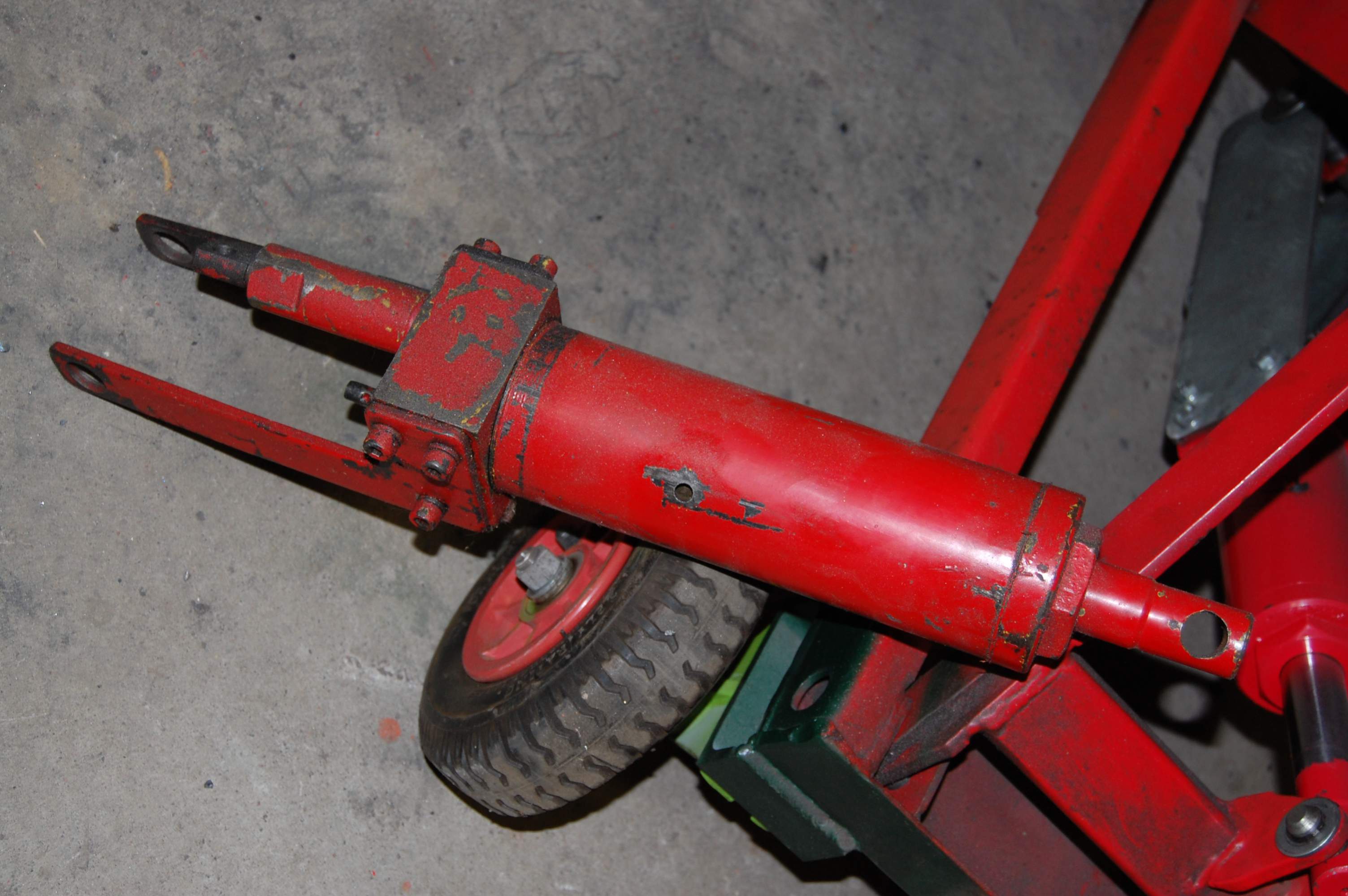

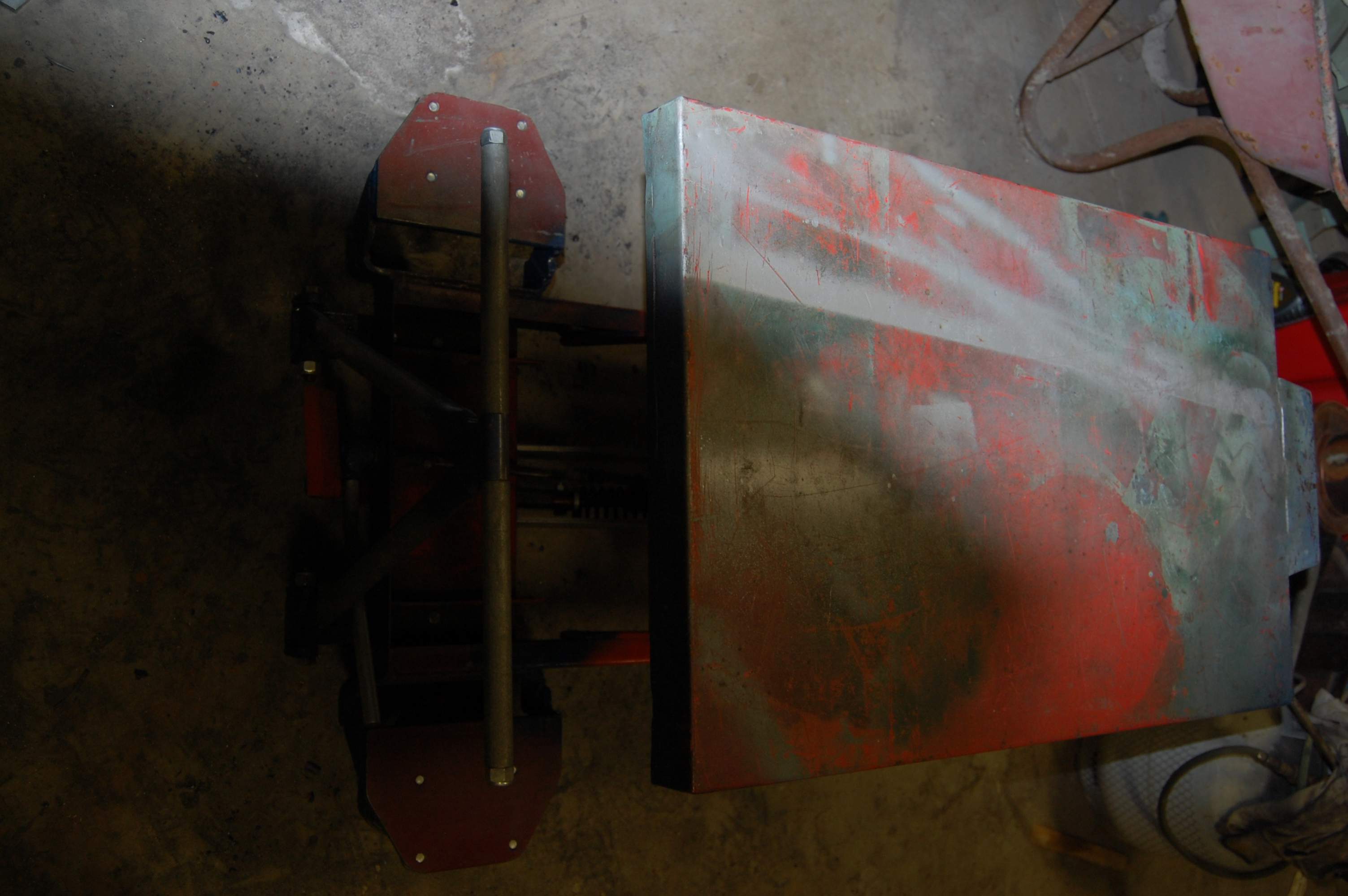

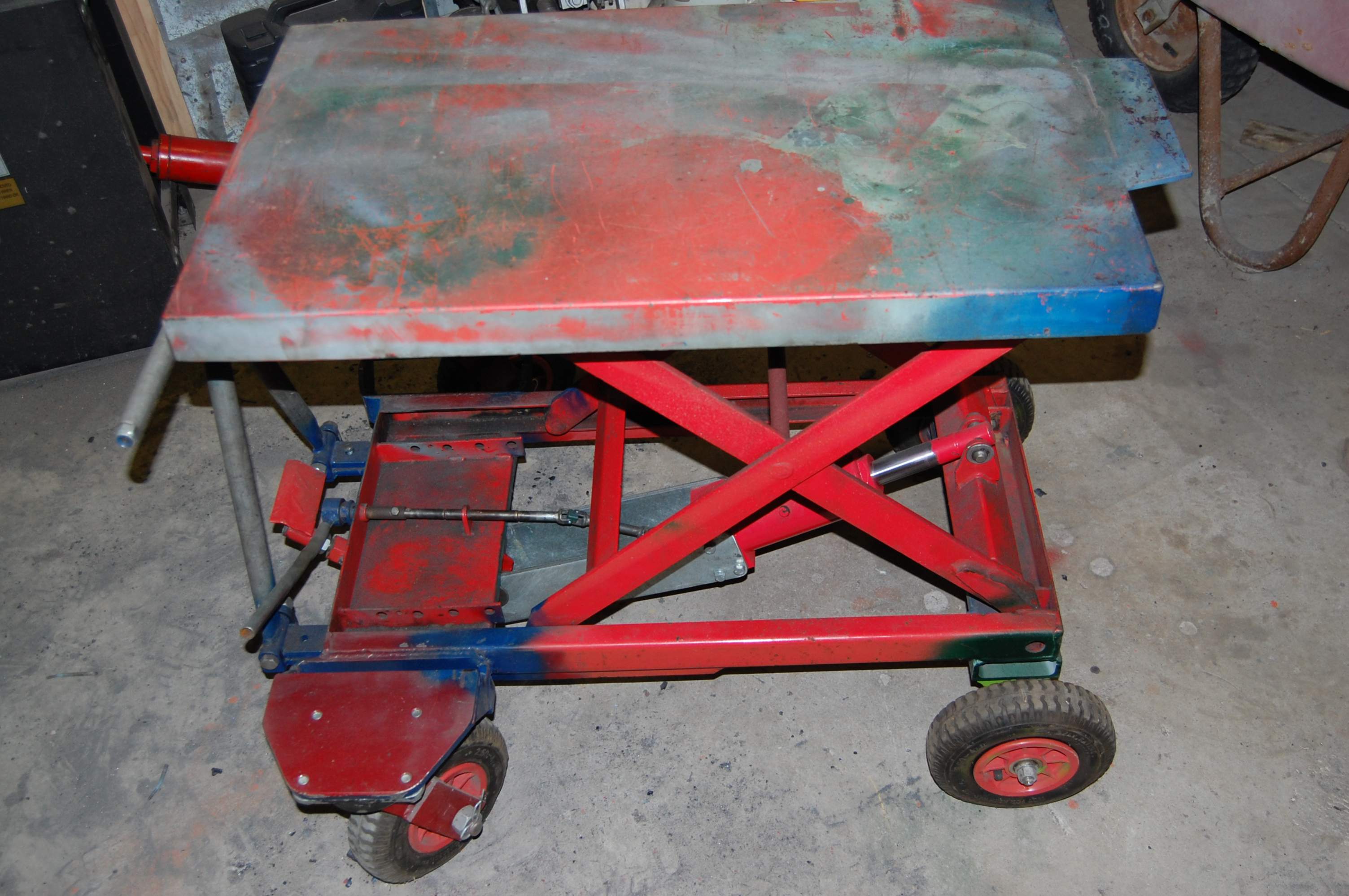

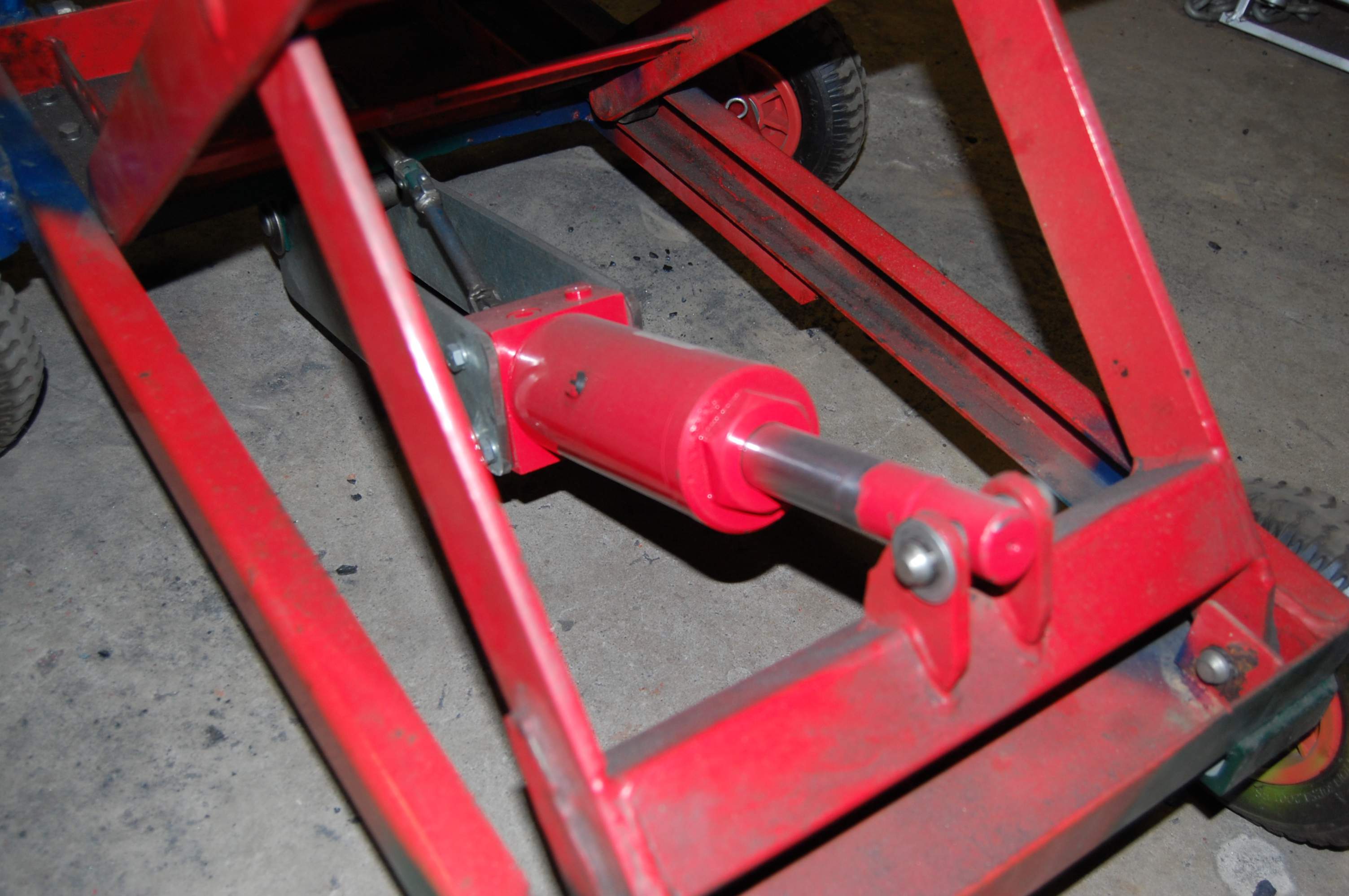

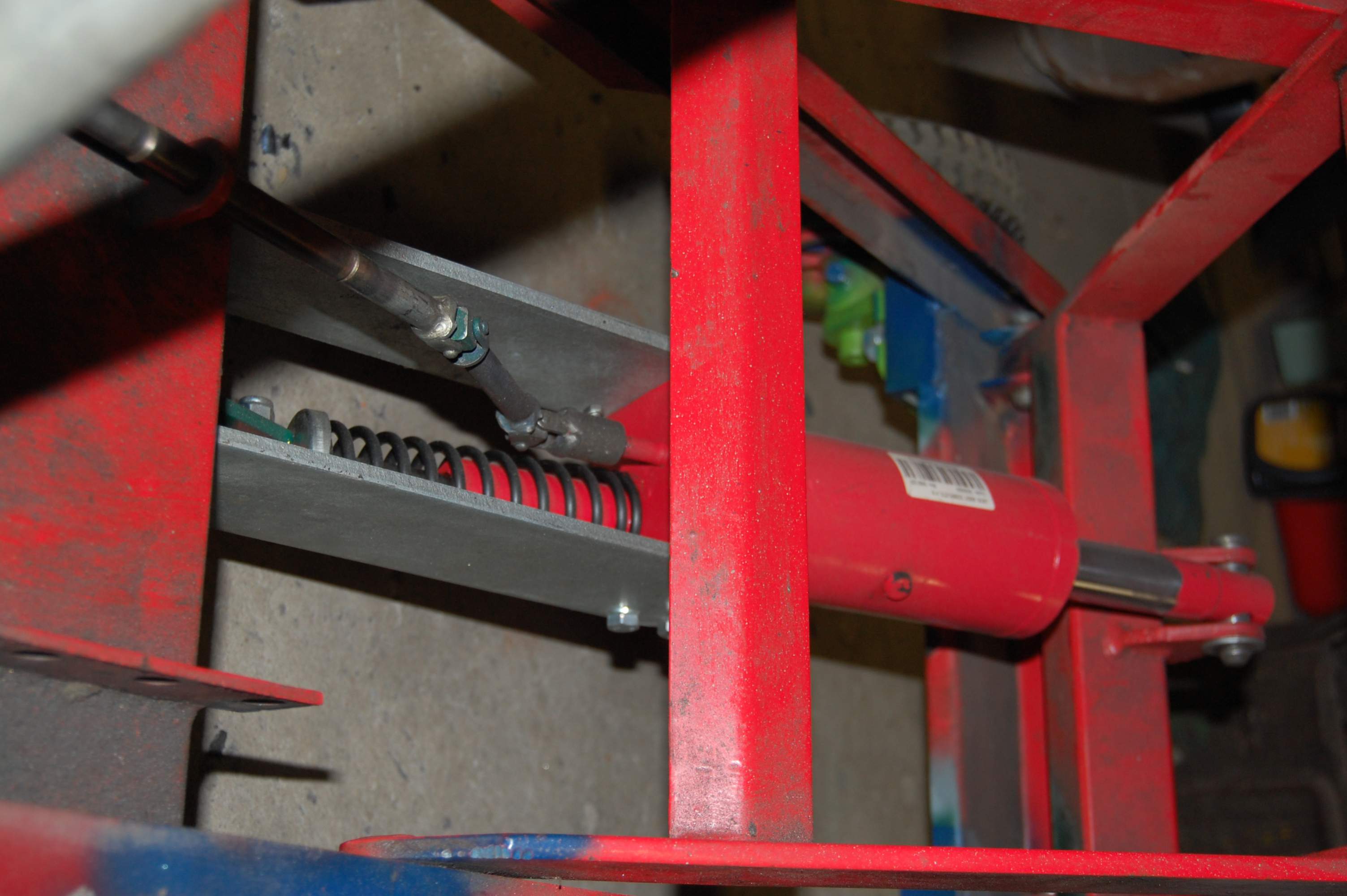

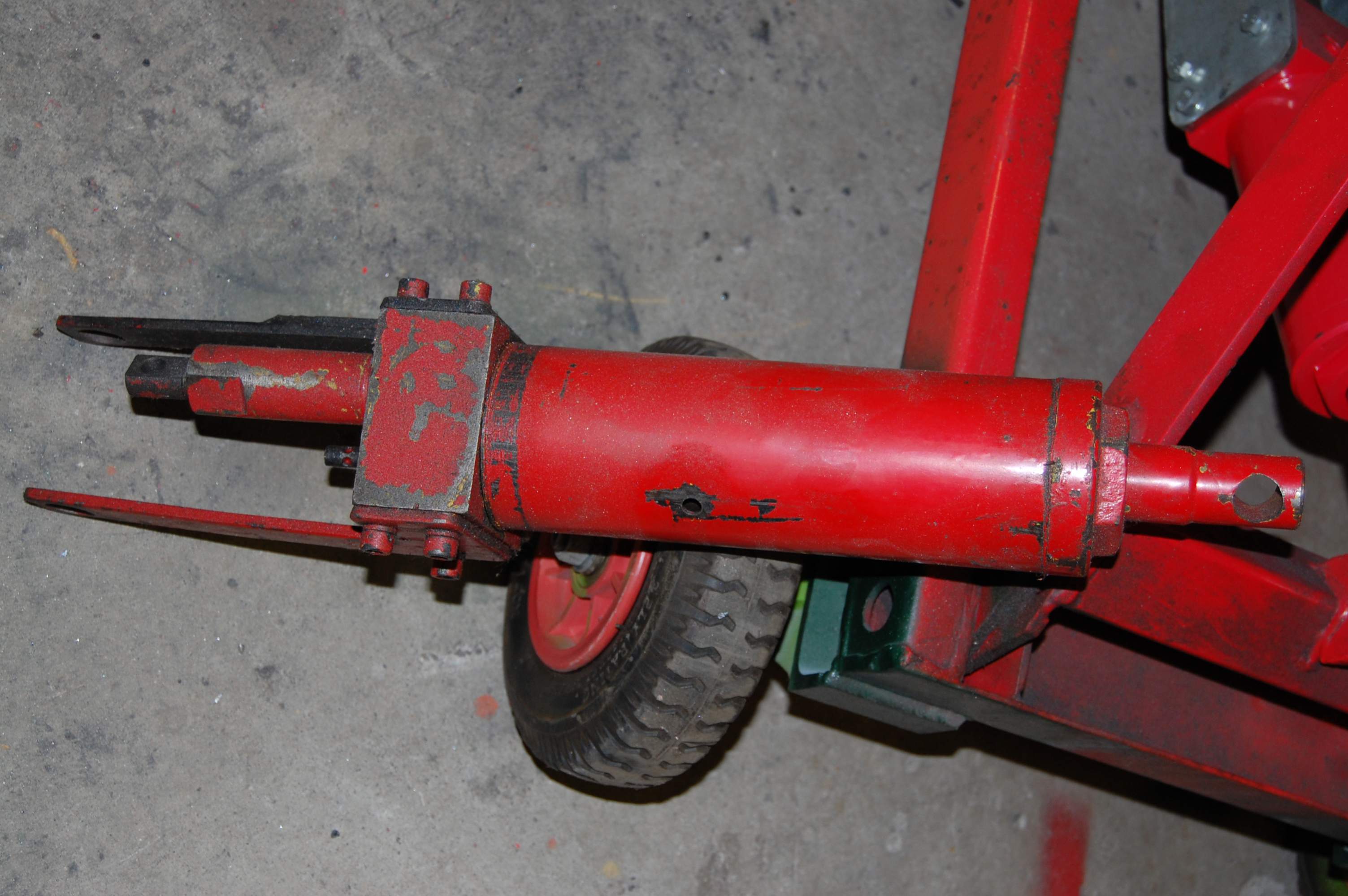

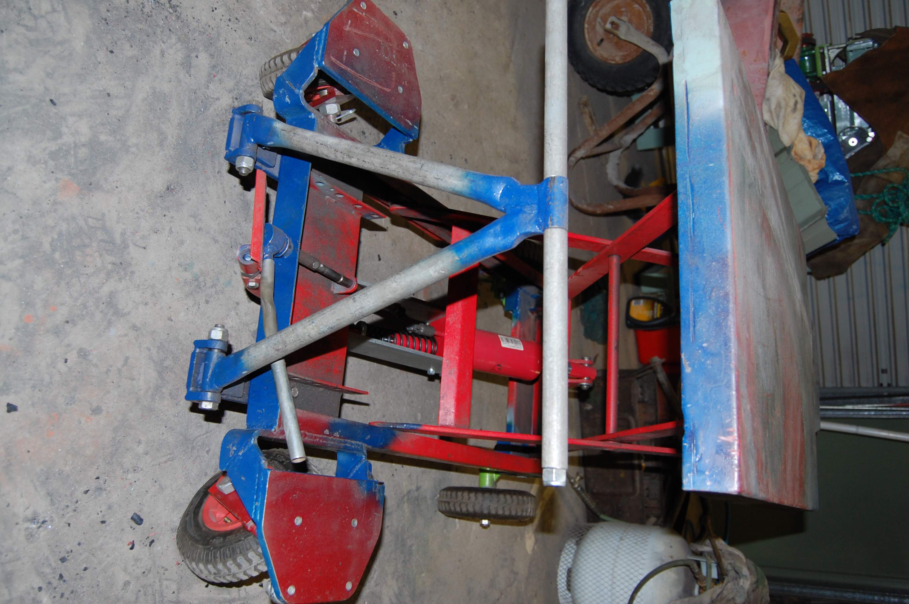

I eventually solved the hydraulic pump problem, with a visit to a distributor, where I was able to talk 'em out of the one and only spare they had and even that was from a damaged unit. They had another, which I bought also. Neither 'spare' quite fitted and there was a bit of head scratching to adapt one of the units to the table. Unit now operates in its assigned role.
To answer your questions: yes, it is a single-acting ram. There's no gauge. The cylinder and reservoir are integrated, as is the pump. Just like the ordinary hydraulic bottle jack.
I've attached some pix, which I hope fill the bill. Again, my apologies for the silence... DSC_0765.jpgDSC_0766.jpgDSC_0767.jpgDSC_0768.jpgDSC_0769.jpgDSC_0770.jpgDSC_0771.jpgDSC_0772.jpg

I looked - I thought thoroughly - at the ball(s) and seatings and in fact, I replaced all the balls, with what I KNOW to be stainless balls. I also replaced the fluid. In the pix, the 'old' ram is shown leaning up against one of the trolley tyres. Maybe you might notice the difference between the rams: the 'new' one is shorter, having a shorter stroke, which needed me to fiddle with the geometry of the lift arms and also to fabricate a new pair of brackets for the ram support, at the side of the ram. The new ones are the galvanised pieces you might notice in the pix.
What bugged me, though, was the attitude of "just chuck it out and buy a new one", meaning a whole new trolley. All that was needed, at any stage, were the very simple seals or, failing those, a replacement ram. But it was all too hard. The throwaway society is alive and well.
