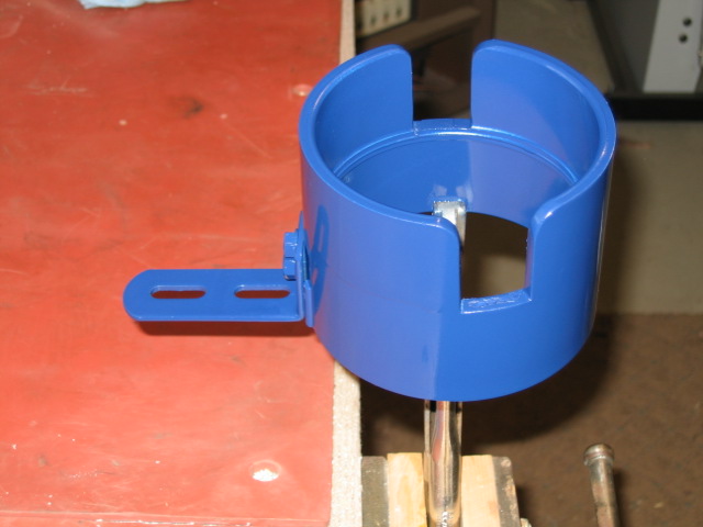

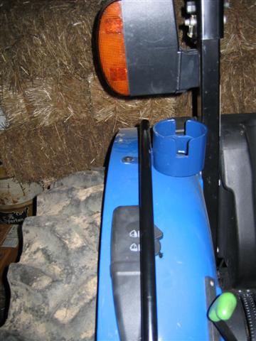

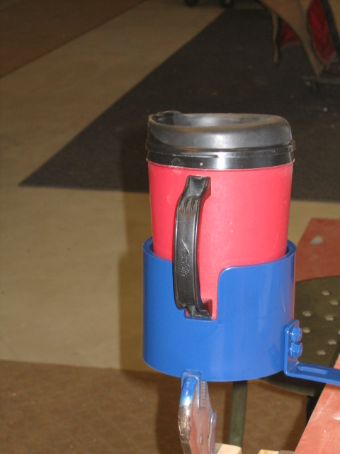

Walt
Here is another practical use I have for 4in PVC conduit coupling. Have this one on my tractor, and one in all the vehicles. ALL the cups from just about anyplace fit, and it has very little tipping, or spillage problems.
2 best things! It works great! And its CHEAP! :D Dosen't get any better than that.
