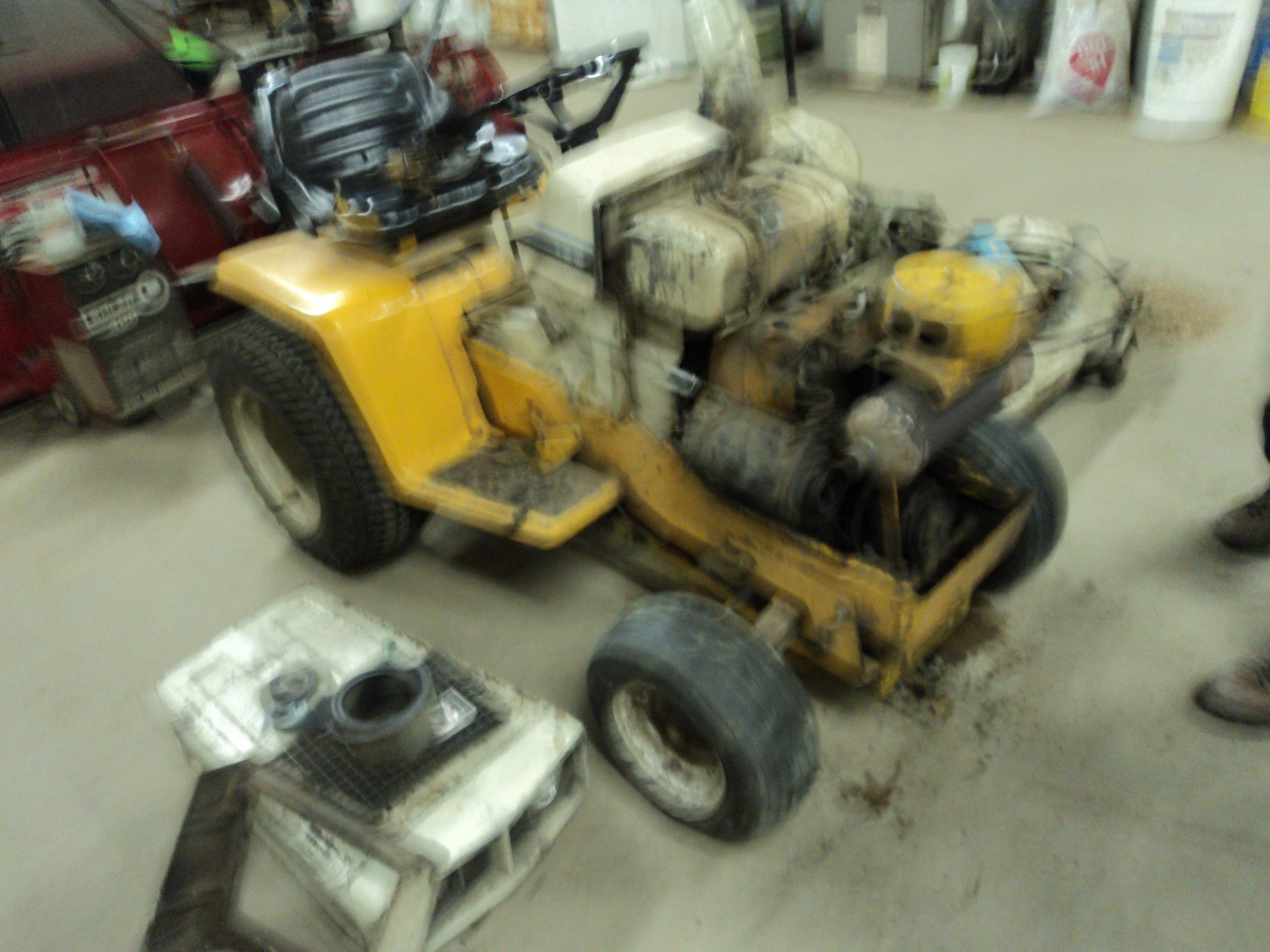

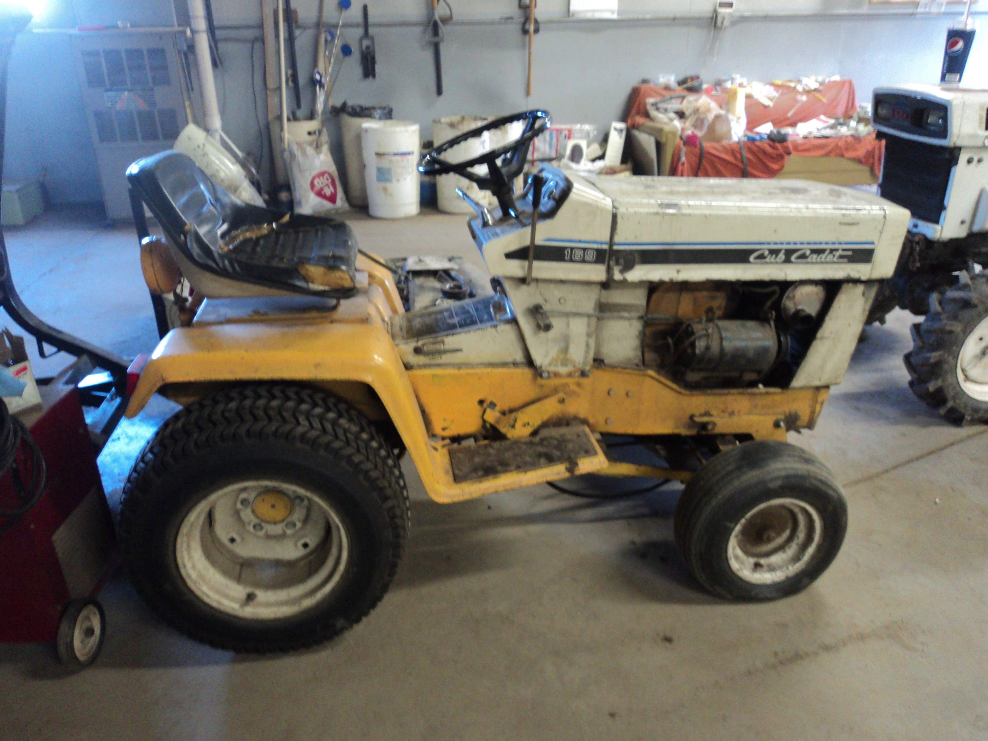

hey i bought this cub cadet 169 this weekend for $375 with a snowblower and a deck. it will fire and run for a few seconds and then die. i took the carb off today and am gonna get it cleaned. the deck and the snowblower look to be in working order but they need a little work. is there anything that i should know or you think would be helpful to me. any help is appreciated thanks.

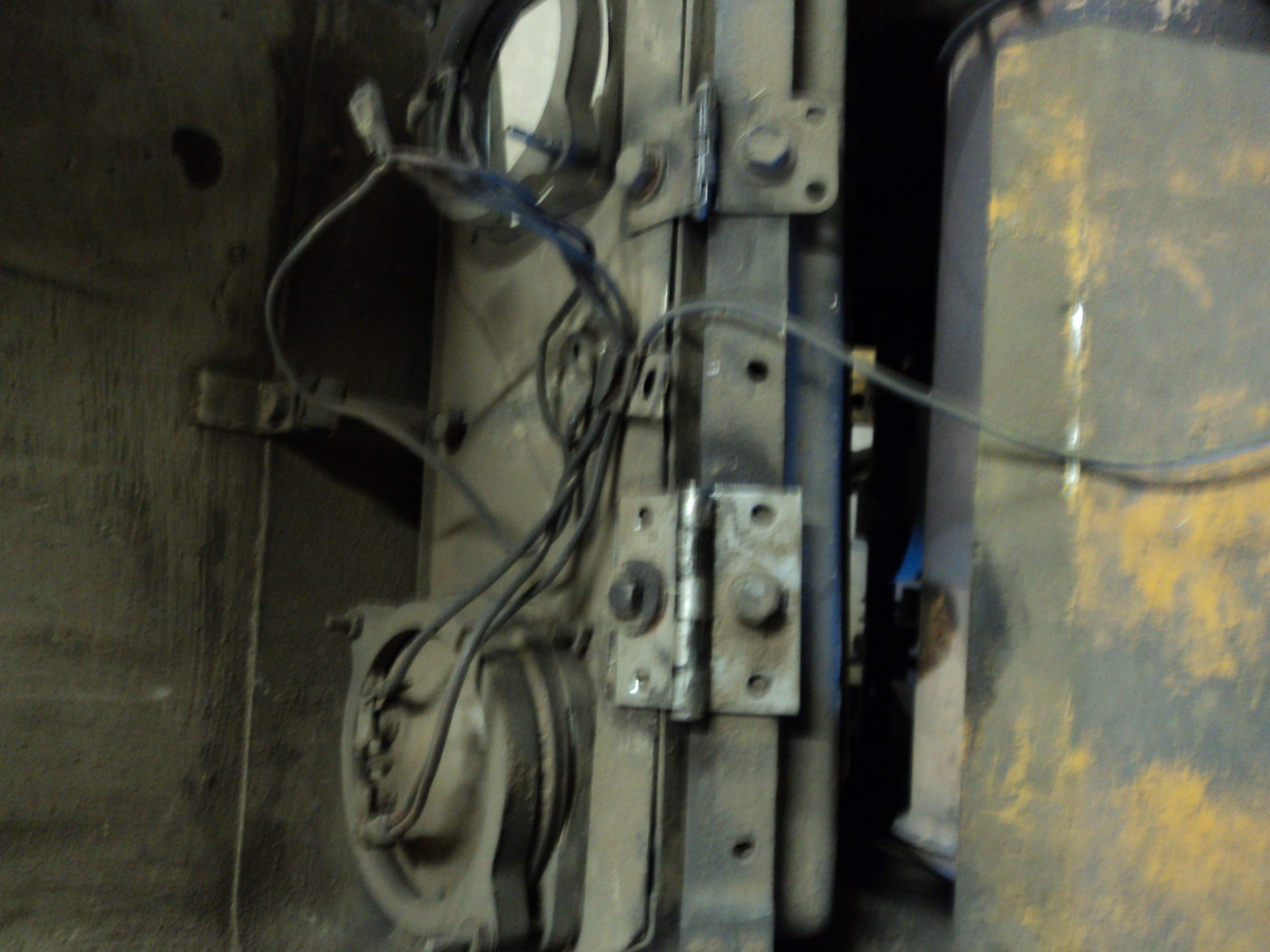

also if anyone has a picture of how the hood hinge is suppose to be please post it this one is kinda cobbled together and looks goofy when the hood is closed. thanks.

Check fuel bowl vent, needle and seat and float closely. Also check the fuel supply line all the way back to the tank and the fuel pick up in the tank.

i am going tomorrow to get a carb rebuild kit for it the one bushing was completely disinegrated and i have some fuel line im gonna drain the tank and put new fuel line and get the tank lined probably

got the carb rebuilt and put back on today and she started within five seconds. i put the snowblower on it and it only lifts up like a 1/2 inch is this normal or is there something i am missing.
The hood hinge is supposed to be a piano type hinge. I have to replace the one on my IH129 every couple of years. Watch for the HST lever when you go to operate it. Put the palm of your hand on the dash or you will get into a forward /reverse carnival ride. I have watched the wife and my son do this when they tried to operate mine. Most parts are still available for these through a Cub Cadet dealer. PM me a e-mail address and I can send you some helpful info on that machine.

What year is that? I had a new one that looked like your's in 76.
I beat it up for about 12 years went though 2 clutches and a motor.Other than that it was a tough machine.

Thanks dex will do and i am unsure of the year on this. i dont know if it would tell me on the serial number or not. also i am supposed to be getting the manuals for this soon so maybe that will have some info as to what year it may be.

I think its around a 1972 =or - if I remember right. I have had my 129 for 12 years or so. I got it the 12 HP Kohler had engine problems. I found a crate NOS 16HP Kohler engine for a cub cadet. It has been a tank and still runs good but is ready for a refurb. Not the engine just cosmetic. They are not throw aways.
