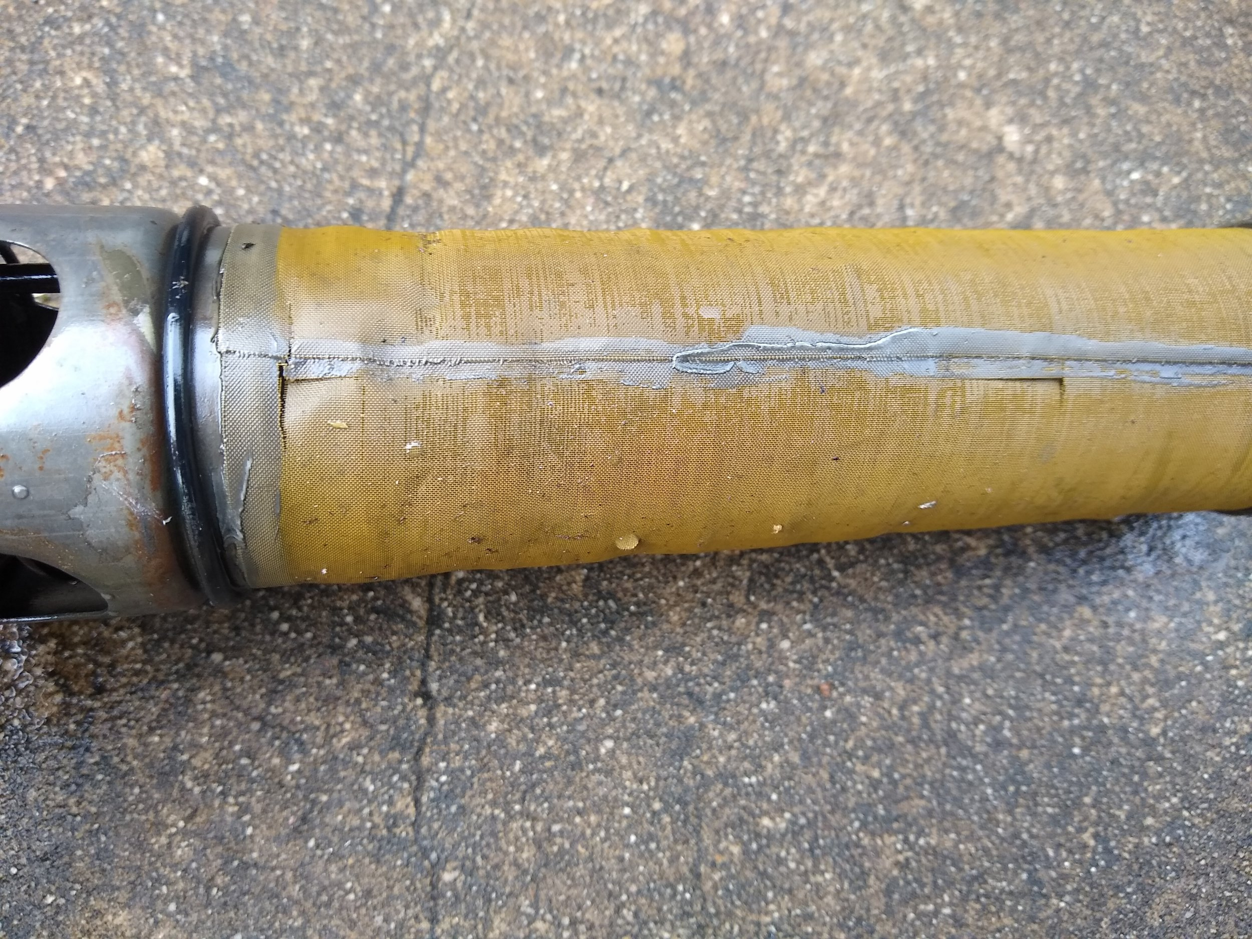

I went to change my fluid. It's not been 500 hours but that would take me forever to get that many hours on it. It's been quite a few years since I changed it. Full change maybe 12? I did partial changes I believe or either drain and refills when I did axle work I believe. But this thing works hard in the 90 to 100f summer hear bushhogging and it was cheap fluid so I decided to change it. Actually been on my list for years now but we know how that is. Anyway pulled the filter and it has several tears in it. Wasn't really dirty, some debris on it but not bad. But the main seam was coming apart in a place or two and several other spots it had a few years. I know when I initially hot this tractor it had all kinds of crap on it when I did a fluid change. I rinsed it clean with diesel and reinstalled it. I DO NOT remember these tears then. I noticed them first thing as I pulled the filter out so I don't know why I wouldn't have noticed them going in when I reassembled it last time.
So if I was you and it was an original and it is something you been meaning to do I might do it sooner than later. Apparently that brass or stainless mesh, whatever it is, has a finite life on it and I surpassed mine.
I will get some pics today when I get home to post....no I'm not patching it just getting another from Hoye!

Here is the pic of my screen. Several tears along the main seam and then a longer one where it connects to the housing.
