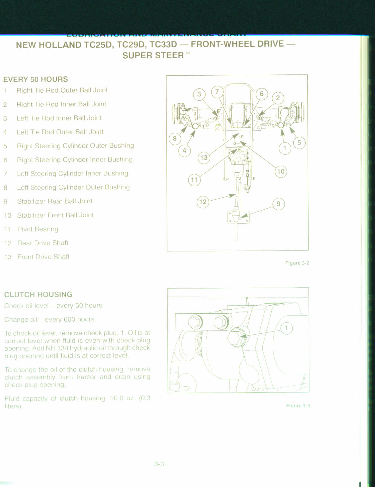

On page 3-3 of my TC29D manual it shows how to check the Clutch Housing oil level. I can't find this anywhere. Is this only for the Super Steer? It's not clear if the whole page is for Super Steer or just the top part of the page. I'm attaching a scan of the page. It's low resolution because normal resolution was too big to attach, so I hope it's readable.

Mosey, that looks like a PTO clutch to me. The instructions say to drain the oil in the clutch, you first remove it from the tractor. I can't imagine any other type of clutch you would remove to drain the oil. That is just my gut feeling. I really don't know for sure.
   / Checking the Clutch Housing oil level #3
Yes everything on that page is SS.
Saw that in my book too.
Only problem I see is u have to take off to dump old oil out:(

OK, that would explain why I can't find it, since I don't have Super Steer. Why does Super Steer have this clutch?
   / Checking the Clutch Housing oil level #5
I assume it is the Sensi-trac unit.
The extra part of the $900.00 option
In auto 4X4 it locks up front drive if rear wheels slip but can still
drive on hard surfaces.
It has a disconnect lever (back lower left of seat) if roading tractor.
