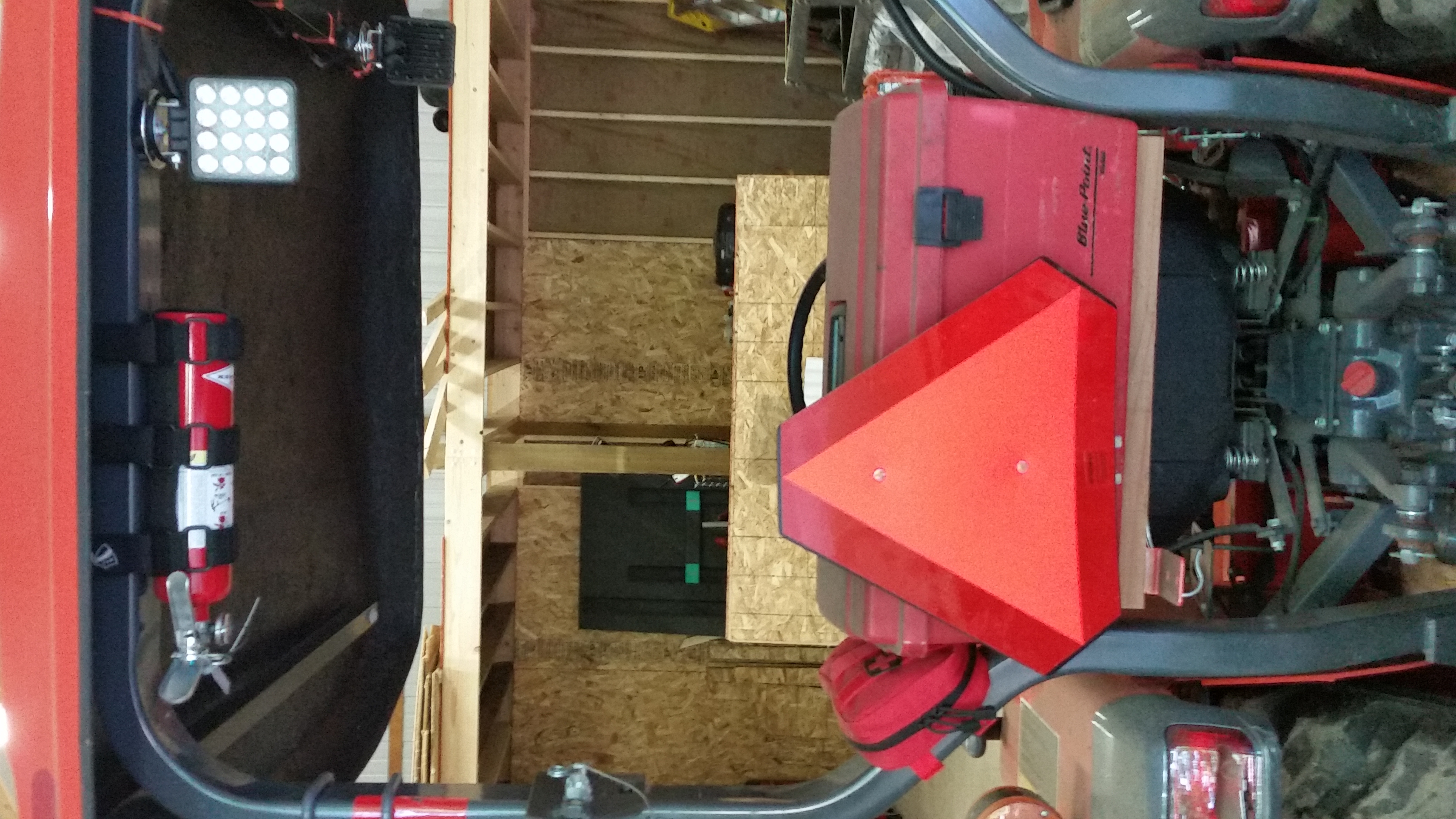

I have a chemical one on the tractor, but a water one makes good sense while out in our woods. Will have to look into how to mount one as out of the way as my current one. 20180717_140611.jpg

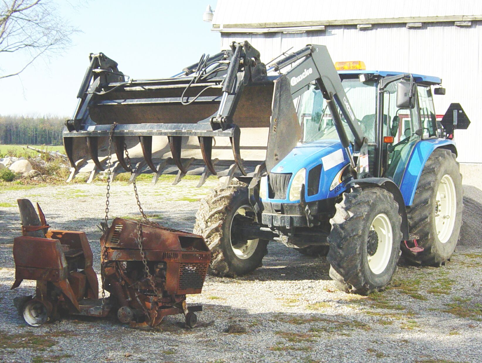

I see the op has a Ventrac. I have a totally burned out Steiner which was given to me. They had made a brush fire and realized it was under utility cables at which time they tried to push the pile away with the Steiner.
The fuel line goes under the machine at the articulation joint in a sock, probably just ready to catch fire. That fuel tank will empty when the line is burned open. By the time the Fire Dept got there, there was nothing left.
This WAS a Prestine 430 MAX Diesel with dual wheels!
