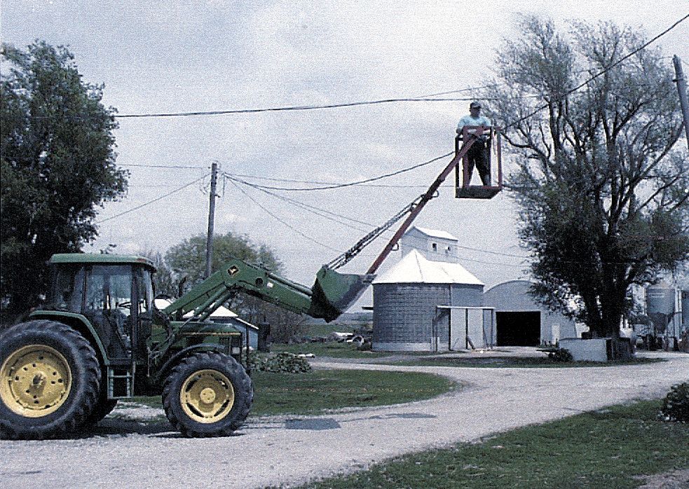

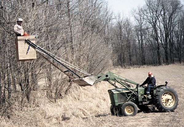

Old thread but I'm looking for something similar to limb up very tall trees with my DH. Here are a few articles & pictures that I found from folks that made their own attached to the front bucket. I can't find any pre-made but would love it if we could. These seem to be two-person jobs with one person in the tractor and the other person in the bucket cage.
