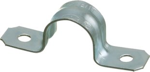

I made a 6.5' x 20' hoop house to cover my boat. Base frame is 2x4s and has 1/2" EMT conduit hoops every 2' (I have a tubing roller). 10' x 20' tarp secured over that keeps the rain and snow out.

Hoops are attached to the 2x4s with two of these 2-hole straps at each end of the hoop:
