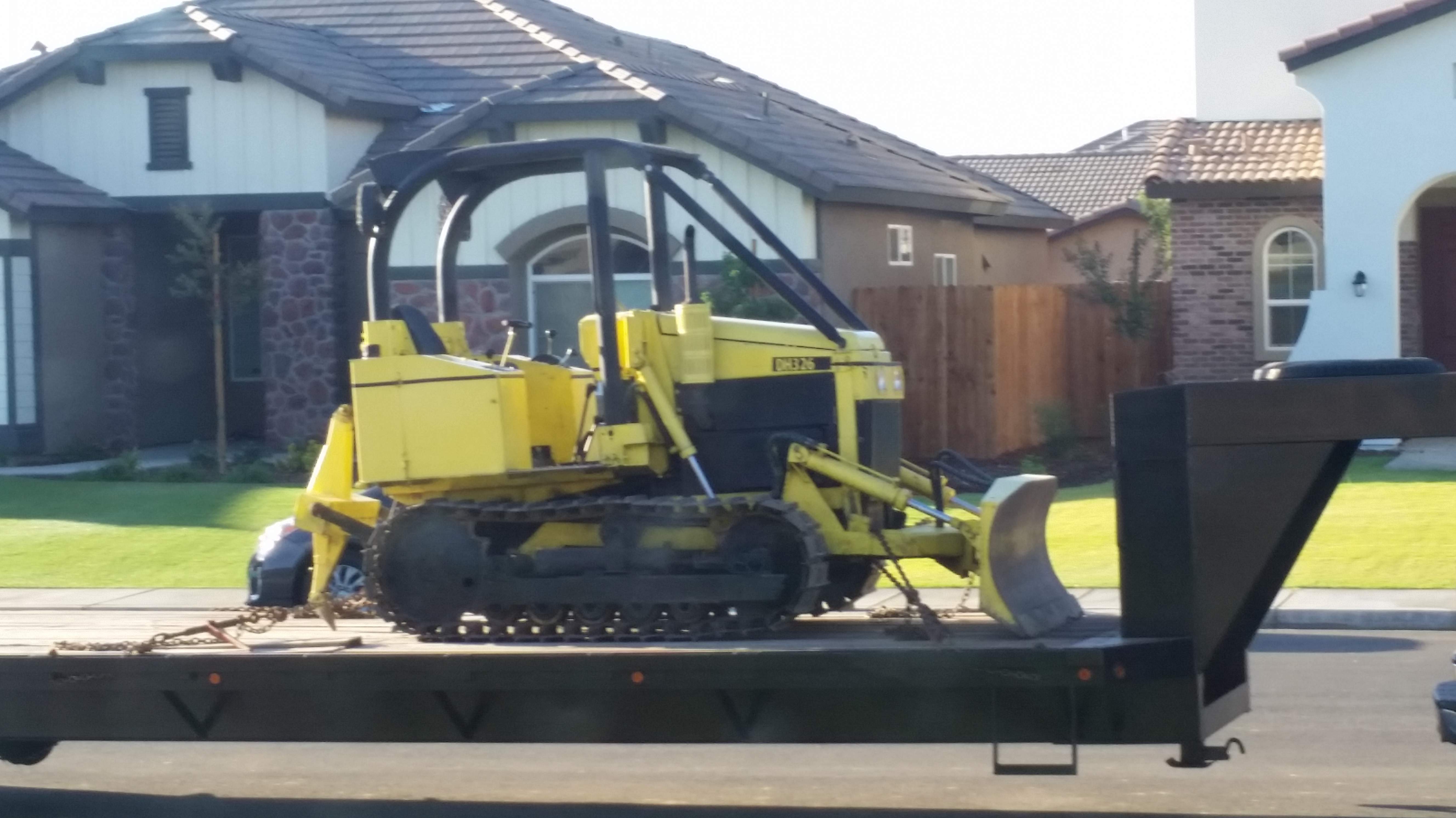

Hi, new to the forums was hoping someone could help me out with a little info on this china dozer. Ill start from the top, only had it about 3 weeks now not sure what the make is. I believe it is Yuachi, looks like someone repainted it yellow and black to resemble the dh326. Started pressure washing it and found out the undercarriage was blue at one time. Anyways i belive the motor is trash it has a ty395e3 and engine plate says its an 2004, thought it had an injector knock when i bought it turns out it was a little more than that. After getting a decent engine manual i relized this thing had been tinkered with. Pulled the injectors took them to diesel injection services in colton ca had them cleaned up and tested, put them back in didn't fix it. Pulled valve cover to check valve lash and found pieces of metal everywhere. Was going to pull head off but can't get it off, yes i double checked and all 11 head bolts are out, hooked a chain to my forklift and broke lifting eyes that are bolted to head (it tried to pick the dozer off the ground) not sure what the problem is other than i bought a basket case that some guy jb welded the head on...There are other things that are wrong as well, like it didn't have a thermo stat also one of the glow plugs broke off in the head. I think it must be part of the piston rings or part of a bearing that i found, i also sheared a water pump bolt off in effort to get the head off. I am going to try and get a little deeper into it this weekend but was just weighing the option on a rebuild or a new engine. My question is will a ty395I work in this dozer? I belive it is the same engine minus the emission controls and different fuel injection but are the blocks the same? Will i be able to swap my engine with that one? Only asking because i talked to a dealer and they told me they quit making the ty395e3 7 years ago. I found a good deal on a ty395I that i would like to use but not sure if it will just bolt in. Thanks

A pic of your machine would be a great help.

Thank you for the information Bob I will check the side of the block for that! Let me get to work where i can down load the pics, i cannot figure out how to work this **** MAC Computer. But thanks again!
