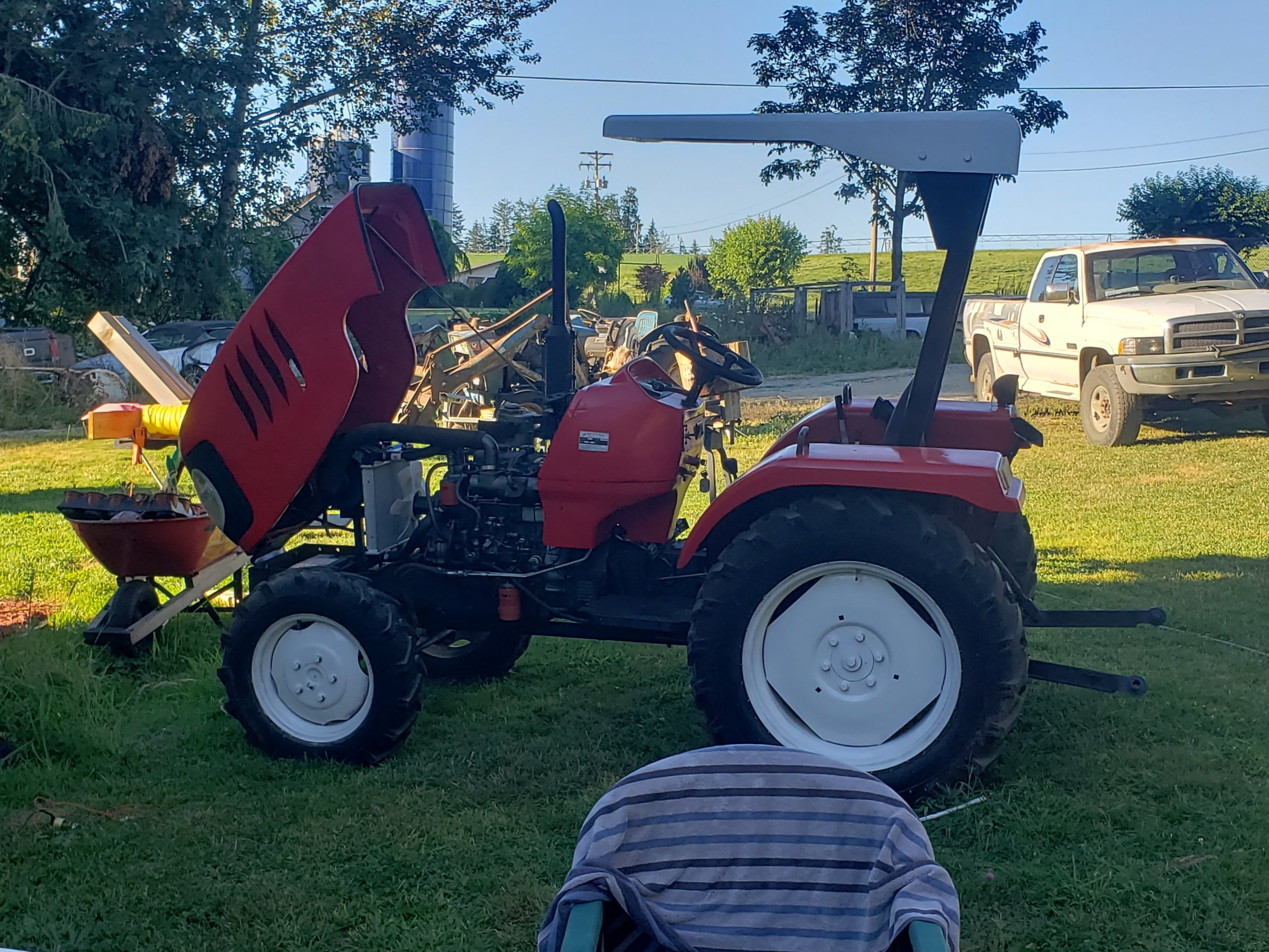

Hi every one, my next project is a Chinese built shandong engined tractor it has 31 hrs on it and we rescued it from a field, it is a 2012, that was abandoned in the first 6 month's due to a busted rad. Some more back story we brought it home checked fluid levels, replaced diesel and bled all injectors, and cranked it, after a wif of either it fired right up and idled perfectly. After we reved it up it tried to run away. I found a spring loaded plunger that returns the fuel rack to center was gunked up and after cleaning it the tractor has run flawlessly. So I changed all the fluids, trans, engine, hyd and power steering (80-90 trans 15-40 engine and aw 32 for ps and hyd). The power steering has a seperate pump and after a few laps of the yard started to work again and keeps getting better. ( was functional at the start but after draining all fluids I think still has some air in it) the 3 point took about 5 seconds in the up position then lifted, and lifts my weight no problem. However when I hooked up my brush how to try giving it a good run it wouldn't lift it off the ground. Its sized for a 25-45 hp machine and my ford 1700 has no problems with it. i frequently throw my big tool boxes on it and use it as a carry all on that machine. Flow controll valve tried at closed, half and full open. It is trying to lift it but it sounds like its just blowing past the pressure relief valve. My questions are does any one know where the PRV is in these machines and is this a good place to start looking? Was aw 32 a good choice? (Vancouver island b.c can) and does any one have any Chinese tractor ownership advice for me like Where's a good place to order parts if I need them?

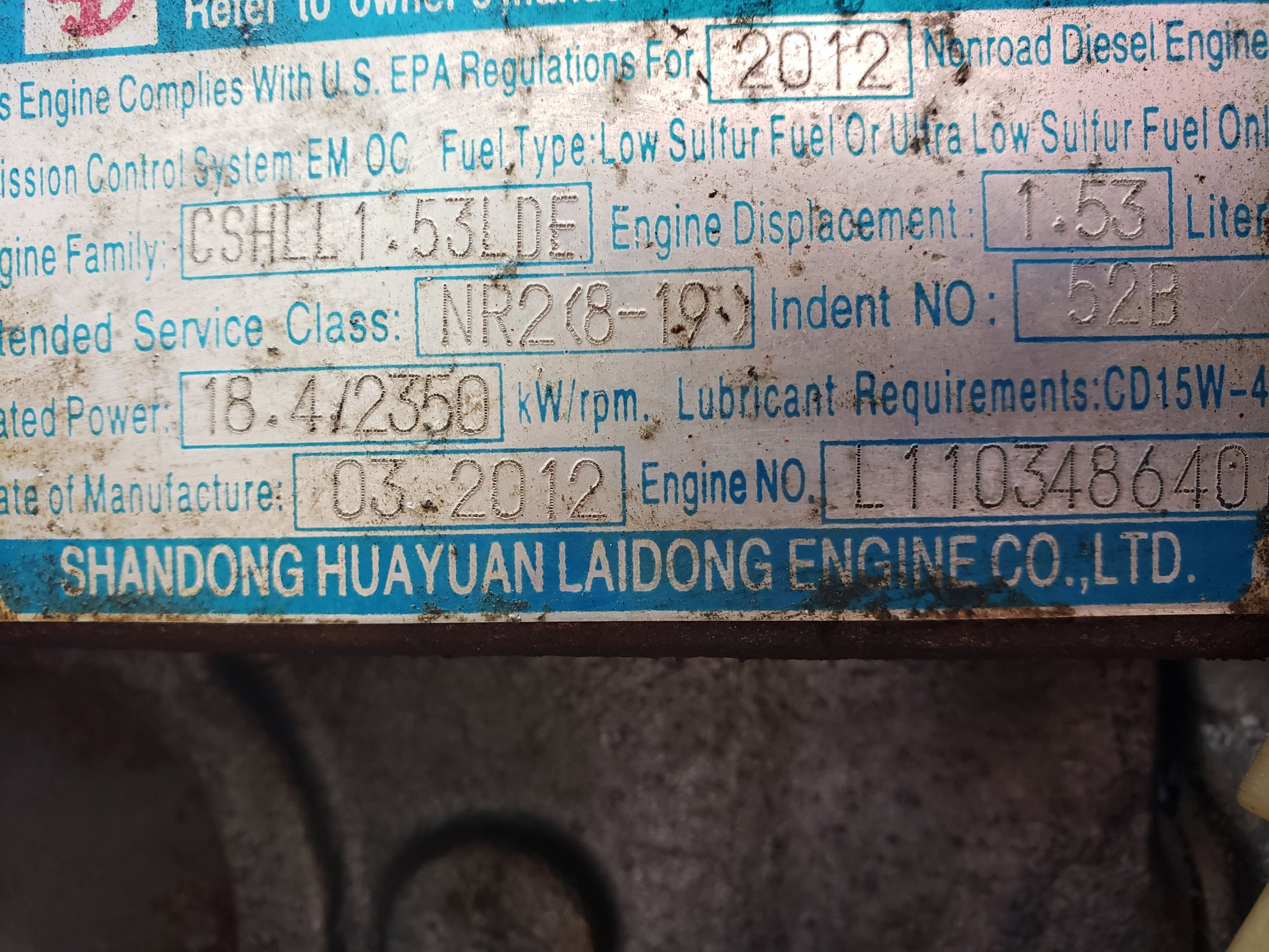

From the little bit I can see of the whole tractor it kinda reminds me of a YTO. They weren't sold for very long in the US at least. Should be a tag on it somewhere denoting the manufacturer. As far as it not lifting. AW32 should work, would probably go with AW46 down here but don't think that would cause much of an issue. Is the hitch otherwise still working without the brushhog attached?

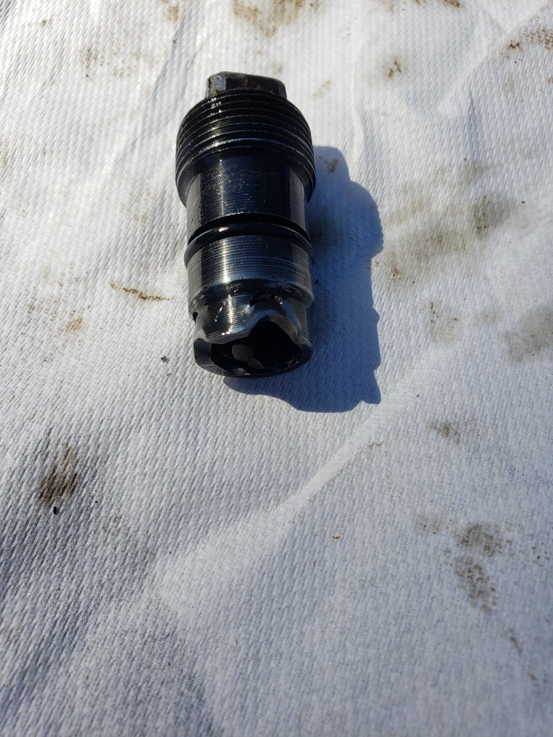

Hey everyone thanks for the links and advice, I managed to find the culprit and and at 100 hrs of comercial time on the machine now. It was the pressure relief valve, the cone under the spring was in sideways and had been torked down hard. After filing out the damage and re installing it correct it now lifts like no tomorrow, with the flow valve in full open I almost got whiplash from lifting the brush hog. So far it seems like a well built machine and has plenty of power, id say more then the ford 1700, it feels more like a 30-35 horsepower machine. It likes to pop wheelies in high gear so iv straped a water jug to the front as a temporary weight and filled the tires with water/ washer fluid. Below you can see where it collapsed and the cone part fit perfect in those indentaions.

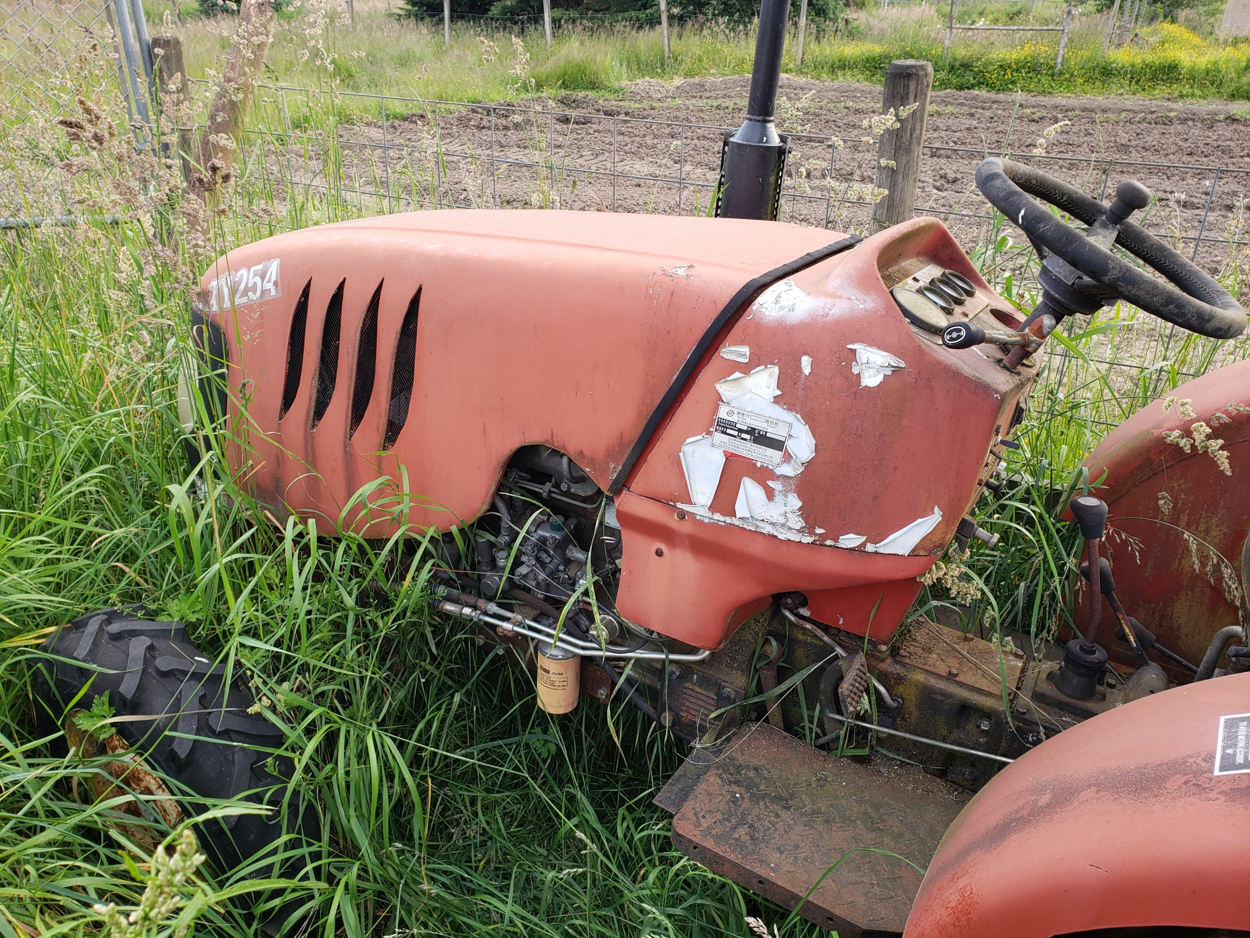

Also this is how I found it befor I brought it back to life

I believe it now to be a shandong tytan

Hey everyone thanks for the links and advice, I managed to find the culprit and and at 100 hrs of comercial time on the machine now. It was the pressure relief valve, the cone under the spring was in sideways and had been torked down hard. After filing out the damage and re installing it correct it now lifts like no tomorrow, with the flow valve in full open I almost got whiplash from lifting the brush hog. So far it seems like a well built machine and has plenty of power, id say more then the ford 1700, it feels more like a 30-35 horsepower machine. It likes to pop wheelies in high gear so iv straped a water jug to the front as a temporary weight and filled the tires with water/ washer fluid. Below you can see where it collapsed and the cone part fit perfect in those indentaions.View attachment 760105
Was this the pressure relief valve "in" the 3 point or in the distribution block? Thanks Dennis
