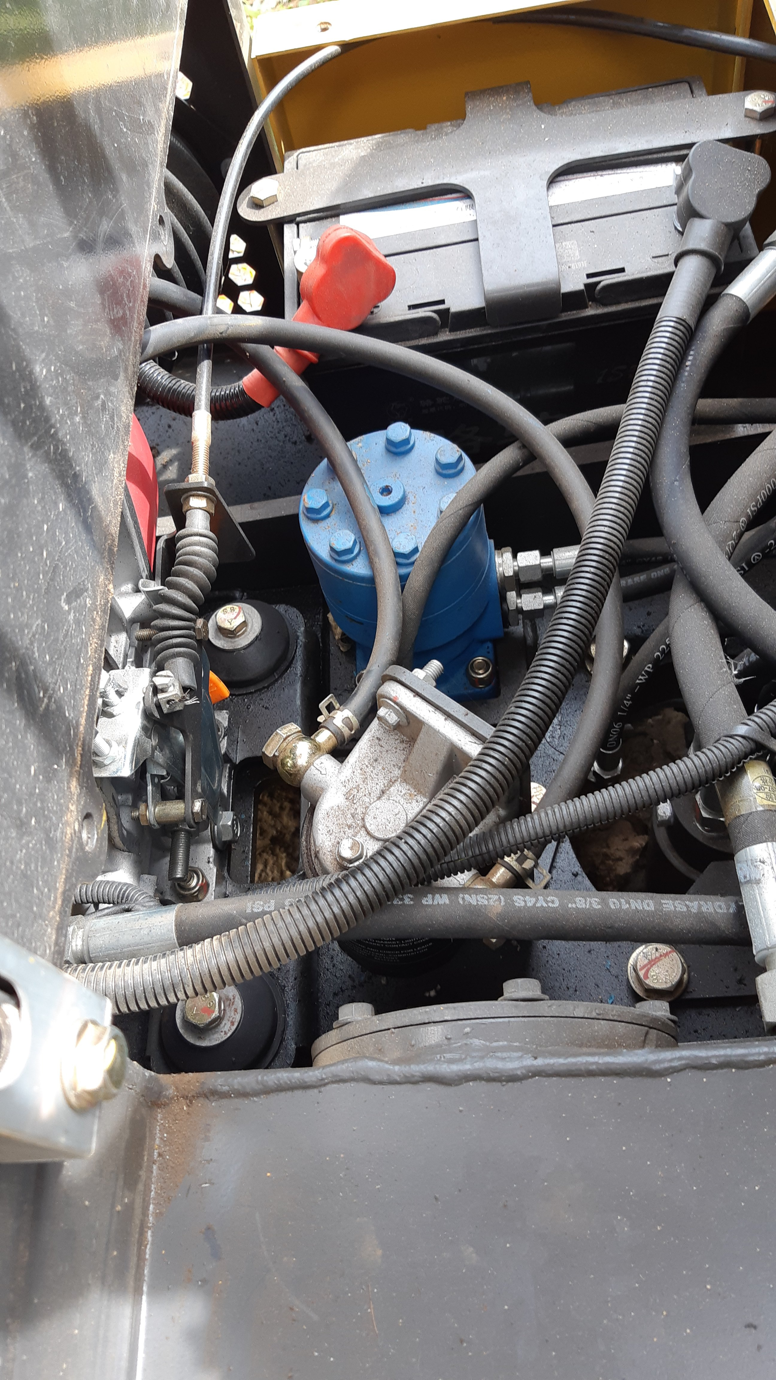

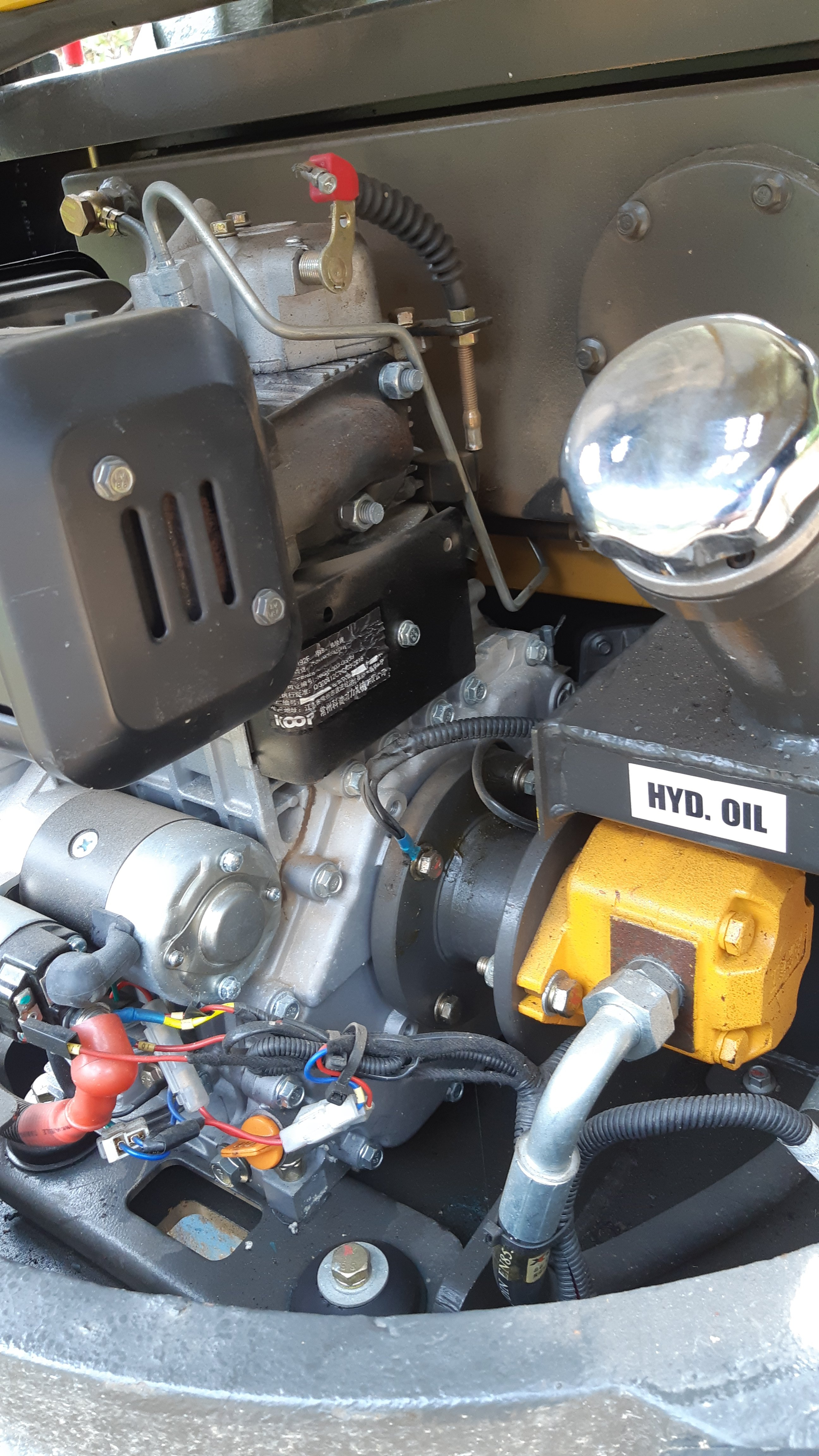

Hi everyone.
I bought this Chinese mini excavator, everything goes well.
I have now change the oil and filter; for the oil no problem but I cannot see where the oil filer is placed and what kind of filter.
Can Anyone help?
Thanks in advance.
V.

Looks like the oil filter may be under the starter.

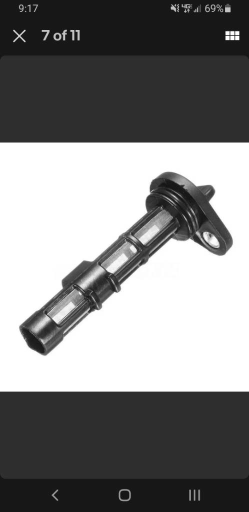

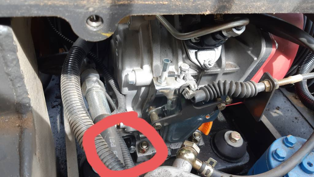

I've circled the filter, it is an internal screen. It is the black plastic piece retained by a bolt. The other picture is of what the filter screen looks like.

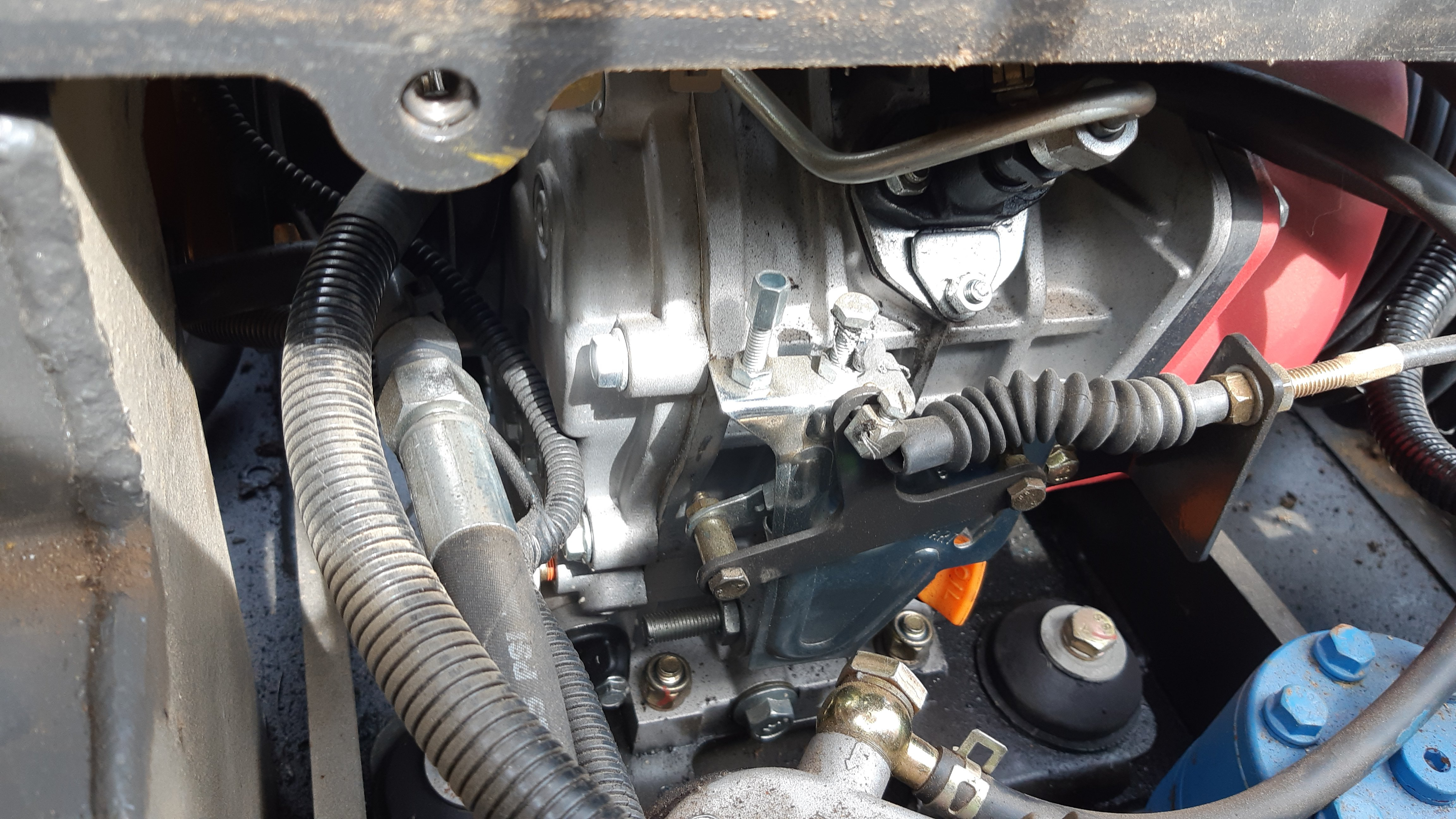

   / chinese ME1000 powered by kubota #7
Here's a better picture of the filter location.

Fantastic, I could never get there.
Beautifull, amazing.
Thank you so much.

All I could find was this expired ebay listing that the picture came from.
Unless it is damaged, you can probably clean the screen and reuse it.
