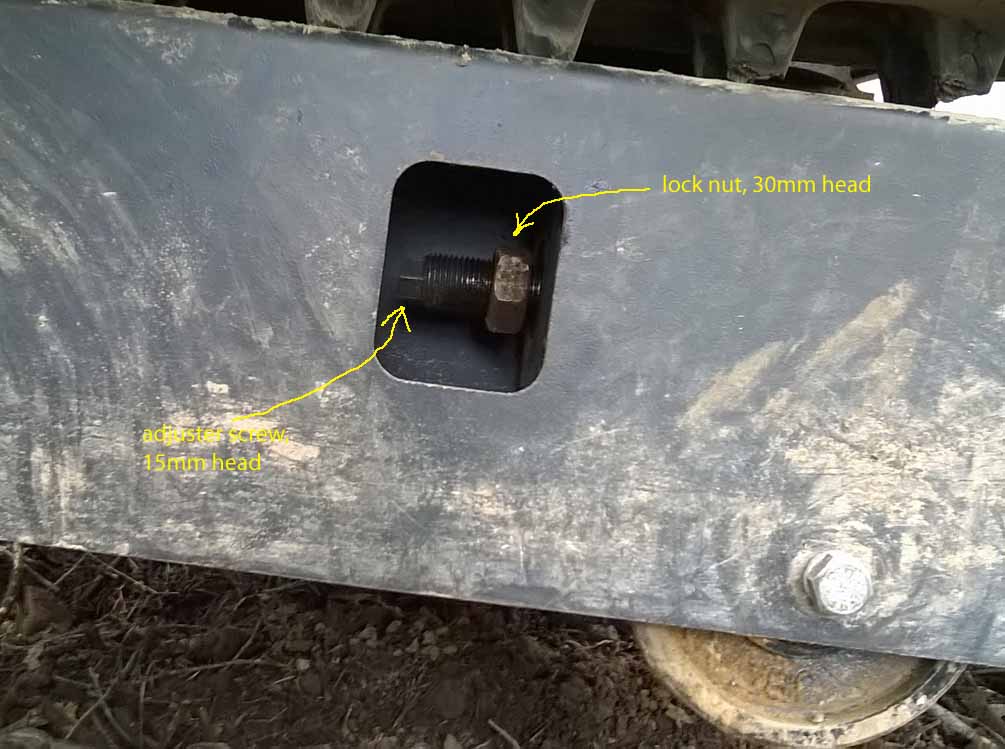

I knew it would happen eventually: I threw a track. By that I mean one of the tracks is displaced inward such that the idler wheel is outside of the guide lug pairs. This small machine features mechanical track tensioners, rather than the hydraulic tensioners you would normally see on a modern machine. I am a total noob when it comes to experience with ANY excavator (or skid steer) track tensioners.
It is hard to see the idler wheel in the first photo, but the track is almost touching the dozer boom. The track has been displaced inward by about an inch.
The 2nd photo shows the tensioner, but there is nothing in the docs about which direction you turn the bolt. (The answer I later find out is clockwise is more tension.)

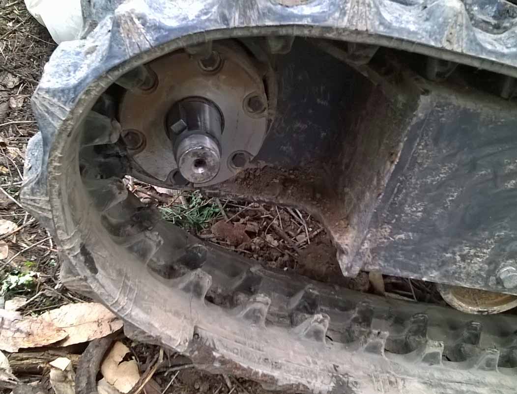

So, after some head-scratching, this is what I did: I removed the drive sprocket nut and sprocket. Not easy, as the minimum tension on the track is still quite significant. I had to use a 3-foot Gorilla bar to force it off the tapered shaft. This caused the threads in the hard shaft to marr the machined hole in the sprocket. It sure would be easier if the tensioner mechanism removed all the tension!
So I had to carry it down to the workshop and clean up the hole with a die grinder. The sprocket seems to be some kind of ductile cast steel, and weighs about 21#. By the time I got it to my workshop, it seemed like 30 or 40#. You can see where the threads bit into the sprocket hole. No damage to the threads at all.

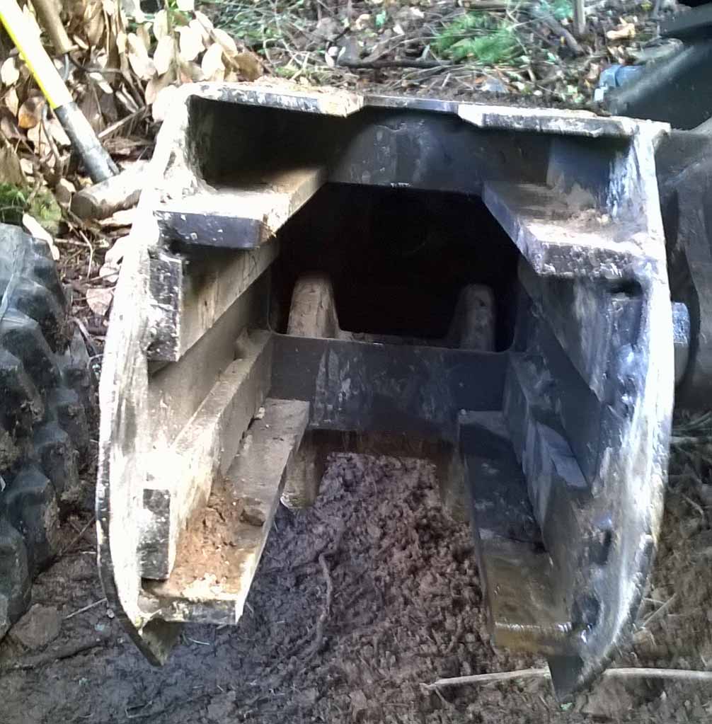

Here is what the idler looks like, and the hole it slides into.

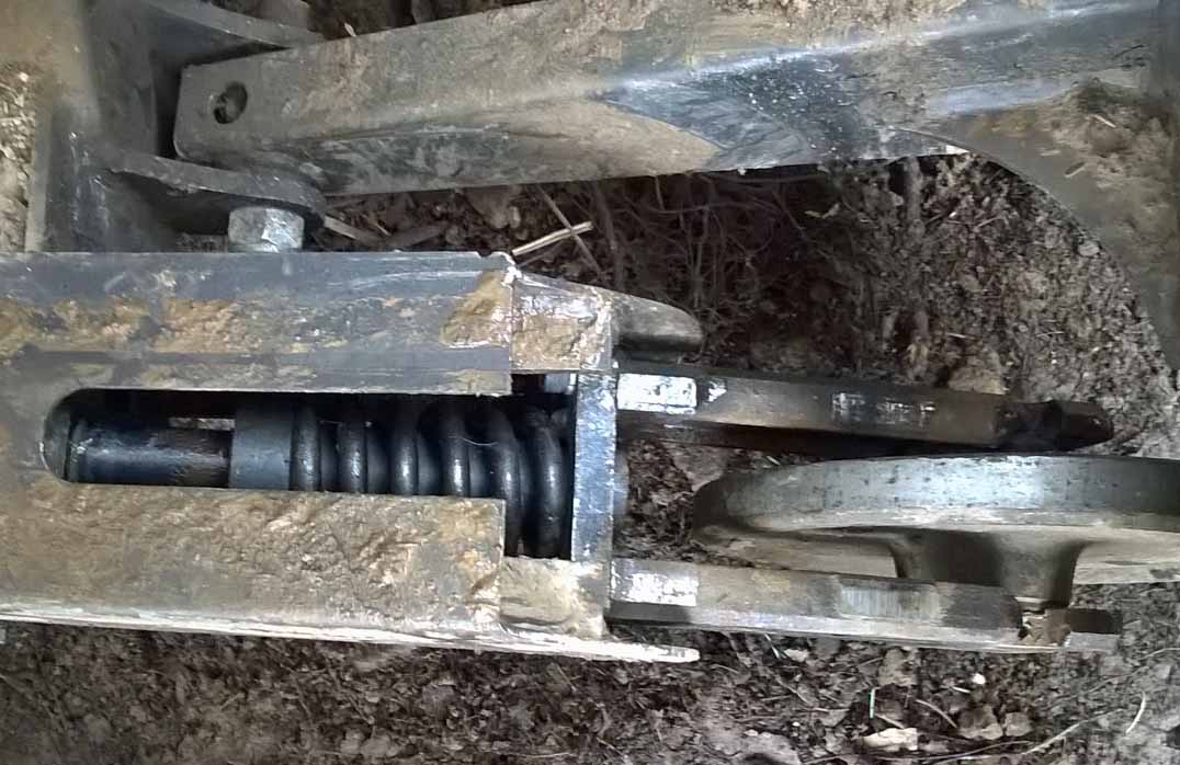

The adjuster mech seems to just preload the spring.

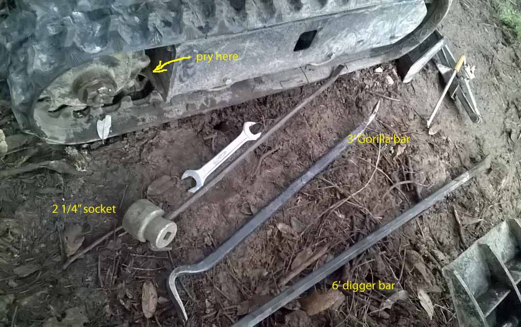

Finally, I had to reinstall the track...without any helpers.
These are the tools I used. I was barely able to get the sprocket started on the shaft, using both a 6' digger bar and my trusty 3-ft Gorilla bar. The nut pushed the sprocket on the final inch or so. Lining up the Woodruff key requires patience.
Questions for you excavator owners: does your track tensioner remove all the track tension? Does anyone have a mechanical tensioner mechanism?
