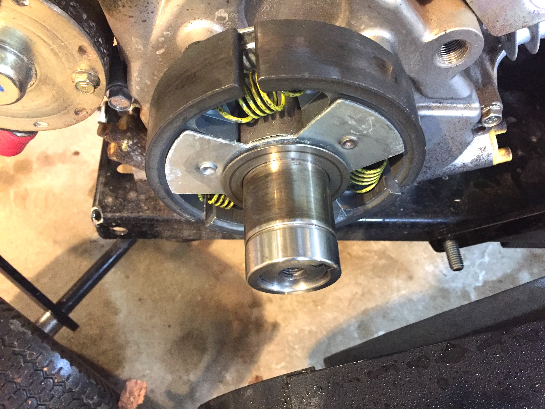

I have a MacKissic Mighty-Mac chipper/shredder that I bought new last year, used it about 3-4 hours so far.
It has a centrifugal clutch on the engine shaft to allow for easier no-load starting.
The last couple of times I used it, I noticed that as it slows down after I shut it off, there's a bit of noise coming from the engine area. Hard to describe, but sort of a rattling/groaning noise like you might get if you spun a mower wheel on a dry axle, if that makes any sense.

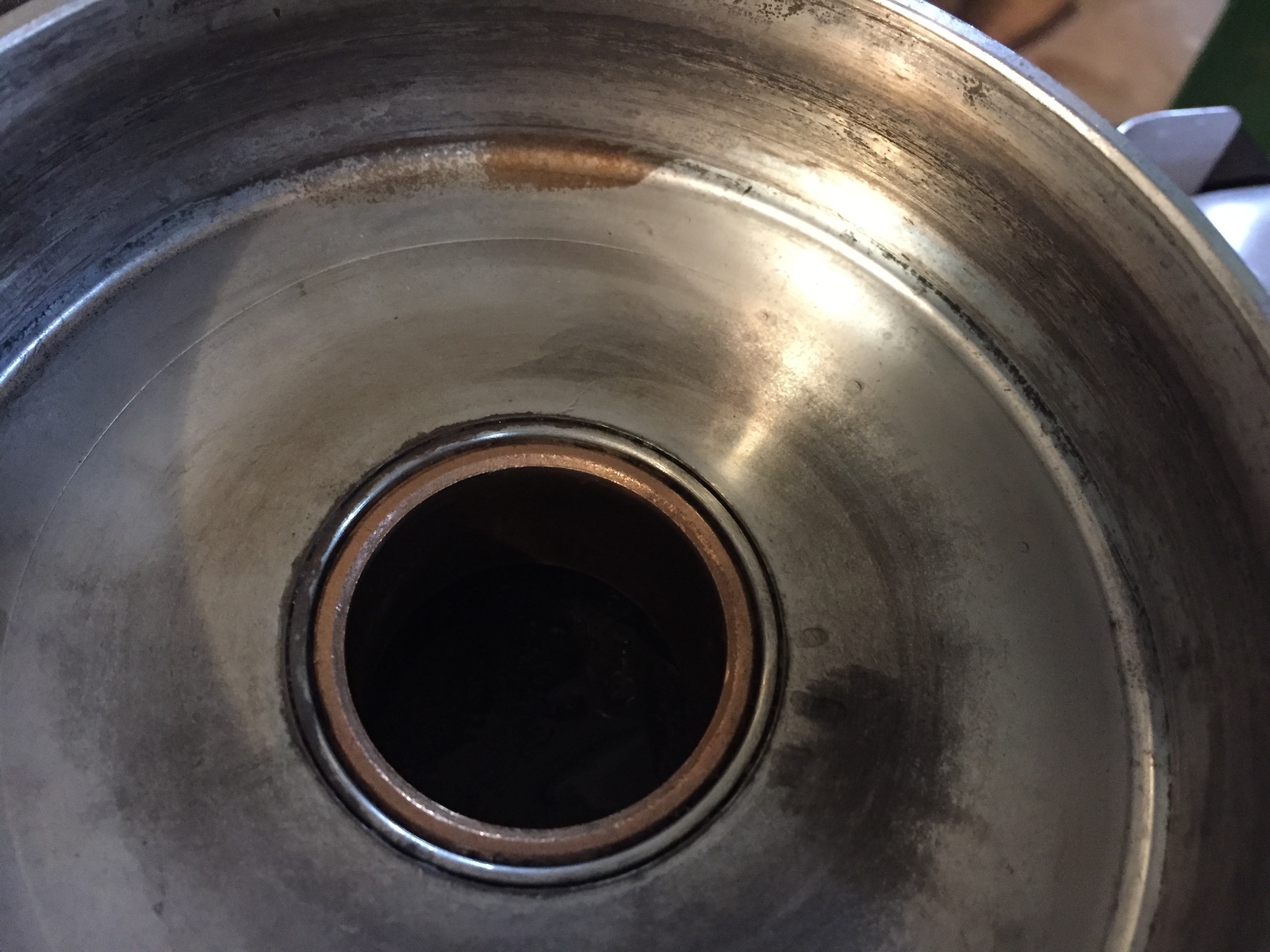

I took off the belt guard, & could see that there was dry black crud coming out around the shaft bushing area of the clutch. I took the clutch apart, & the inside was covered in the same stuff, sort of like dried out dirty grease. The clutch shoes were covered with it as well. It was clearly coming from the clutch shaft/bushing, as I could see tracks radiating from the center.
I cleaned it all up, and I'm not sure what to do about lubrication when I reassemble it. The clutch bushing appears to be an "Oilite" type bronze, which I'm used to putting a bit of oil on. Can someone correct me if I'm wrong?
And I'd doubt that the clutch shoes or outer housing should have any kind of grease or oil on them. Again, someone please correct me if I'm wrong.
This situation seems odd for something with so little use; I'm assuming that the clutch assembly was possibly over-lubed at the factory, but who knows.
I attached a couple of pics of the cleaned up parts.
Thanks for any comments/suggestions!

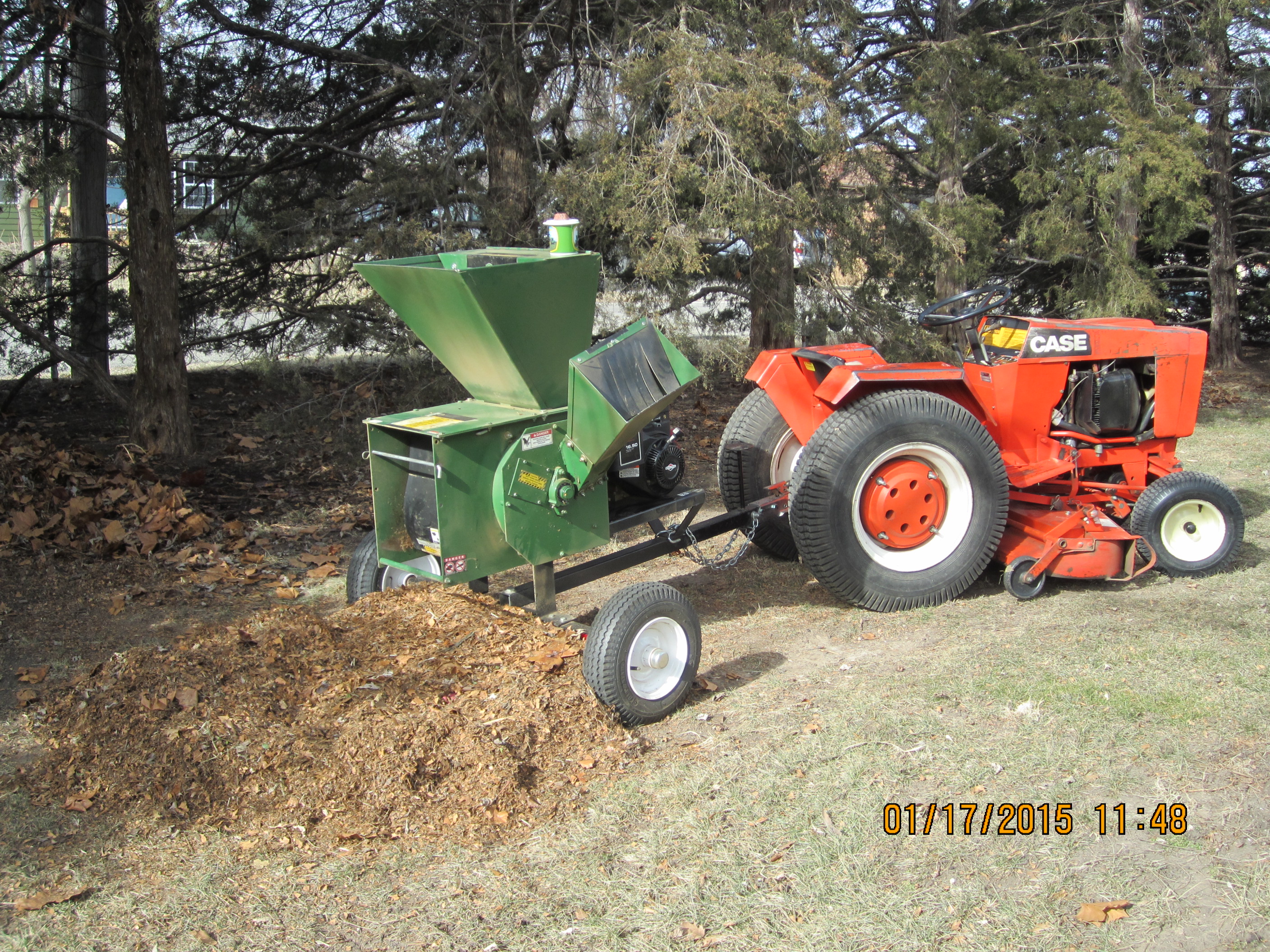

I've owned a towable Mighty Mac SC1650 chipper/shredder for over 10 years now. It probably has over 100 hours on it. The only problem I've ever had were operator errors. With just routine maintenance it still works just fine. As to your problem, I'd first call MacKissic (1-800-348-1117) (the last phone # I used). Their tech support was very good as I recall.
My guess is that your belt might have been too tight.

I put the clutch back together with just a little motor oil on the bronze bushing, & everything seems much smoother & quieter now. I didn't want to call MacKissic about this problem, as the machine is still under warranty, & I didn't know how they'd react to my disassembling part of it.

Think of it as a chain saw clutch. A pump of grease up the center "every once in a while". Grease, not oil.

@CalG: There's no grease fitting on the shaft or clutch hub, and no instructions in the manual regarding greasing the clutch. I did find some MacKissic instructions for an older model with a similar clutch that said to put a small amount of motor oil on the bronze clutch hub bushing before assembling, which is what I did.
Getting grease in the area of the clutch shoes & their friction surface just sounds ridiculous to me.
I do have a small chainsaw, and there's nothing in the manual about greasing its clutch either. :confused3:
