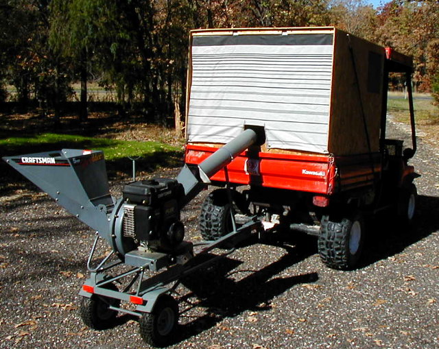

Betcha Asplundt never saw a rig like this./w3tcompact/icons/laugh.gif

Looks like I have a winter projcet in the works now..great idea /w3tcompact/icons/wink.gif
Do you think a wider wheel base would better on side hills or not.
Thomas..NH /w3tcompact/icons/wink.gif
   / Chipper/Shredder
<font color=blue>wider wheel base would better on side hills</font color=blue>
Probably would, and wouldn't be hard to do, but where we'll be using it, it's not a concern, and oddly enough, it's much more stable that it looks. But that was my first thought, too, when it was first completed.

Neil, as far as I know (someone may know better), you're right about Asplundt. I think they're a construction company, but best known for tree pruning and removal with those big orange rigs.
The one pictured actually belongs to my brother. That's just a little 5hp Briggs & Stratton powered Sears (Craftsman) chipper/shredder, mounted on a customized dolly (the kind used for moving heavy appliances - this one's laid down instead of standing upright). Did you notice the reflectors for taillights?/w3tcompact/icons/laugh.gif Of course, the discharge chute had to be custom made, too. And the Kawasaki Mule has a power dump bed, so we built a box on it and made a miniature version of what Asplundt uses./w3tcompact/icons/laugh.gif
It's great for making compost out of leaves and small limbs and twigs.

Nice setup. Does it realy through the chips in the bed? I have a chipper just like that, and I was going to put a hitch on it for moving it around, but if that would work........ Hmmmmmm...............
