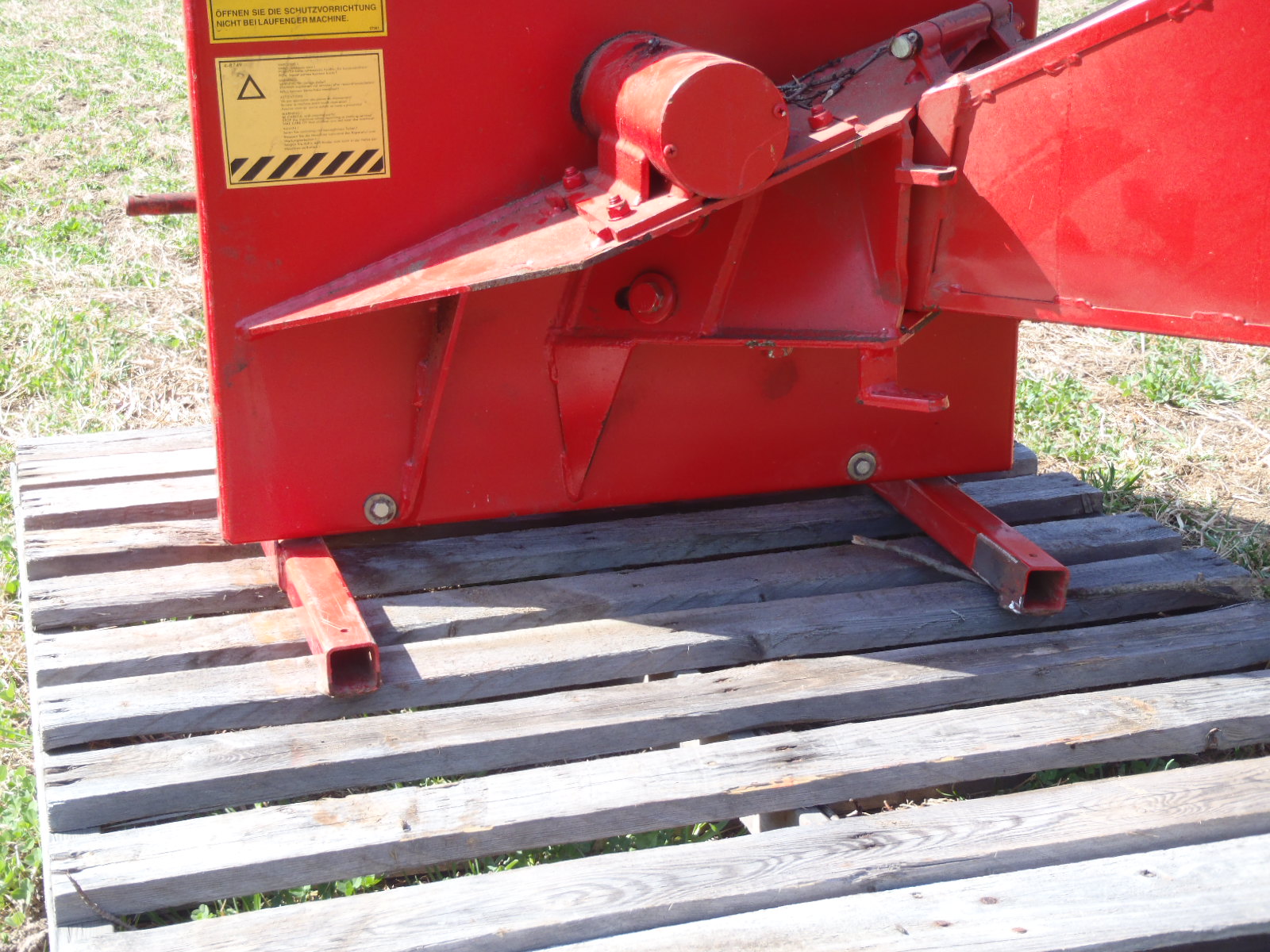

Thought I could weld a draw bar between the feet of my chipper:
Added 1 7/8" ball with handle on nut for quick removal as the thread would get messed up if I rest the chipper on it. Also, I need to remove the ball so I can swing the back open to get at the blades:

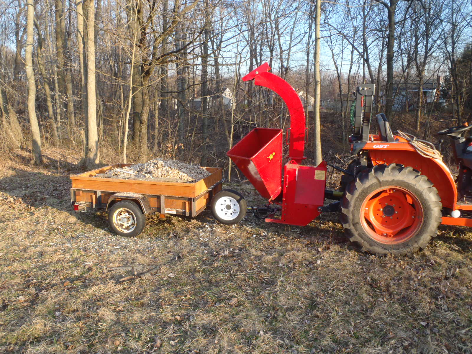

All hitched up:
Ready to head for the blueberry patch with a full load:

Very Clever!

Yea, Been thinking about doing this. Now I know it's possible :)

Very nice job!!!
