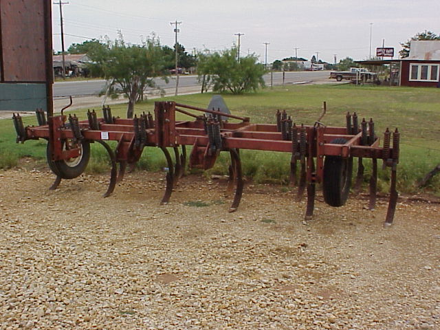

I had a neighbor give me a 7' 3 pt chisel plow. It has 7 shanks. With my 47 HP, loaded tires, and a bucket full of dirt I can not pull it at a depth of greater than 3 inches or so. I have power, but run out of traction. From what I understand they are typically run at depths of 8 inches. I was going to remove some shanks and see if I can pull it better, but I was just wondering if there was a certain HP recomended for a certain number of shanks. Just guessing by the way it loads up my tractor I am guessing I will only be able to pull 3-4 shanks. I am sure it all depends on soil type but I was wondering if this seems right.

I removed two shanks for a total of 5 on the plow. It did better than with 7 on there but I still had difficulty pulling it. There is no way I could get it going 5mph unless I was running it really shallow.
I tried pulling it with and without a bucket full of dirt. It seemed to do better with the dirt as I was in 4wd and the front tires were getting better traction. My rear tires have 240lbs of liquid in them each. My tractor weighs around 5,500 lb with the loader and the filled tires. I did some experimenting with different gears and rpms and I definitely run out of traction before power. I acheive maximum hp at 2600rpm. I can be at around 1800 rpm, and spin the tires and never bog down the engine.
I guess I need more weight. I find it strange because in purchasing my tractor I specifically chose the Branson because it was the heaviest per HP that I saw.
Right now with 5 shanks they barely cover my tire tracks. I would remove more but I don't really want a 3' plow. I mainly was going to use this to break up the hard ground before I ran over it with the tiller.
Attached is a picture of a chisel plow. It is not the one I have, but similar. It is like a cultivator, but it shanks are heavier, and it has chisel points instead of sweeps.
