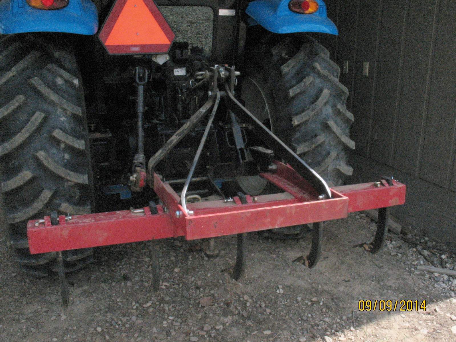

IMG_1644.jpgIMG_1643.jpgI have a thread on rippers that I bought for $300 and they do a fantastic job of ripping up the soil and vegetation. They can go twice as deep as you can get the box blade rippers to go due to having the box blade on the back and limited to how short you can make the top link. The best you can get is about halve the length of the ripper. With this one you can go up to the beam if you have the power and no springs like the Fred Cain field cultivator which allows the plows to roll back like in the video, you could see the top of the chisel tooth so about 4" deep is all it was going. Of course with many passes you can eventually get it to go deeper.
   / Chisel Plow #6
One other thing, these are built for a Cat I tractor but I have them on my Cat II LS P7010 and have stalled it traction wise with this ripper and not bent of broken anything so they are well built and the price wont break the bank.
