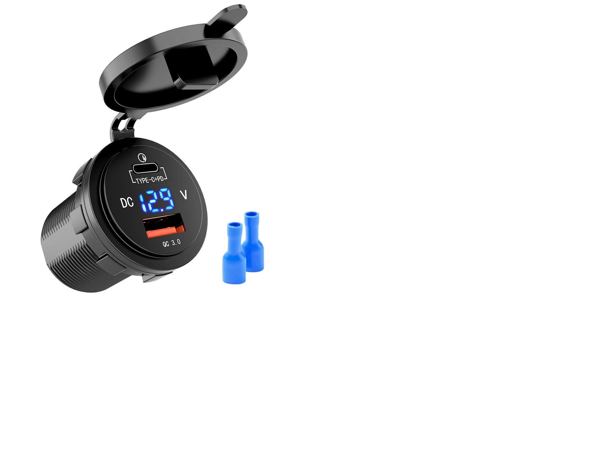

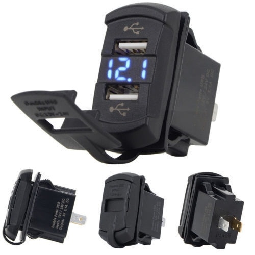

I have installed USB charge ports on all my equipment including tractors, backhoe, dozer and a John Deere Gator. Tractors have cabs but Dozer is open as well as Gator. The charge ports I installed have covers for the USB outlets so they are pretty protected from the weather - haven't has any problem with them on the dozer and Gator. I purchased
2 different types on eBay - approx $12 each and free delivery. The one style requres drilling a hole - the other will fit in an existing rocker switch opening if you happen to have a blank switch cover with no switch in it. They also have a voltmeter that shows the vehicle battery voltage.

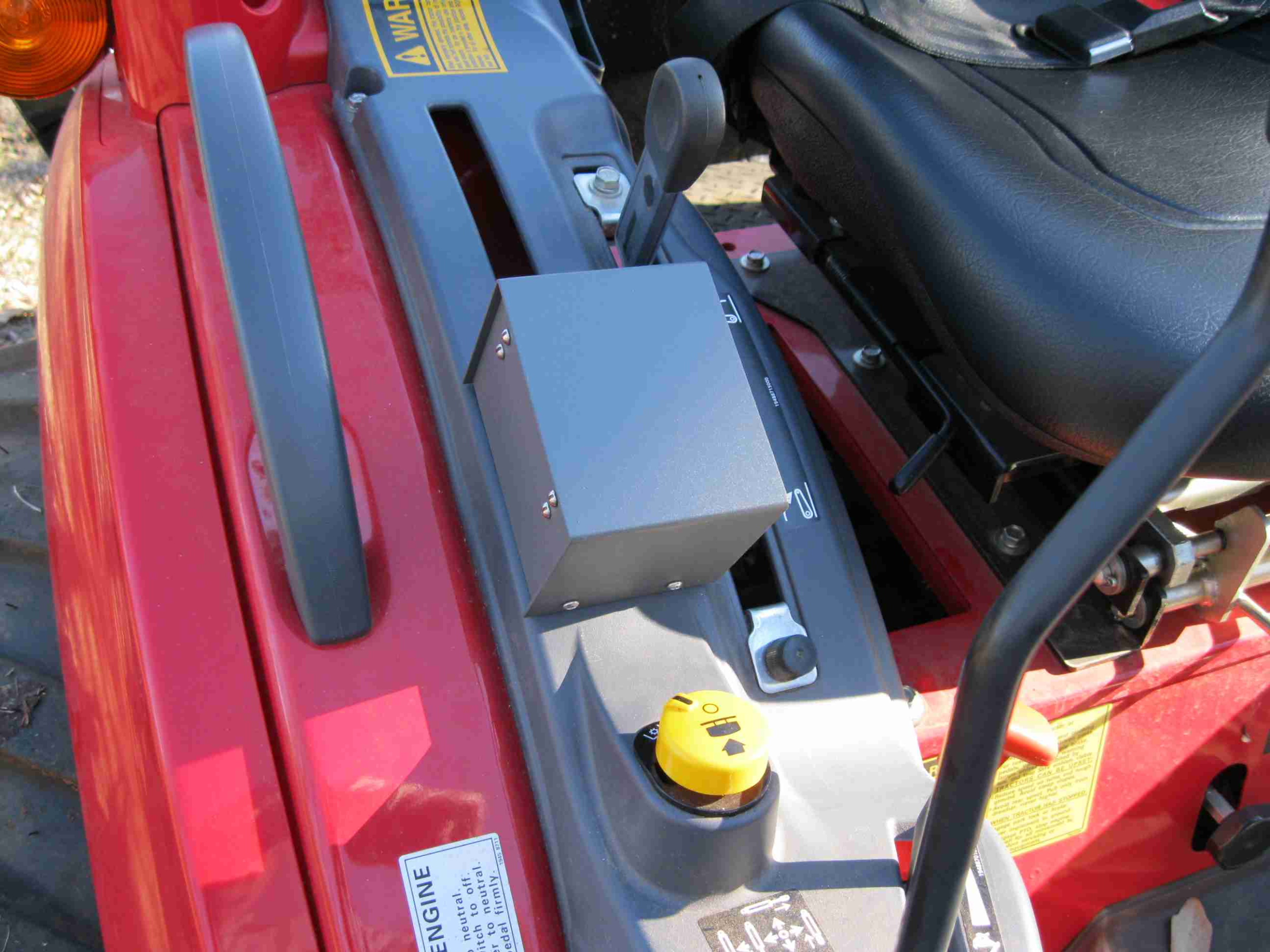

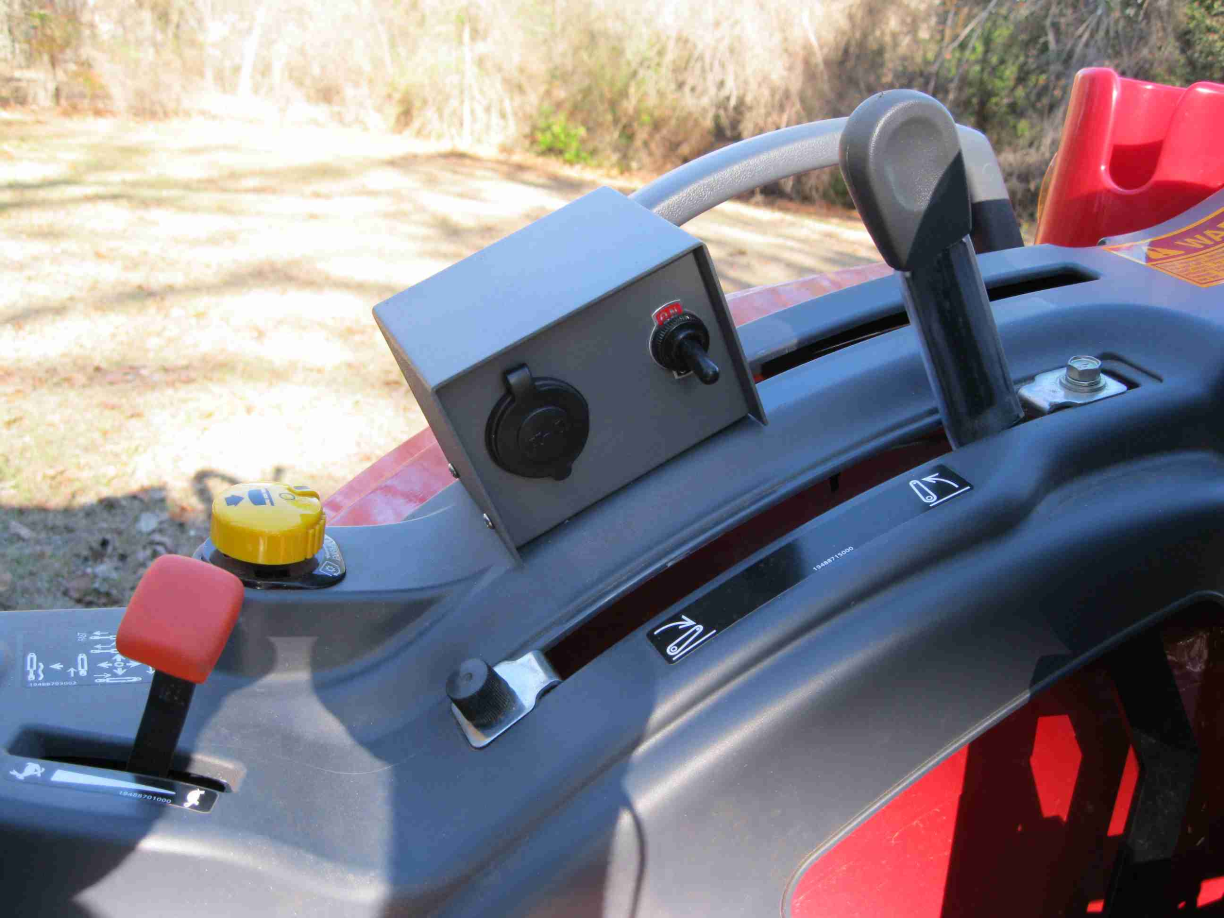

Here's my solution for the lack of a 12-volt outlet on my tractor.
The adjustable stop in the adjacent control slot provided the mounting inspiration for this addition - It mounts with two clamps (nuts, bolts and washers) through two holes in the bottom of the enclosure. (No tractor drilling required.)
I formed the enclosure using 0.060 aluminum and painted it with some textured paint that matched the color well.
Because I have a backhoe and no 3-point attachments, control lever interference wasn't a concern.
The toggle switch allows on/off operation without having to plug/unplug a cord. Using a lighter socket seemed to be more universal than USB from my perspective and better for my intended uses.
I ran 12 gauge wire to the battery and fused the red (hot) lead at that point with a 15 amp ATO (blade) fuse. Experience has taught me to never overlook the fuse!
The extra red wire from the lighter socket terminal to the terminal strip is for future use.
