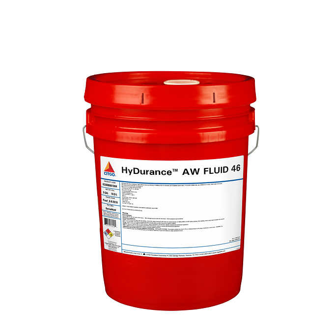

Among my next projects for the 1973 JD 820 are to replace the hydraulic screen (not sure if it's metal or nylon!) and replace the hydraulic fluid.
What are all yawls opinions about this stuff from Costco @ ~$50/ 5 Gal? JD Hy-Gard is selling at ~$75/ 5 Gal.
Thanks Again!
Joe
https://www.costcobusinessdelivery.com/wcsstore/CostcoUSBDCatalogAssetStore/pdf/1293638.pdf

Does you tractor have wet brakes the hyd oil you posted does not say anything about wet brakes....So IDK... I would get Mobilfluid 424........:2cents:

Apparently wet brakes.
   / Citgo HyDurance AW 46 in 1973 JD 820 #4
AW oils lack the proper additives for machines with wet brakes and clutch packs. Your 820 has wet brakes.
   / Citgo HyDurance AW 46 in 1973 JD 820 #5
Ditto hyd oil needs to contain additives for wet brakes. '73 JD 820 has no wet clutches
   / Citgo HyDurance AW 46 in 1973 JD 820 #7
You're correct nobody stated 820 had wet clutch BUT you mentioned additives in oil for wet clutch packs. 3 cyl 820 doesn't have wet clutch packs either
   / Citgo HyDurance AW 46 in 1973 JD 820 #8
Let me be more specific. AW oils are not appropriate for any machine with a wet clutch, wet brakes or both.
#9
Great! Thanks. Any suggested alternatives to JD Hy-Gard, or should I suck it up and spend the extra for JD brand?
   / Citgo HyDurance AW 46 in 1973 JD 820 #10
Mobilfluid 424, TSC Traveller Premium Universal Tractor Trans/Hydrauilic Fluid ,Shell Rotella HD Tractor Transmission and Hydraulic Fluid..
